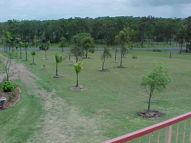

I have approx 100m of driveway (300'). It is in bad condition and I have been patching it by hand and with some fill I have on my block using a bobcat (hired) (I don't have a FEL - shame !)
There are all sorts of things I can do with the driveway but the interface between the drive and the lawn puzzles me.
Short of concrete kerbing or something, I have rocks and dirt etc. on the lawn when I mow.
The drive is uphill so scours out a lot when it rains. The last time I got 2 speedhumps put in with dirt and they help.
Any recommendations as to the driveway and especially the edge treatment?

Neil, my driveway goes down hill, amd then back up again. I put a crown on it, using limestone roadbase packed down as good as I could get it. Water then drains to the sides rather than running down the drive. In my case I had to cut ditches on the sides to handle the water.
It worked good until drainage ditches on the main road clogged, and caused a small river to flow on to a neighbors land, and ended up hitting my drive from the side. I had a couple of gullies running across it. /w3tcompact/icons/frown.gif
Looking at your picture, I don't think that would be a problem for you. As far as the curb, I don't think you would need it, unless you wanted it for looks. When A house is brick or rock, I like to see a curb that matches the house, but it can be expensive/w3tcompact/icons/wink.gif/w3tcompact/icons/smile.gif

I would pull some shallow ditches on the edges of the driveway and put a little crown in the driveway, using a rear blade with tilt capabilities, in order to manage the water. I would then use post-emergent herbicides, such as Roundup, to define the border between driveway and lawn, and, ultimately pre-emergants, such as Surflan or Trifluralin (Preen). That's what works for me here in California. Cheers-

Yes I thought that might be the go. Since the speed bumps were installed, the gully on the down side of the drive has become more eroded, but still out of control, so maybe I need to define it more before it scours away more of the drive or the grass.
I don't mind the brick idea, much cheaper than concrete and gives me something to round-up to. Just the labout to lay 600' of bricks worries me.
This arvo I am going to try using my ripper to lay some brick edging around a garden, and maybe if it isn't too hard I could have a go at the drive.
I figure just rip a shallow trench and drop the bricks in and scrape dirt up to them.
I know I need a rear blade. Just have to convince the finance officer.
