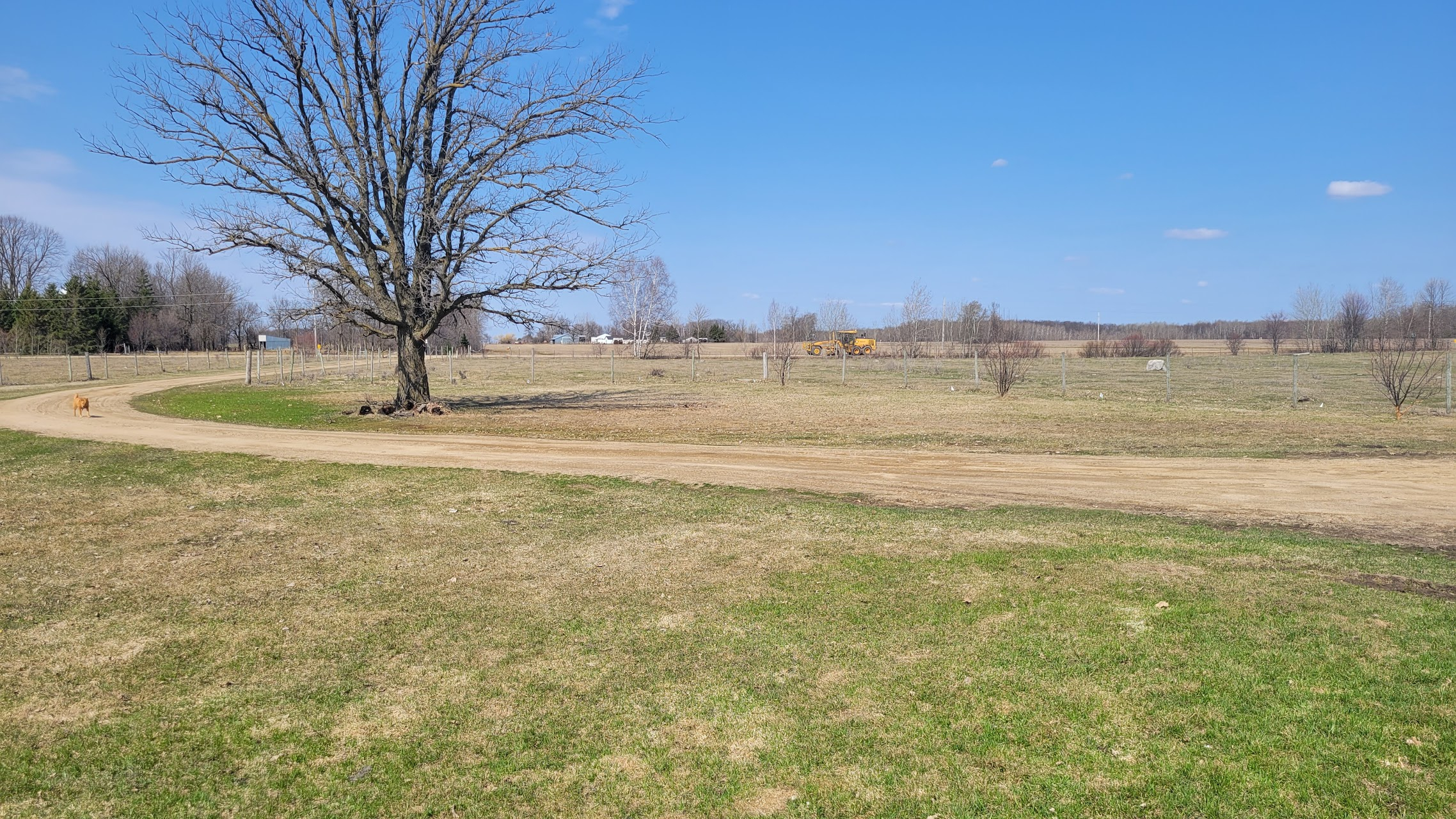

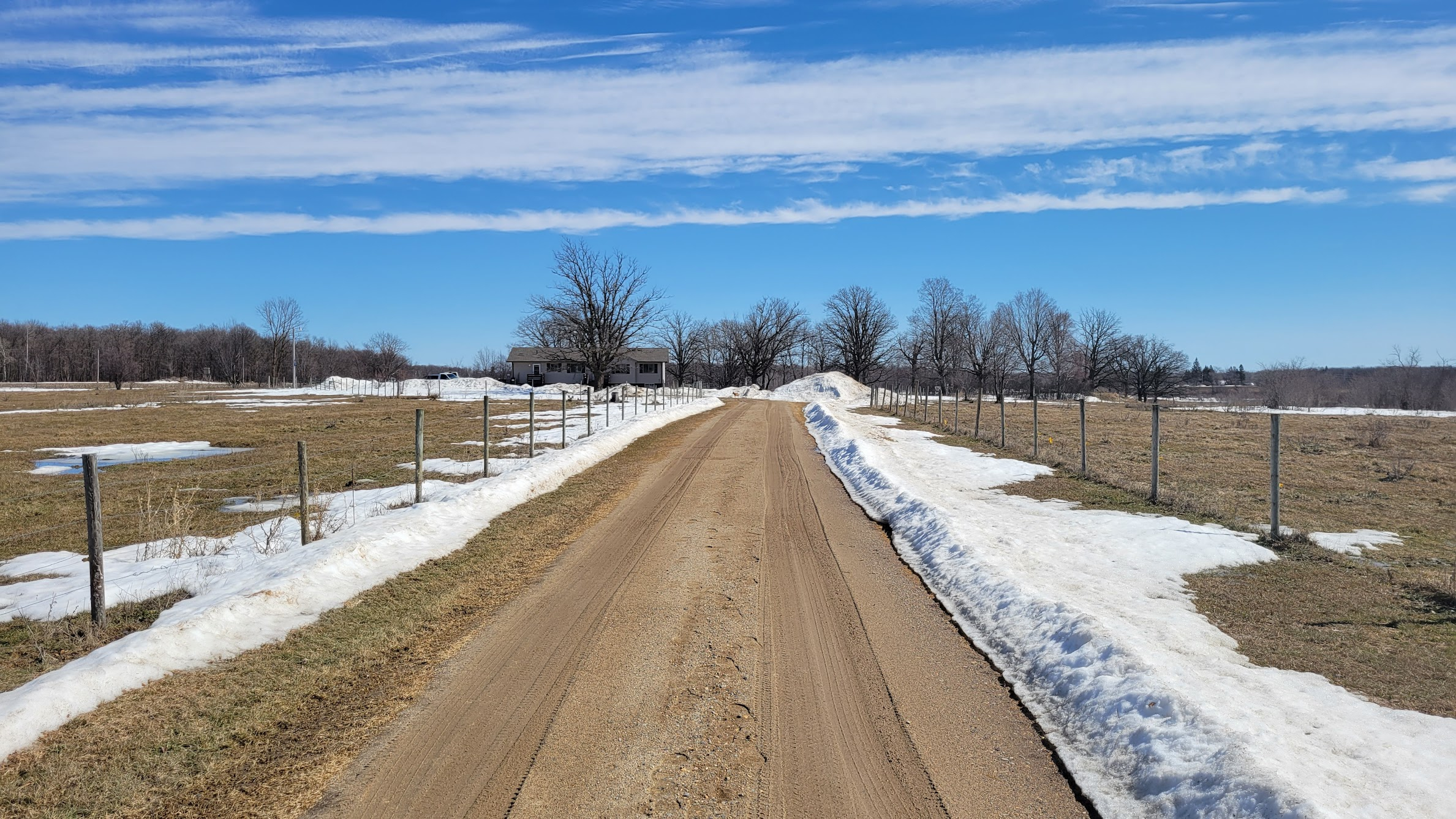

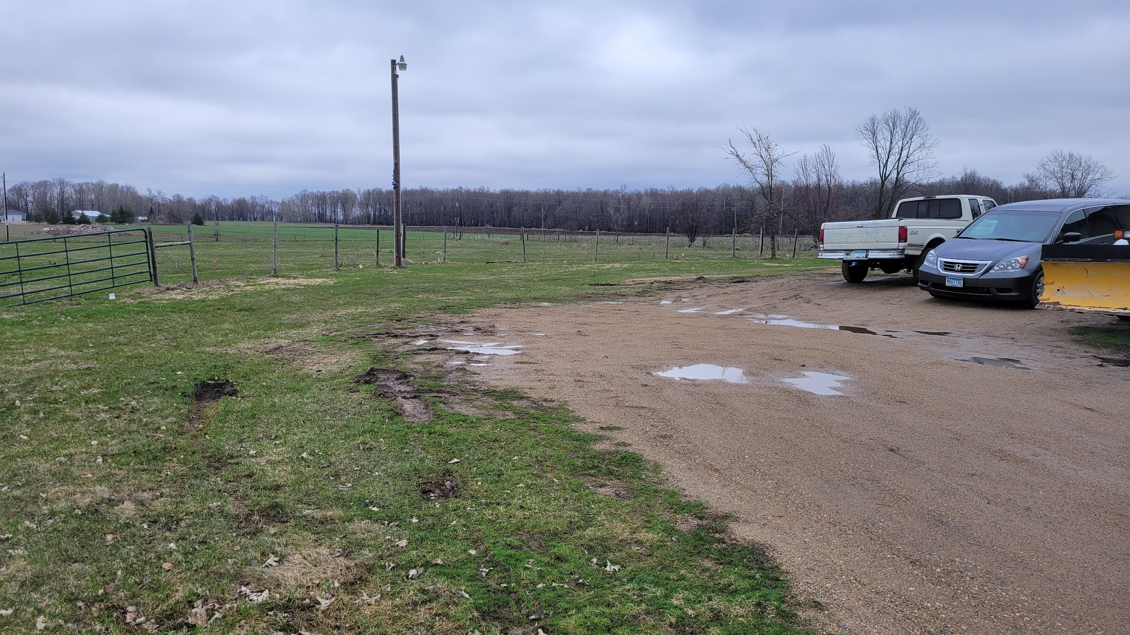

I am looking to expand my turnaround and do some general driveway repair.
I first need to know what tool would be best suited for helping expand the turnaround. Is it possible to use your loader bucket to scrape the topsoil like people do with skid loaders? otherwise should I get a box blade and use that to scrape the soil away? In regards to expansion I'm assuming its fine to simply scrape the soil away from the edge of the existing turnaround and just start building, or do people normally tear up their existing area in order ensure the extension merges in better?
I am very inexperienced with gravel driveways as this is my first, I don't really even know what the current driveway/turnaround is made of, it seems very sandy. I was planning on getting a box blade, then the more I read about maintaining a driveway a LPGS seems like a better choice long term. But if I need the box blade to help expand the turnaround then I guess I have to go that route. I've attached photos of the driveway when its dry, wet, the material, and the current state of the turnaround.
Let me know what you think I should do, I've done some research on driveway construction and it seems (correct me if wrong) that you want to remove at least 6 inches of dirt and build up with layers of larger to smaller rocks, with maybe 1 layer of fabric.

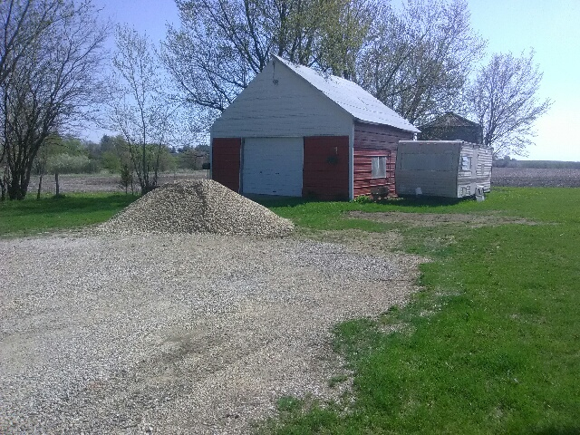

I'm doing something similar. I'm extending the gravel up to the garage, out of picture frame to the right. I JUST had this stone delivered, like 45 mins ago... I asked him for some expert advice. No need for underlayment fabric for this (overkill he said), just spray/kill the grass and use a box blade to pull up 4-5" or so of earth near the door area, then spread the stone with the loader. This may not be enuff stone though.
Good luck, how much stone is that? too late now but I'm thinking ill try and get the dirt ripped up before i have the rock delivered, maybe the trucker bros will help me spread it with their gate.
I won't get the invoice for a few days (mailed separately). I've had several truckloads of dirt and stone delivered here in the last few years. This was a 6x truck, probably ~ 17-20 tons. ? The quarry charges by the ton, and it doesn't go as far as you'd think.. That's why it's hard for us to calculate this stuff. Your long drive will probably need several loads, every 2-3 years, depending on soil type and traffic. The good drivers will be able to do a decent "tailgate drop", to help spread it out. Fun, eh?

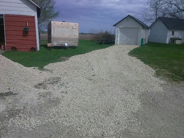

I spread this out today. Didn't use it all. Still need to level it with my land plane (homemade). No injuries and any tractor seat time is always good....
