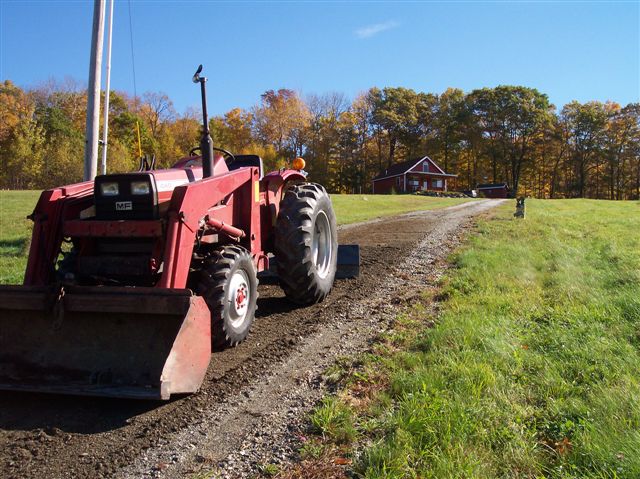

I put my driveway in much the same as you, but I tried some stuff out of Wallingford,Vt two years ago on the top third of my driveway. Its called surepack and looks off white and packs down great, like concrete. I will try and attach a photo, but I think Im too far down the driveway for you to see it.
