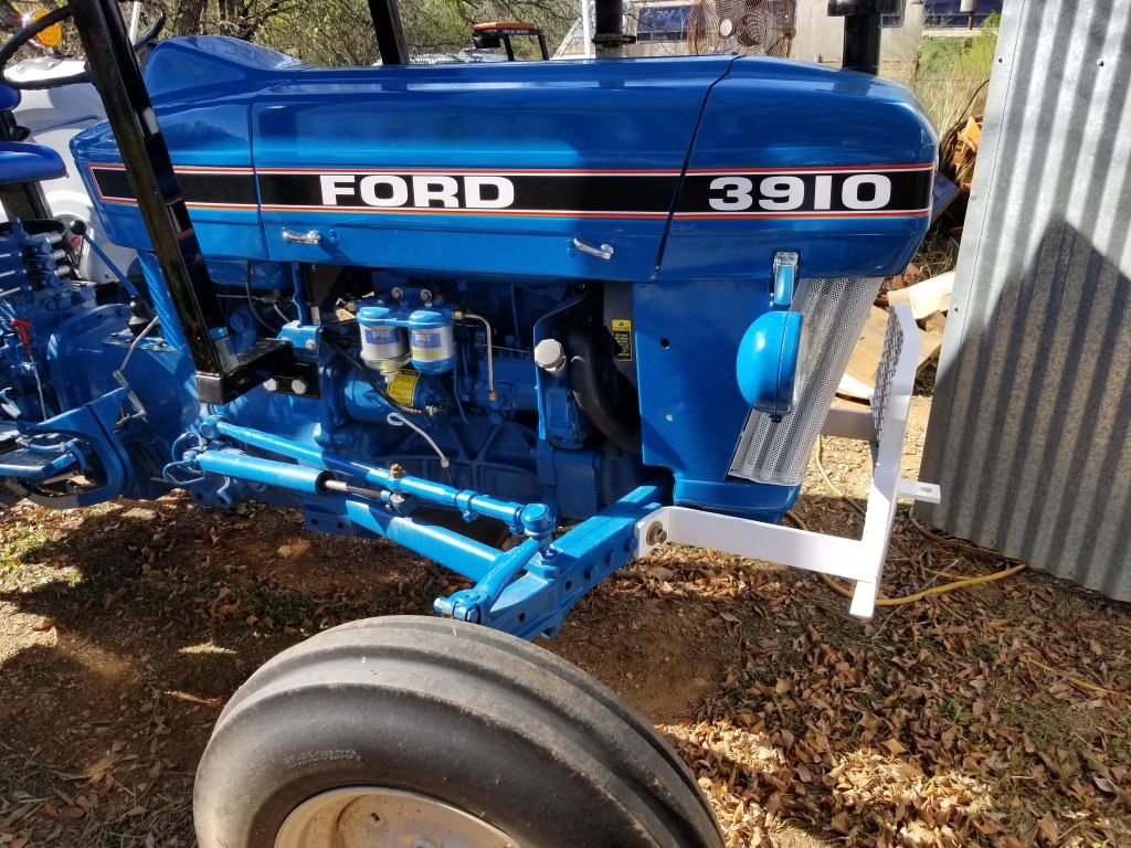

It WAS the same on my 3910. I added a dual filter setup with the water drain on the first bowl. I've yet to drain any water out of it in the past two years.
