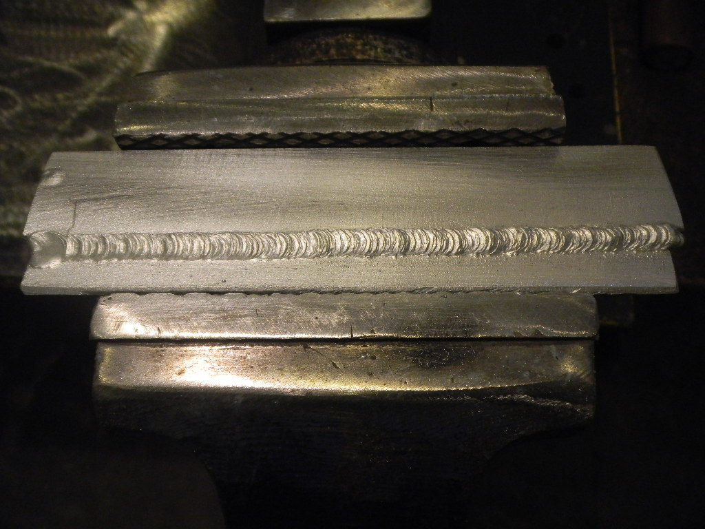

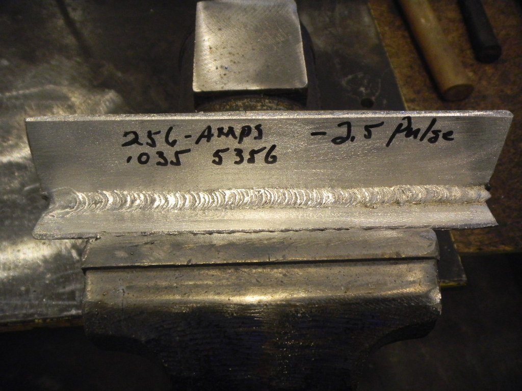

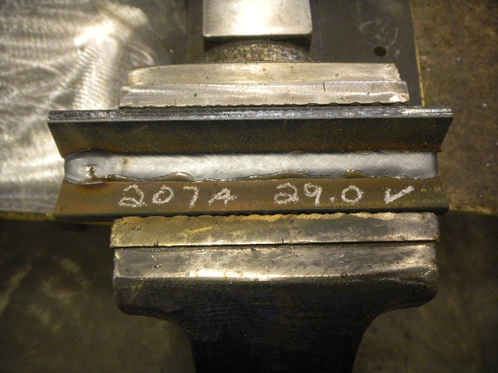

Here are some pictures of spray, and pulsed welding on aluminum I did when I first got my V350-Pro. The ripples you see on the aluminum welds are the pulse, I just held the spool gun in one position and traveled forward.

   / Dual Shield Welding: Flux Core with Gas (Videos) #8
Shield Arc-
Your welds always seem to look better than mine, but nothing has fallen apart over the years, so I guess ugly is OK sometimes too. I started off in the 70s with a Marquette 250 AC unit (I think the largest thing they made at the time). It was a bit aggravating to use the old AC units, but had a 160A/100% duty cycle, so I could weld continuously the best I could with 7018AC rods.
I have been using a pair of Miller XMT-300 welders for SMAW for the last 10 years, and want to get into MIG welding. I have always wanted to get into welding aluminum. I had assumed that I would have to learn TIG to do it, but it seems that people do OK with MIG.
The Everlast I-MIG 250p looks like a pretty nice unit and good value as far as I can tell. But the pulse part of it (it is single pulse, not P on P) is not obvious. I guess I will just need to spend an hour or two playing with it on aluminum, and of course it will depend on the aluminum alloy as to exact parameters.
Thanks for your input!
Tom

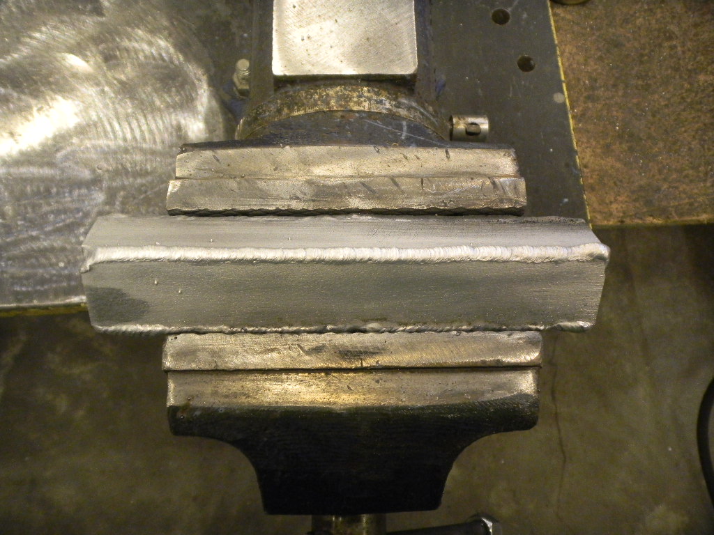

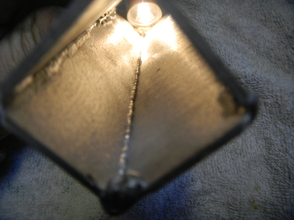

I'm not much of an aluminum weldor, here is a corner joint I did on some 16-GA with my spool gun and the V350-Pro.

That looks fine to me, no holes or inclusions, good penetration. I hope to do that after a few days of working with aluminum also. What alloy was that you were using? My only experience was to try welding some with a ESAB MIG unit, using MD extruded aluminum from a large ACE Hardware store, and it was the sootiest stuff I have ever seen, but the welds turned out ok. Not quite as smooth as your square stock, but somewhat close.
Thanks for the input!
