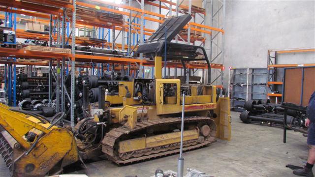

And I give myself a huge kick in the arse every day for selling my RC100:mur:
/ Dumb ASV Question #12
tonyoz I learned a long time ago there are only two kinds of people; those who are 'gathers' and those who are 'distributors'.
While I only have mainly junk equipment today (all I need since I just 'play' with it) I do not part with it even when perhaps I should. I know I am a 'gather' so I just do not price stuff.
That RC100 looked like it was a neat size machine. Not huge but enough size/power keep from always wishing for more on every job. I miss an ASV30 with a regular bucket, grapple and shears attachments for $7500 with 431 hours but never did get to eyeball it so it may or may not have been a deal but I was concerned with the 800 pound load limit I would be pushing the limits to often plus I really just wanted it more than I needed it. :D
