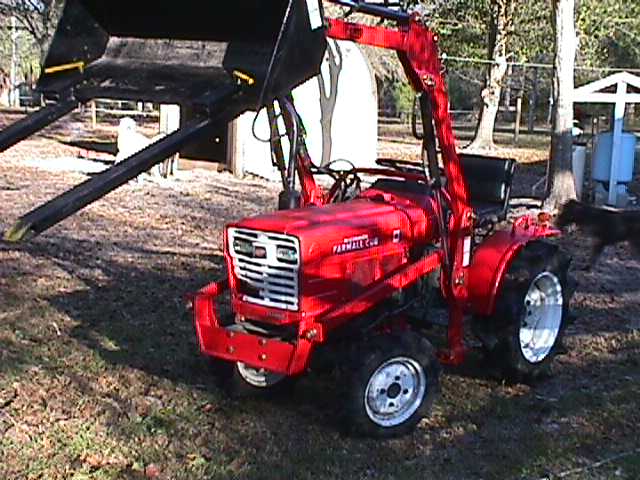

I'd like to fill the rear tires on my loader-equipped YM 1510D with liquid. There MUST be a way to do this other than through the valve stems! How is it done?

Through the valve stems /forums/images/graemlins/blush.gif
   / Dumb question? #4
You buy a special adapter at most farm/tractor supply places that allows the air to vent as the liquid goes in. Requires a garden hose and something to push the liquid through the hose (a hydrant works in warm climates where plain water won't freeze).
