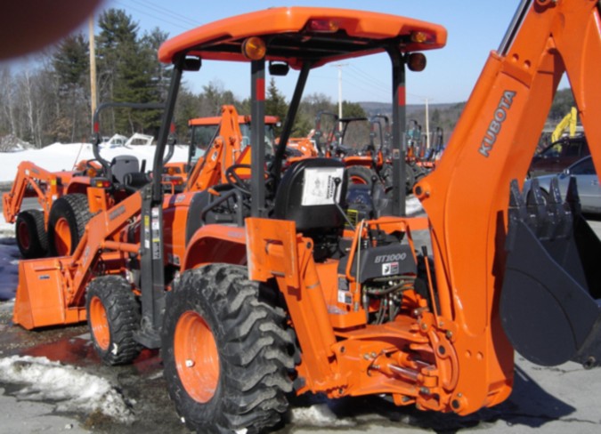

I'm not getting much feedback on this question....A viable solution here is going to be hard to find with a big hoe hanging off the back. Maybe I can have a plate with a ball welded to the upper part of the hoe bucket , or at the lower point of the boom. When the bucket is curled up there is some room between the bottom of the bucket and the lowest point of the boom (pic). I'd hate to go welding a bunch of scrap on that new hoe, but maybe it wouldn't be too bad.

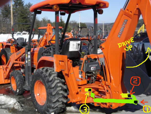

Maybe this picture will help -
Image you welded two receivers onto the main backhoe frame - one on each side - point '3' in yellow - you could then make a "U" shaped piece that would span around the lower part of the backhoe arm - at the bottom of the U ( point '1')you could have another receiver with a Pintle type trailer hitch. Using a pintle would allow you to easily attach and detach the trailer as you needed to. By making the U shaped piece span around the bottom of the backhoe arm you are making all the forces of towing the trailer go directly to the main backhoe frame and from there into the tractor frame. By using a receiver at each end of the U - point '3' - you can take the frame off relatively quickly to use the backhoe and put it back in quickly to pull the trailer . You might have to drive with the outer part of the bachoe arm extended up but I think this is better than putting the towing forces into the backhoe arm.
The only other way I could think of doing it would be to weld a receiver directly onto the lower part of the backhoe arm - see point '2' - and make sure you have the locking arms down whenever you are towing the trailer. This again puts some towing foces into the backhoe assembly and not directly to the frame however.
I quickly hacked this in Photoshop just to try and put a picture on the idea.

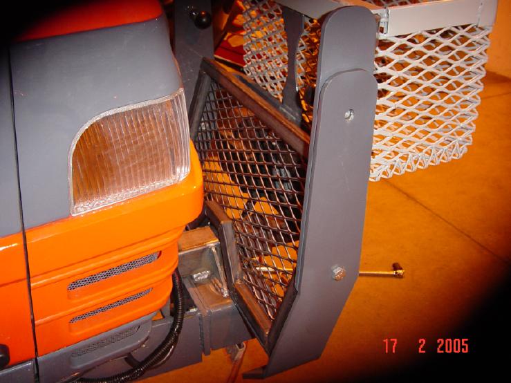

weld one to the front of the tractor
