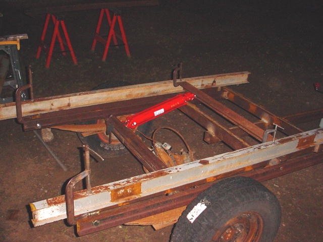

I am in the process of building my very own dump trailer. Of cource this was inspired by all here on TBN who have taken the time to post their dump trailer projects.
My question is - at about what angle would you or did you use? and was it sufficient for complete dumping?
I am at a point where I can set the cylinders to get just about any angle up to about 90* (straight up & down). However, I don't know if this is wise or not. I would rather make the angle just enough for a reliable complete dump. Just in case it matters, I will be using it primarly for moving dirt around the property so I want all of it to dump out without farting around with a shovel to clean it out. It will be ~ 4' x 8' and hold about 2 yards ~ two tons.
Here is a picture of what I have so far. I will post more details after the project is complete so that the post does not linger on & on. As this is not an urgent project.

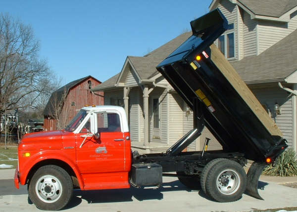

You only need enough angle to get the material to slide out of the bed. The dump trucks that I've have had go up to between 45 and 50 degrees. If the dump bed raises to high it can make the vehicle/trailer very unstable.

The angle of repose for loose granular material is about 30* so you need to exceed that to be sure the bed empties. If it were me I would work toward a 45* dump angle.

Looks to me like your cylinder will stall with a heavy load. What diameter is it? I think you should use a bigger diameter or two cylinders. It's no fun when your dump won't dump.
I have two homemade dump trailers that haul 3-4 yards of dirt each. One of them has a 7x10 bed with two 2.5" diameter by 14" cylinders and it will stall if the load is too far to the front. The other wagon has an 8x8 bed with one 4" diameter by 24" cylinder and it never stalls.
Go for a steep dump angle with lots of lifting capacity at the initial lift. The geometry is everything.
