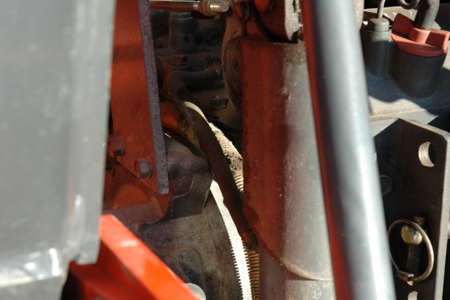

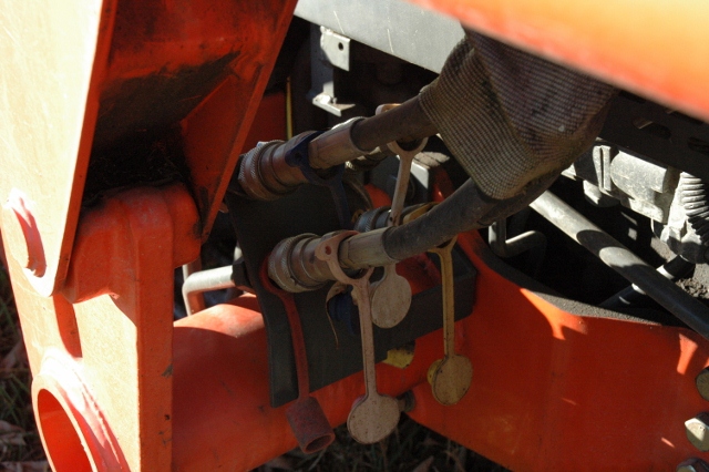

   / Dump Trailer Control Valve and New Rear Remotes Question
Can you describe your hydraulic flow? so pump -> ... -> ... -> tank
Well aside from the rear QC loop for the BH (see attached photos), everything else is stock. Not sure how else to describe it
So for the FEL: pump -> FEL -> tank
And for the rear QC: Pump -> QC -> Tank
Well, I never heard of QC's attached at the 3pt, and i've worked on big and small tractors, but I think he meant one pair of RC's.
How is your 3pt valve feeded?
Right. No rear RCs and therein is at least part of my motivation. As you can see in the attached pic there are two smaller lines coming from an outlet on each side of the transfer case above the PTO. It doesn't seem I would do anything with those lines and just reroute the QC to the new valve and use the existing QC on the PB off of that.
I am now ****-bent ordering the service manual so I can at least refer to this stuff with the "proper terms".Any tips on reliable sources of service manuals besides my dealer who is a rip-off?
Thanks again for all your help.

   / Dump Trailer Control Valve and New Rear Remotes Question #7
I dont think I understand you right, so maybe you can answer this:
FEL valve = feeded from the pump
back CQ (for BH) = feeded from the PB of the fel valve
3pt = feeded from the QC (loop) on the back
is this right? if it isn't please correct.
I'm sorry, but I life in Holland so I cant help you with that.
Wilco.
