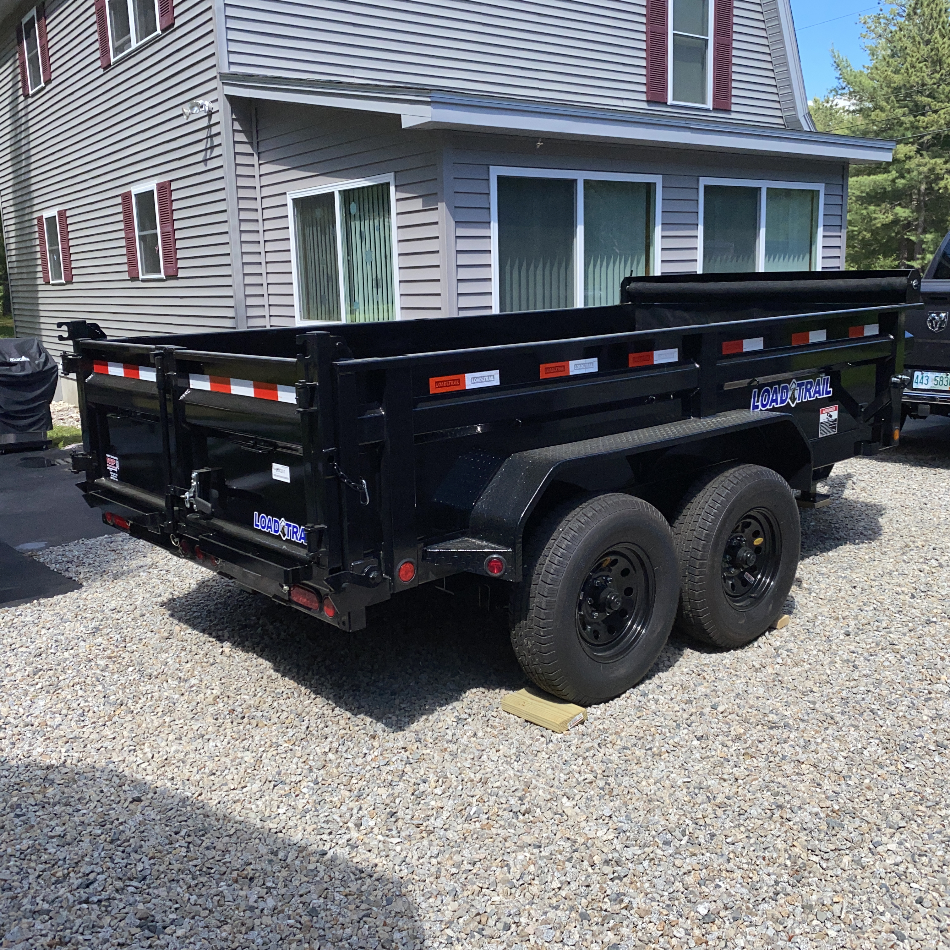

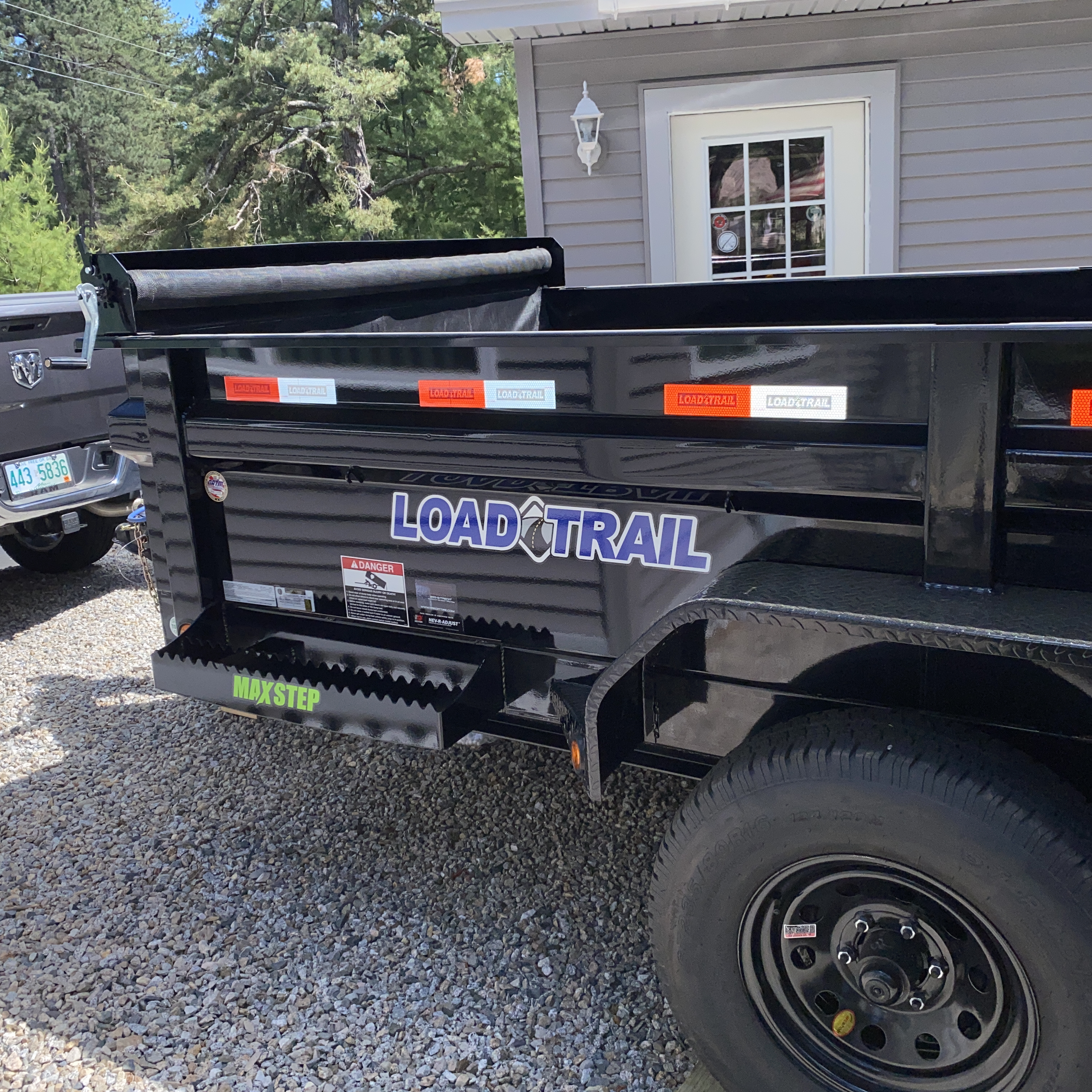

I just picked up this one - it's a 10K 6X12 - 10ga floor and sides - I wouldn't want anything less to haul compacts - I went with the 10K to stay under cdl and use with my ½ ton - it's just homeowner so more than enough - some trailers were tough to get due to factory shut downs - but are starting to show up.
