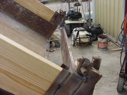

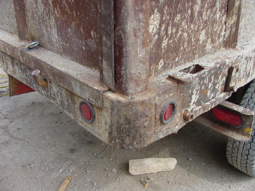

One of the many considerations in building the trailer was the tailgate. On a demolition trailer it's best to have the fold back tailgates. The downside of fold backs is invariably someone will forget to secure them and they'll get destroyed when the bed is dumped.
A fold down tailgate doesn't work worth a flip if the load is aggregate and it's against the tailgate. The best one for that situation is the one you see on trucks with the top pivot.
Here's a shot of the tailgate latch mechanism in the closed position. Note the handle on the right and bent in holding the tailgate closed.
   / Dump trailer my way
#2

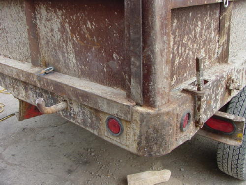

Now look at them in the open position.
Underneath is a rod that runs from side to side with offset tierod ends picking up the tailgate retainers. It doesn't matter how much weight is against the tailgate. It releases with just a flick of the handle.

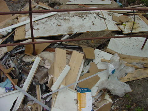

Under this pile of trash is the tailgate.

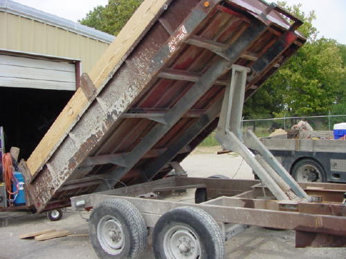

Here's a shot of the trailer in the dump position and tailgate open.

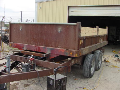

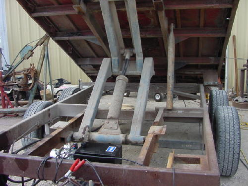

dumped view
bed down view

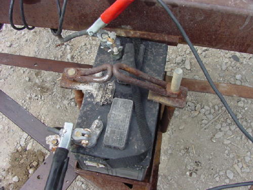

Look close. This is my battery security system. One padlock and it's rather difficult to run off with the powerizer.
