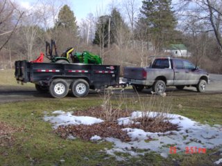

I have a JD 4110 w/FEL, BH, tiller, BB, landscape rake...I haul it on a 14ft dump trailer (PJ Trailers). With FEL and BH the tractor is almost 16ft long.The tractor w/FEL & BB, BH or tiller fits in the trailer & the rear door completely closed. With the BH mounted, I have to swing the boom about 45' once the tractor is on the trailer, this way the bucket swings into the corner thereby decreasing the length of the whole unit so the rear door shuts.
I will say this set-up is a compromise. If my primary use was as an equipment hauler it would be a downright PITA. Once the tractor is loaded it's a tight fit to move around in the trailer to get the chains and straps secured - seems I'm always banging an elbow or knee on something. In the summer/fall I may haul the tractor locally 1-2x/week, but I use the dump trailer almost daily; haul mulch, fill, building materials...I'm in the process of gutting/renovating a 2 family, I've hauled 7 huge loads of debris to the transfer station for less than the cost of 1 dumpster rental. Nice.
Not a very good photo of the set-up, tiller on tractor.

I own a PJ 14" dump trailer, they are nice, I would never think of hauling any size tractor on it. Buy an equipment trailer, you will be glad you did.

I think you should decide what your primary need is and buy for that. I own a 14K # dump that I use to deliver firewood and other things around the farm. If or when I need to haul my tractor to a shop, I will rent an equipment trailer. While weight would not be a problem with my trailer, fitting the tractor and especially tie-downs would be more of a pain. I was afraid that if I tried to buy for both uses, it would be a compromise for my primary use. I've owned my tractor for almost five years and never had the need to haul it anywhere.
