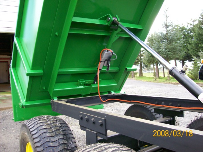

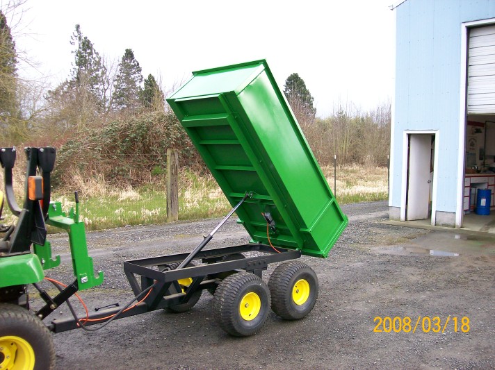

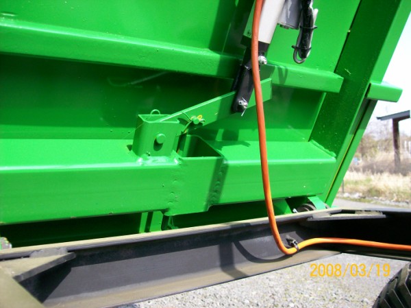

I built me a dump trailer - cylinder fed from tractor hydraulics, tailgate latch operated by a 12 volt linear actuator, fed by a toggle switch on the dash. 100_0093 (712 x 533).jpg

Looks real fine !!! I like It
   / dump trailer #3

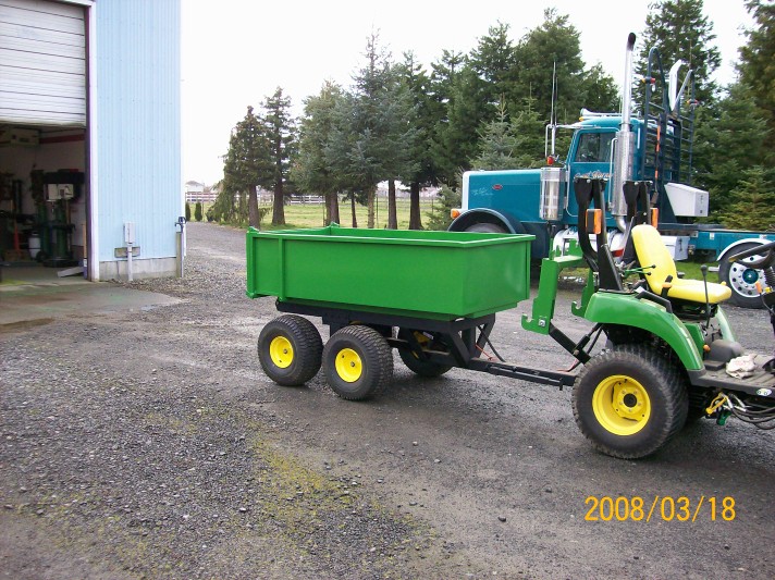

Looks great,well built. Did you use a walking beam to the axles? I would be interested in seeing some more pics of the suspension, thanks

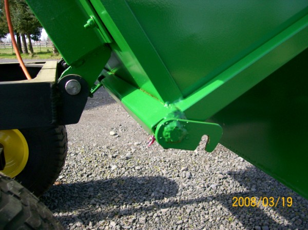

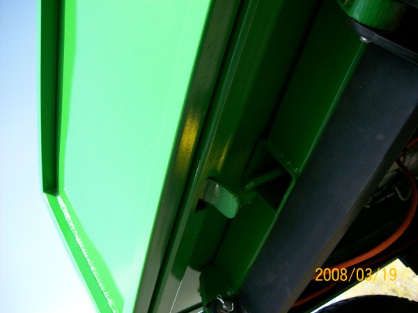

Very nice job. Please post some more detailed pics of the linear actuated gate mechanism

   / dump trailer
here are some shots of the actuator and linkage, it is probably clear as mud !

   / dump trailer #8

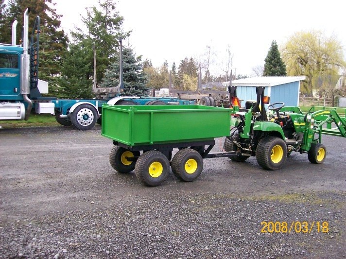

It looks huge! are you hauling lightweight stuff like bark etc. or are you going to fill it with dirt etc.??
What are the wheels from? or did you just buy them?

I bought the wheels and tires from country manufacturing, probably will haul a little bit of everything, but I won't put a big charge of crushed rock or gravel in it, but topsoil or bark I'll load 'er up !!:D
