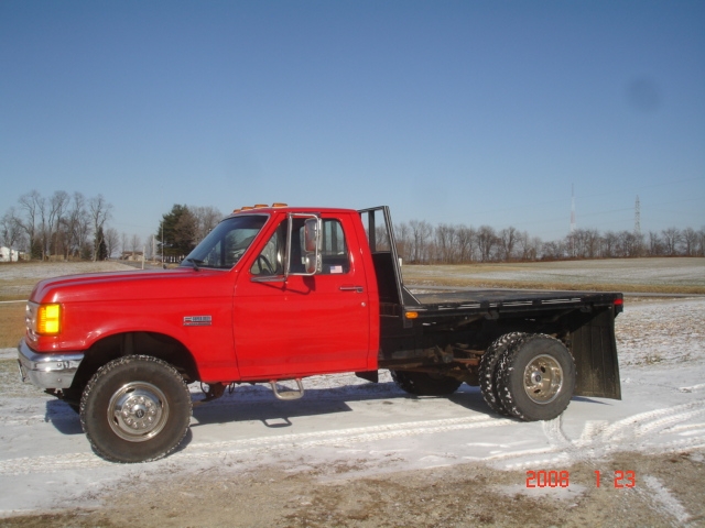

The Ford would probably be easier on the purse strings as far as insurance goes. Insurance companies don't like the word "dump". First, the C-60 would be considered a commercial truck, and puts you in a completely different insurance bracket. And being a dump truck, they will really rack you. I had a '91, F-450 with a flatbed I only used to pull my goose neck horse trailers, and tri-axle equipment trailer. Even with a multiple car discount, insurance cost me $3 a day for it. But, I did cover full coverage on it, because it was a super nice truck for its age, and dealing with the uninsured motorist issues, one can get into. I sent "Ole Henry' down the road, as much as I hated to, and got a '96 Dodge 3500 with a Cummins. Insurance was less than half, and pulls it just as good, if not a bit better.
Do be aware, if the Ford has a manual 5 speed, ZF transmission, the tail shaft housing is designed to leak, this is no BS. Ask any Ford service tech that is familiar with them, or check out some Ford truck forums. It's not a problem if you check, and keep it full. I had 3 different guys tell me to make sure I check the tail shaft housing oil level, every oil change. Their's had gone out, and had to replace them, and were all told the same, it's designed to leak, you should have read your manual. Go figure...
If that is a F-350, I'm thinking GVW should be 11,000 at most. The F-450, or just says Super Duty is rated at 14,000. Easy to tell. F-350 has 8 lug wheels, Super Duty, or F-450 has 10 lug wheels.

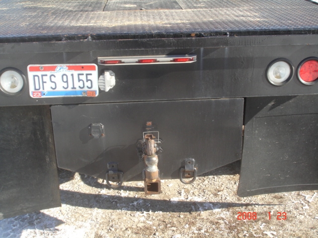

Here's a few pics of Ole' Henry. Loved that little truck, it looked like a little bulldog. Just too costly to keep around.

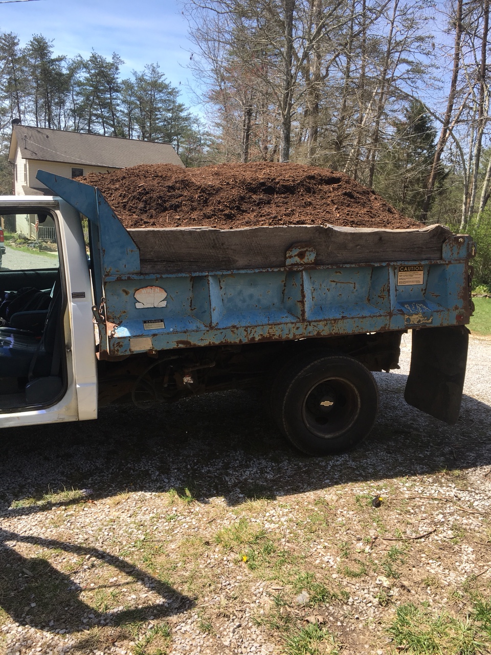

My 3500 dump truck will hold about 5 yards off mulch and about the same amount of dirt. Gravels I run out of capacity first. I didn’t have any trouble with insurance on my truck.IMG_4003.JPG
