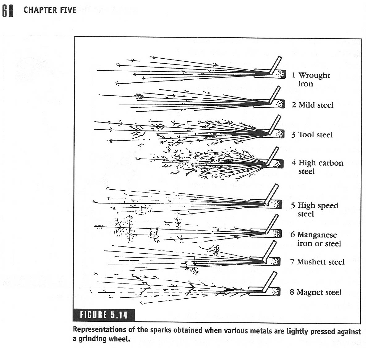

Okay, anybody know for certain how to tell cast steel from cast iron? I have bought stress proof hardened new axles for the cultipacker (dang, not cheap!) and four high quality bearings in flanges in which the new axles will ride. My issue right now is that I need to cut out four plates from 3/8" steel that measure about 6"X6", cut a 3 1/2" circle out of that piece, and weld that part to the existing barrel on the culti-packer where the axle will fit.
I can burn out the pieces easy enough with my plasma cutter, but I am having a hard time determining if I have cast steel or cast iron. I'm thinking it is cast steel because I had one "arm" that was bent that I was able to bend back in my 20 ton press without it breaking. From past experience, if it was cast iron, I think it would have broken then. But, if I was sure, I wouldn't be asking...so, I'm still not sure. Thoughts? It says "Dunite metal" on it, but I can't find anywhere if that means anything.

The attached image shows a simple technique for identifying types of metal. Not sure how good or accurate it is.
From a Forney Welding Manual 9th Ed., Copyrighted 1972. No ISBN number. Moderators can delete if concerned.

Similar thing (worse quality picture) from:
Welding by Don Geary copyright 2000
ISBN: 0-07-134245-1

Thanks. It's not exactly out of date for working on something that was made in the 20's though. :) Strange enough, I called the instructor of a local technical college who teaches welding courses and he gave me verbal instructions very similar to tell the difference. If you hit cast iron with a grinder, you only get sparks for about 2 or 3 inches. With cast steel you get the normal spark show for a few feet, just like, er, with steel.
Now, from all the welding sites and this instructor, they all tell me that I need to pre-heat both the parent material as well as my brackets and use a 7018 rod to weld. Then, they all advise me to cover it with some sort of fireproof blanket or let it sit directly in the sun to allow it to cool slowly.
