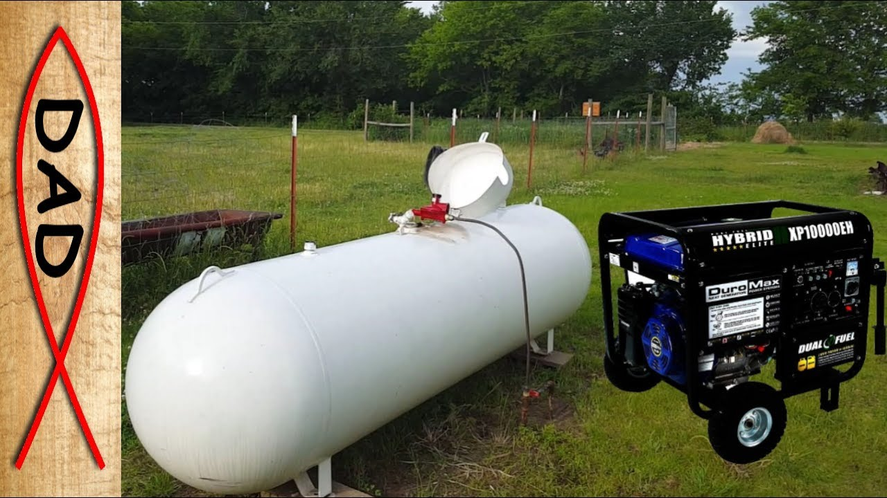

Since my region has sand and rock, most people choose propane for their generators because they already have the huge propane tank in their yards. It's nicely stored already, no cans to have sitting around. The generator can run a few months on end without refilling because of the direct propane line and valve.
Not running with much of a load or running full time it won't, at least not on that tank if it's a 500-gallon tank.
Even a 500-gallon tank only has 400 gallons in it, when full.

Yep. According to Duromax at 50% load this consumes 1.35 gal of propane per hour. Assuming you could use all 400 gal in the tank that is 296 hours or just over 12 days of continuous use. Of course lots of scenarios where continuous use is necessary and lots where it is not.
