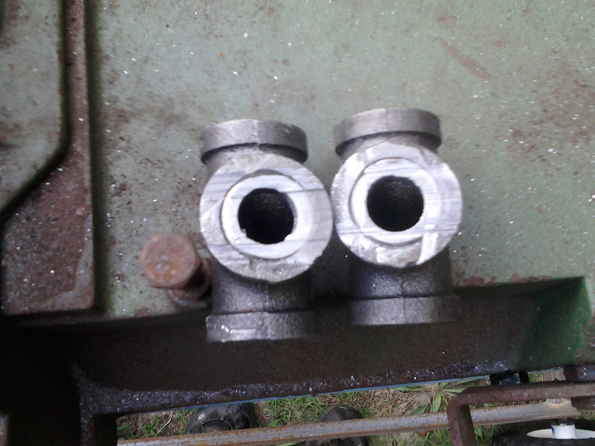

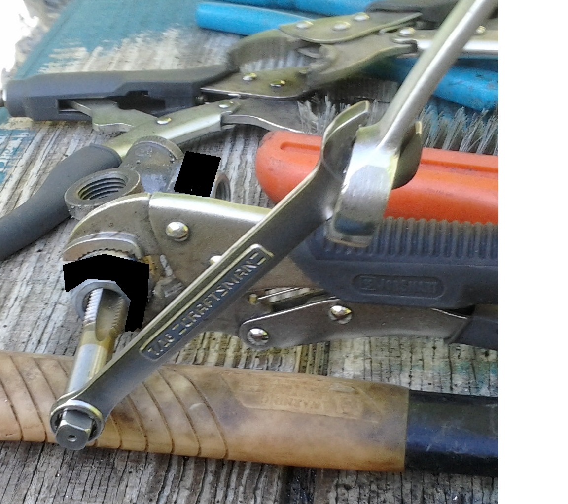

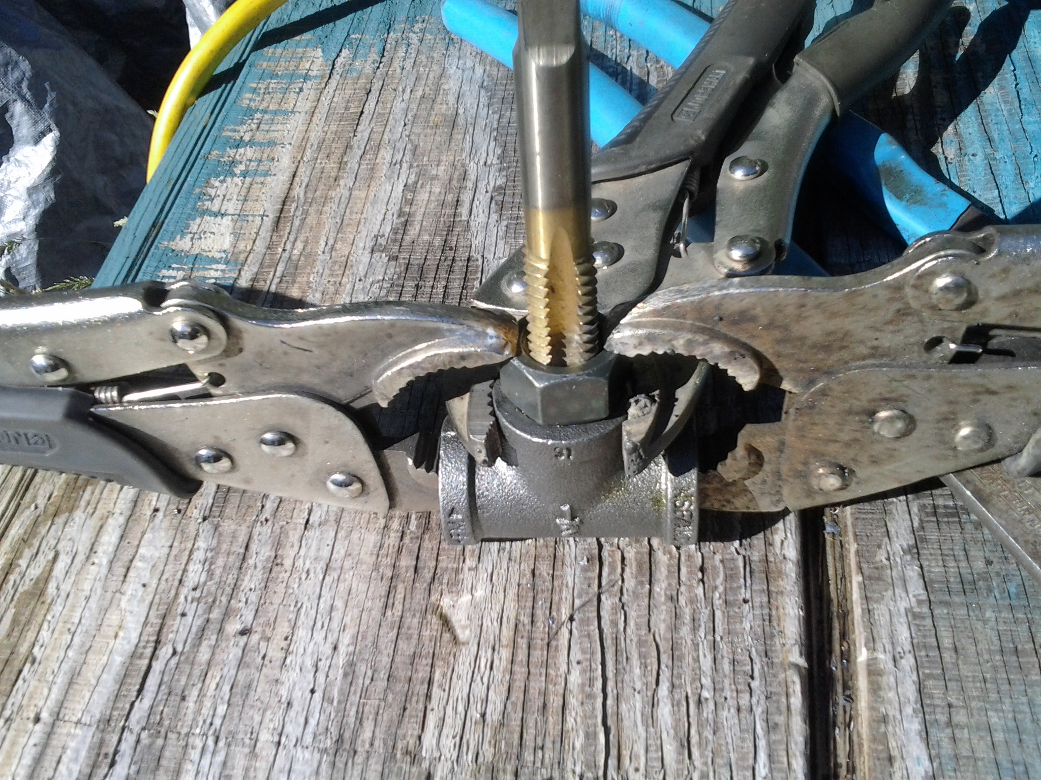

Not much to show for the time spent - I should have practiced welding or learned some photo shop. I am just a little over half done with the spindles. I bought 2 half inch black pipe T's and 3 closing nipples. The closing nipples are because I am using 5/8 inch bolts for axles.
First I attached the two t's together with a closing nipple in the 'leg' of each T. Then I sawed them apart as close as I could.
Next I screwed a tap into a 5/8 inch nut up to where full size starts. Then I clamped this onto the 'leg' of the T.
Connected the nut and T with a process I hope to one day know how to.
Hope I didn't miss blocking anything too offensive - I know I left some splatter.
You can see my method of tapping the inside of the nipple and resizing the nut after the heat treatment.
All the other openings of the T's also received half of a closing nipple. These will be drilled to accept a 5/8 inch bolt.. This can be avoided by using 3/4 inch bolts to attach to the bracket which I have made. Still thinking about drilling the 5/8 inch hole through the T. Wish I had access to a lathe.
There are much better ways and finer tools to use to do this not to mention a dry shop, but... Still need ideas and advice.

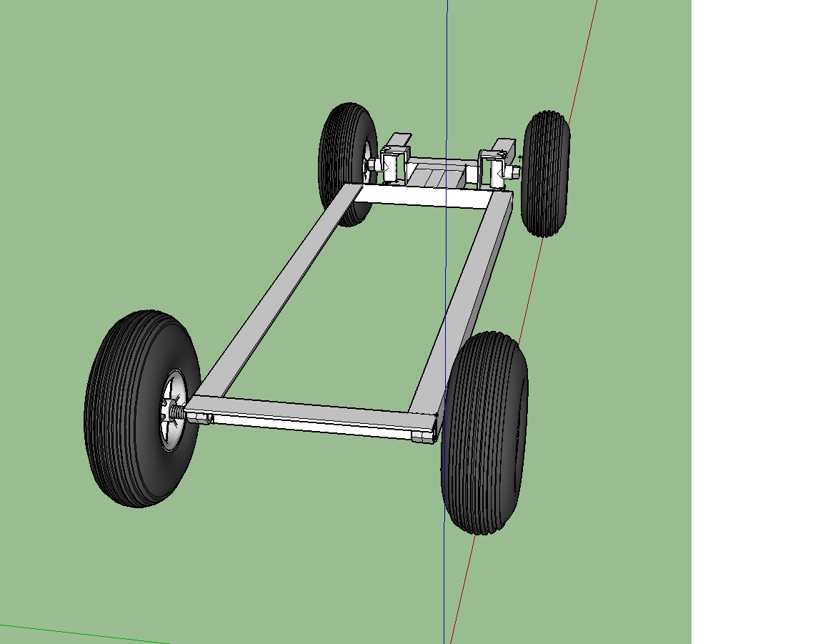

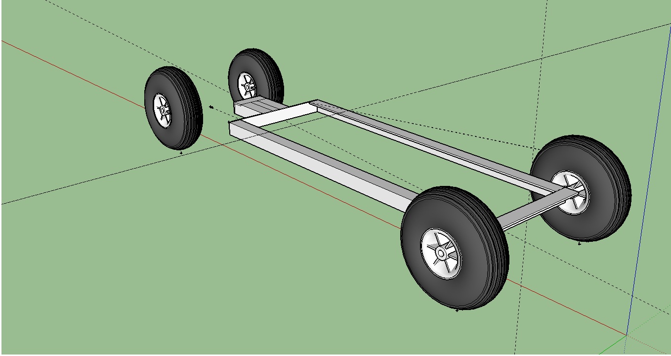

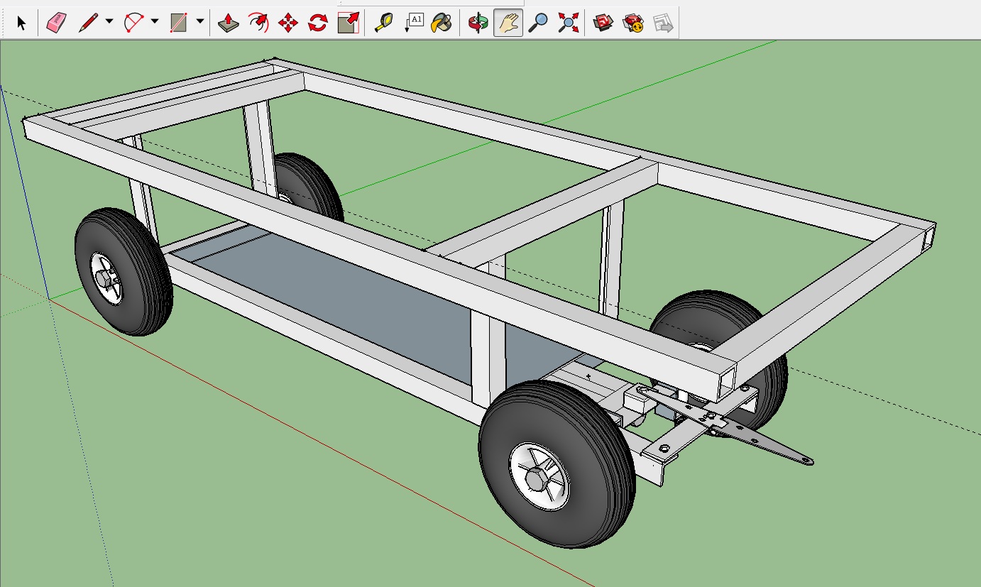

Another day of rain. Tried my hand at putting it in Sketchup. I'm 80% done with the front axle (but have no idea of how to draw it) and 98% with the rear axle. The wheels are from the 3D Warehouse. The 5/8 inch bolt I intend to join the front axle to the rest of the base is starting to look small. Other than being a bunch shorter it is the same as all 4 axles.
Headed in the right direction? How would you do it?

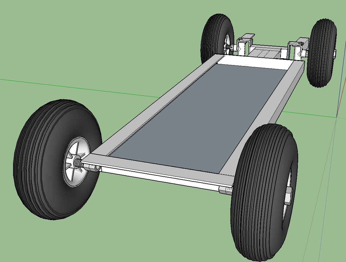

#9
Moving slowly along... getting old is more fun than being old :laughing:
