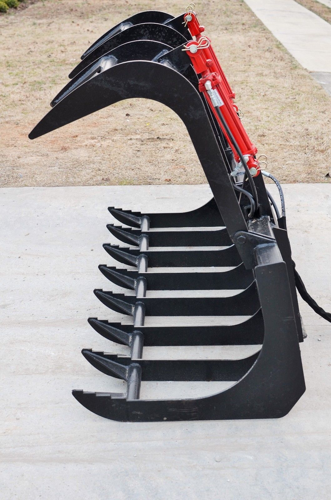

There is a grapple thread that came up just today with a lot of good info especially about what kind of jaws you want for the work you need it for. I'm in the process of getting one and needed to get some help on the decision. I decided on one like this:
But read the thread and make up your own mind ... as if I needed to tell you that:p
