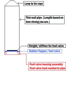

Hi Guys,
I'm doing this as much for fun (experiment) as for practical reasons. I picked up a gas powered auger for $10 yesterday. I'm going to put in a shallow point well. I'm planning on drilling down about 15 feet or to wherever I hit water bearing sand, and then I'll stop drilling and will wash-in the well the rest of the way. Going to use 3" PVC as a casing. Will drop a 1 1/4" PVC point into a gravel pack and then will pull the 3" casing out of the ground.
Anyway....I'm going to fab up a quick, temporary, well drilling rig using the auger and 3/4" pipe extensions. Should be easy to do. The only thing I'm questioning is pulling the dirt out of the hole. I'll use a winch to lift the auger, but I'm not sure that the dirt will come out with the bit.
I'm thinking about sliding a sleeve about a foot down over the top of the bit, leaving the bottom half of the bit exposed. My thought being the auger would pull the dirt up into this sleeve and then when I lift it out I might be able to get a 4 or 5 foot core of dirt out. The sleeve could rotate with the bit and I would guess it would render the whole idea useless at that point.
Anyway, its a fun project. Might fall on its face and not work at all. The drilling will work...just don't know about this sleeve idea. What do you think about the sleeve? Waste of time or might possibly work?

Hmm... I'm thinking the sleeve will pack full at the two or three inch mark and then the auger will fill up tight. At that point you might break something. Or, you could then haul the auger full of mud out of your shaft. I'm just now realizing you probably don't have the same soil I do. The scenario I'm describing is what I could see happening in heavy clay soil. What sort of conditions do you have?

I should have mentioned in my original post that we're in sand. I can try the auger without the sleeve, first, and see how the dirt comes up. Most of the videos I see show an auger the full length. So if you're drilling 20 feet deep you have a 20 foot long auger. My auger will be about 4 feet long on the end of 20 foot pipe. So the idea with the sleeve is to contain the sand so that I can pull up a bunch of sand at one time. No idea if it would work.

When you pull the bit and pipe out will the sand on the sides collapse, filling the hole again?

It might. The plan is to slip a 3" PVC pipe down the hole. But if the hole collapses that's okay. I can wash down the 3" pvc and clean the hole out. It will be easy to wash it down since all the sand would be loose.

What size auger do you have? 10$?
The 'Earthquake' augers I've seen for a couple hundred have had 6" or 8" available, maybe a 4" on order.
It would be a lot of work, but it would actually be easier to power auger a hole in clay.
A lot of lifting, cleaning, prying, washing the clay off the auger, then down the hole again. Hooking and unhooking your extensions.
The sand won't stick, it will slide down the auger as you pull it out.
If your going to set up to wash the point in, do it from the start.
Use the 3" or even a 4" PVC pipe for a liner for the hole.
Wash your way down till you get to the depth you think will work and drop your point down and pump.
If its not good yet, pull it out and wash somemore. The sand will loosen and flow in moving water.
When its done drop your point in and your rock and pull the PVC.
You know the rest.
Goodluck
