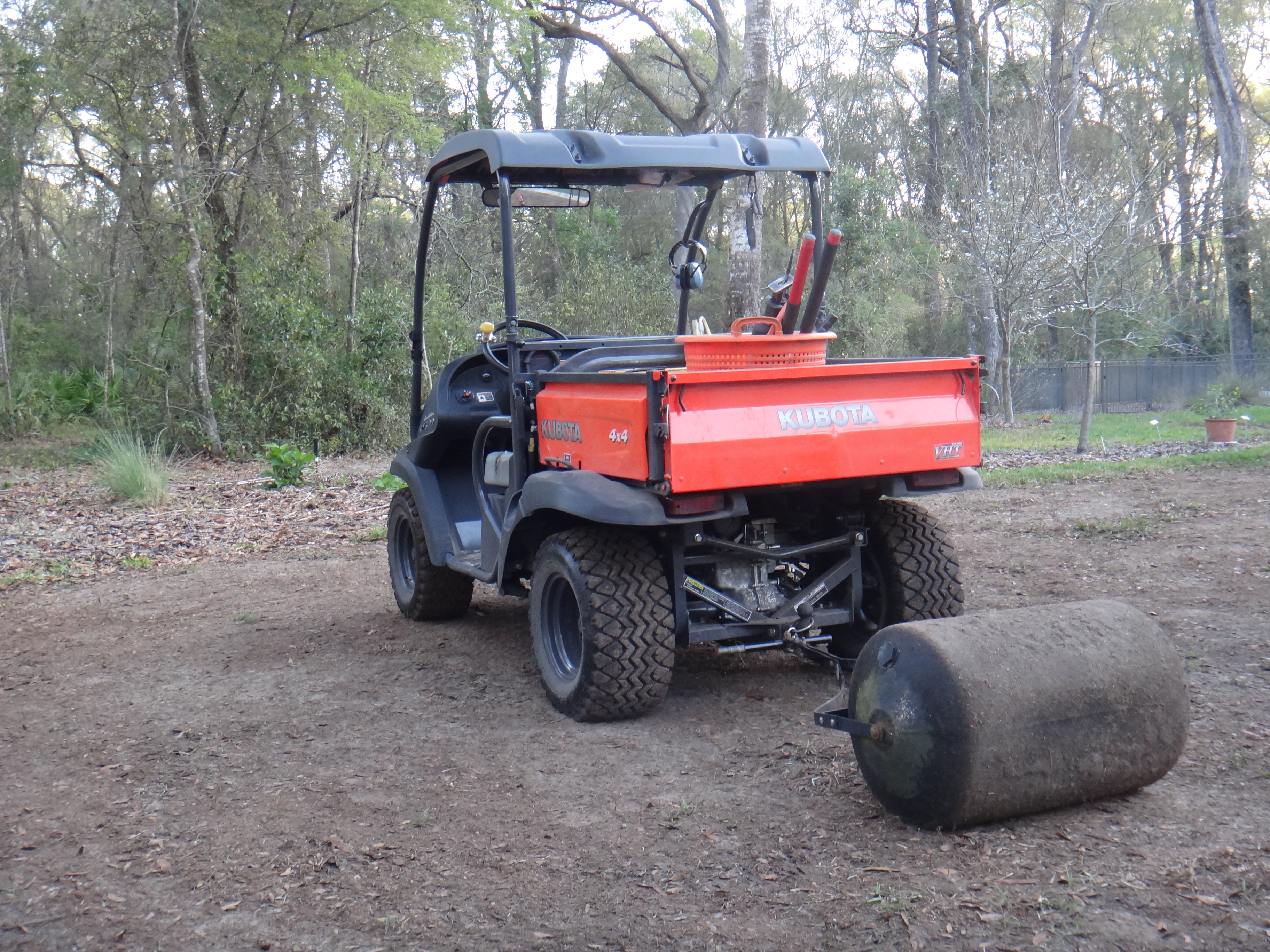

I have an 18" diameter poly roller I pull behind my utility vehicle for rolling in grass seed. Roller smooths area between utility vehicle tires. Not heavy enough for your application.
