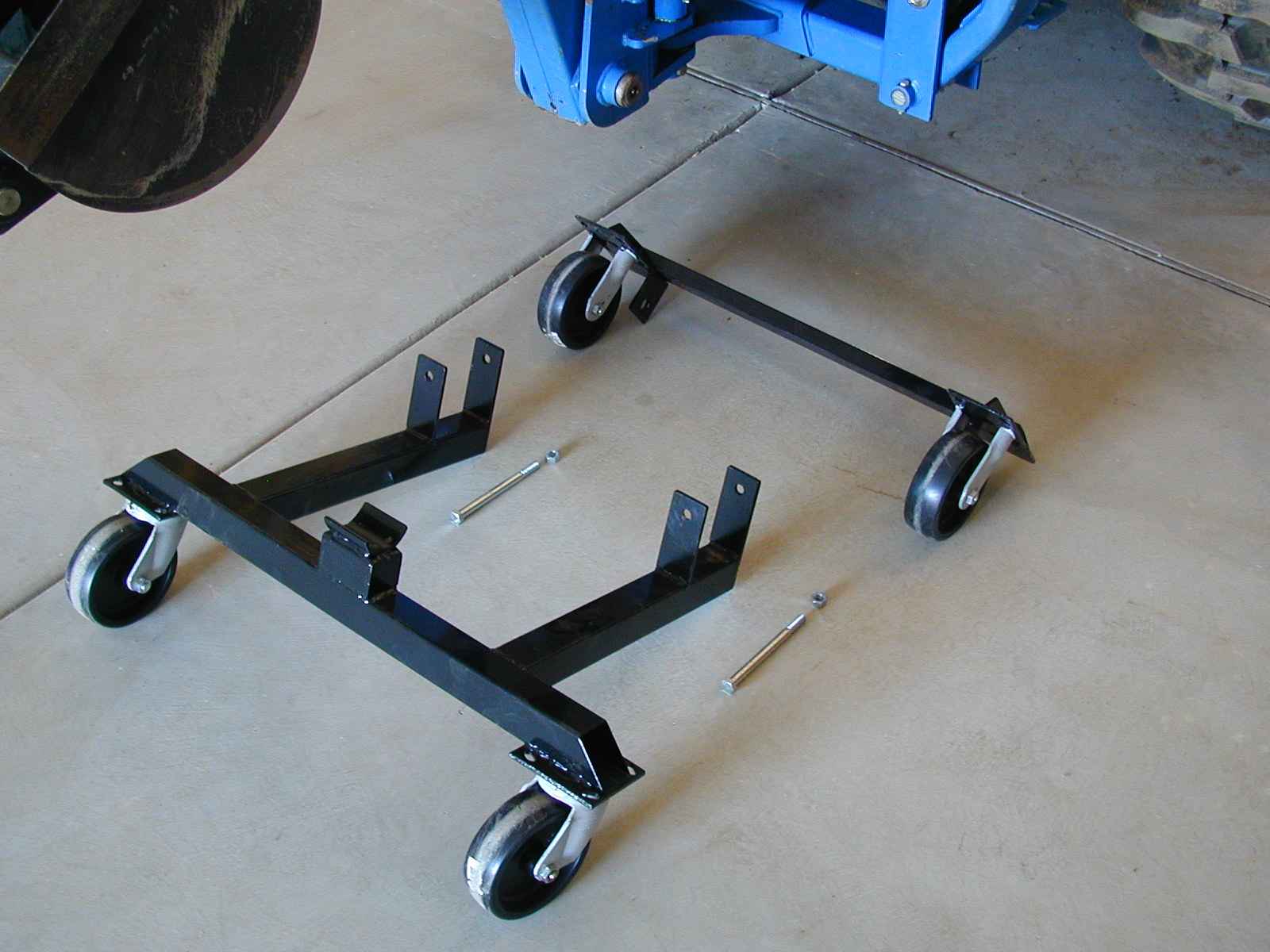

   / Easier way to get backhoe on? #7
viperman,
Here's a dolly I use. Makes the installation very simple. Park the tractor on concrete, and you can roll the backhoe right into position. First picture shows the two dolly pieces. The larger (swivel casters) goes in the rear, and the smaller goes on the front. The rear dolly piece attaches with the two bolts you see in the picture. The front dolly piece attaches using the two pins that attach the backhoe subframe to the tractor.

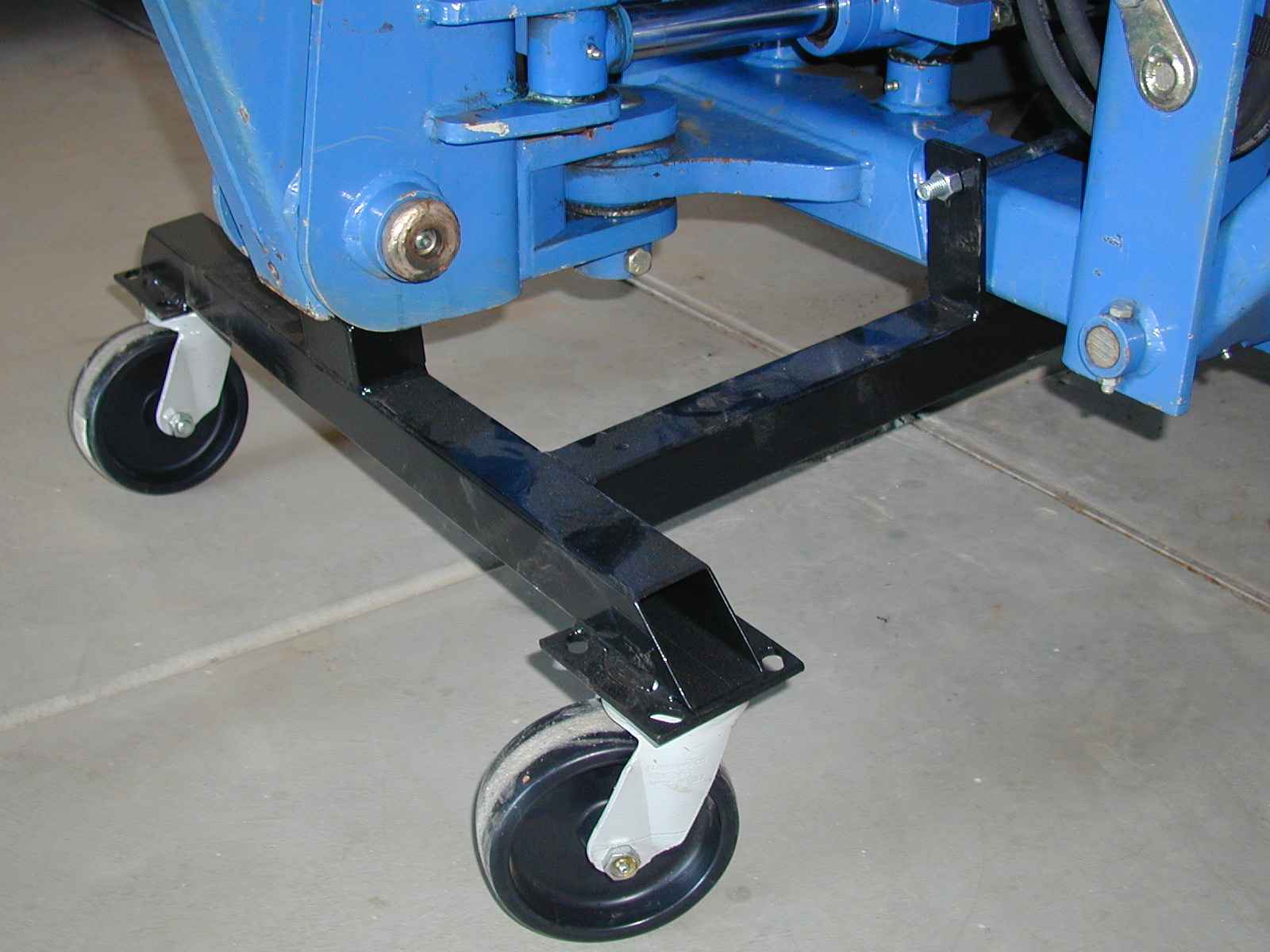

   / Easier way to get backhoe on? #9
Here's the front dolly in position...

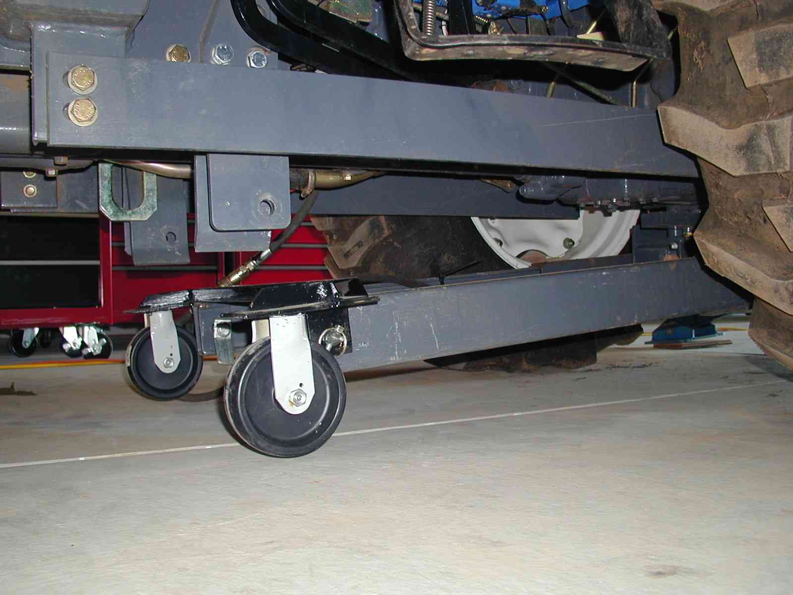

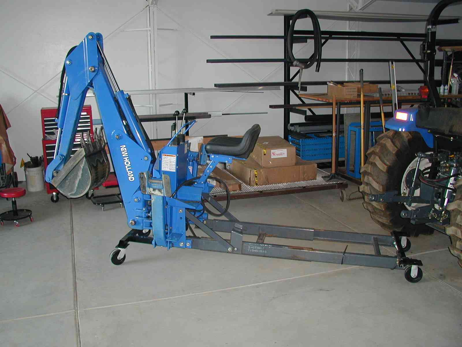

   / Easier way to get backhoe on? #10
Here's the end result...
