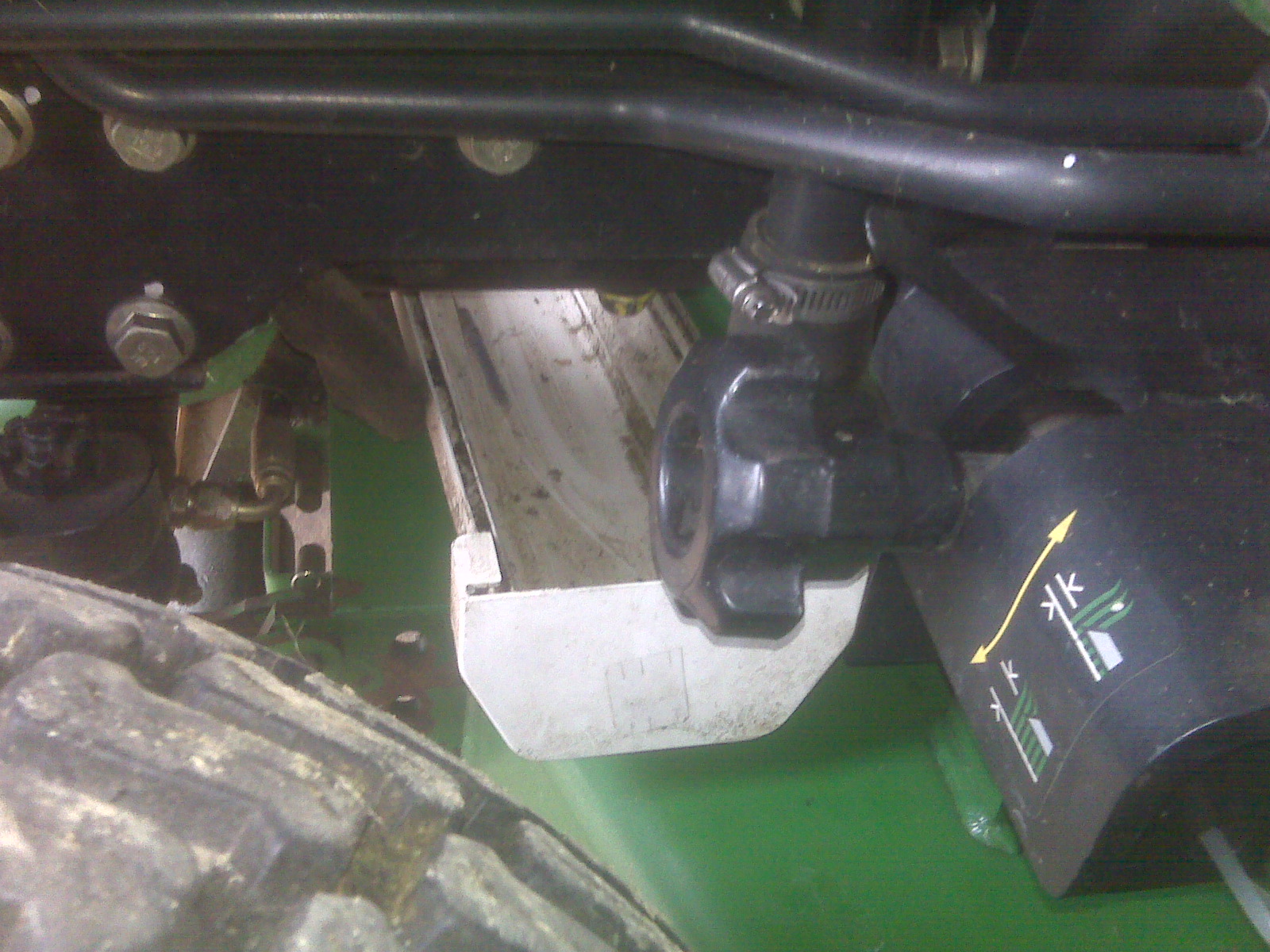

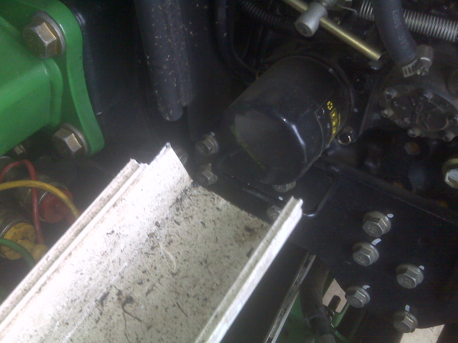

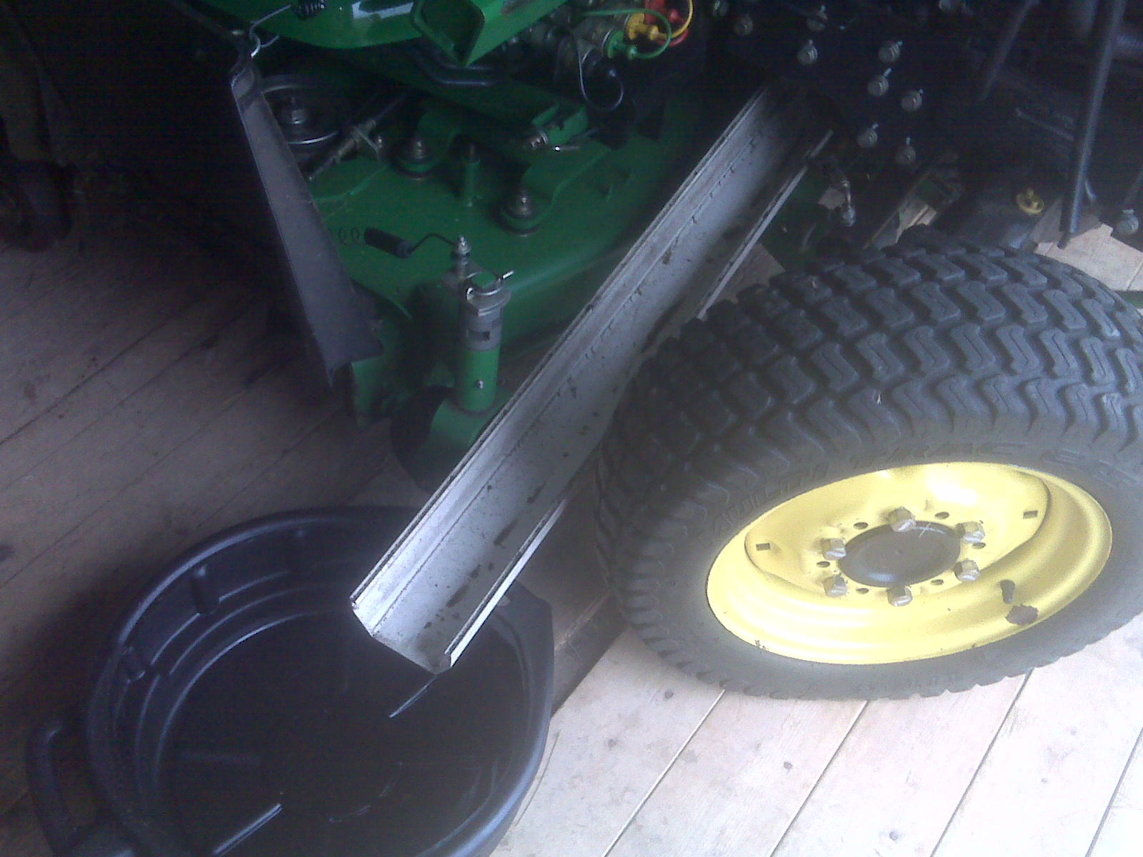

With the mower deck installed on my 4210, there is very little room under the engine to fit any decent size oil pan, only a very shallow and small capacity pan would fit...nothing that would hold a gallon of old oil. A long section of PVC rain gutter with an end cap cemented on works great as a draining trough, and a second section notched out to fit under the side-mounted oil filter on the Yanmar keeps old oil from dripping down when I remove the filter, instead it flows into the drain pan.

That would work well as long as the oil didn't seep thru the cardboard. I should have mentioned in the original post that it's a good idea to get the gutter section up as far as possible toward the drain plug so the initial gush of oil doesn't splash over the sides.
