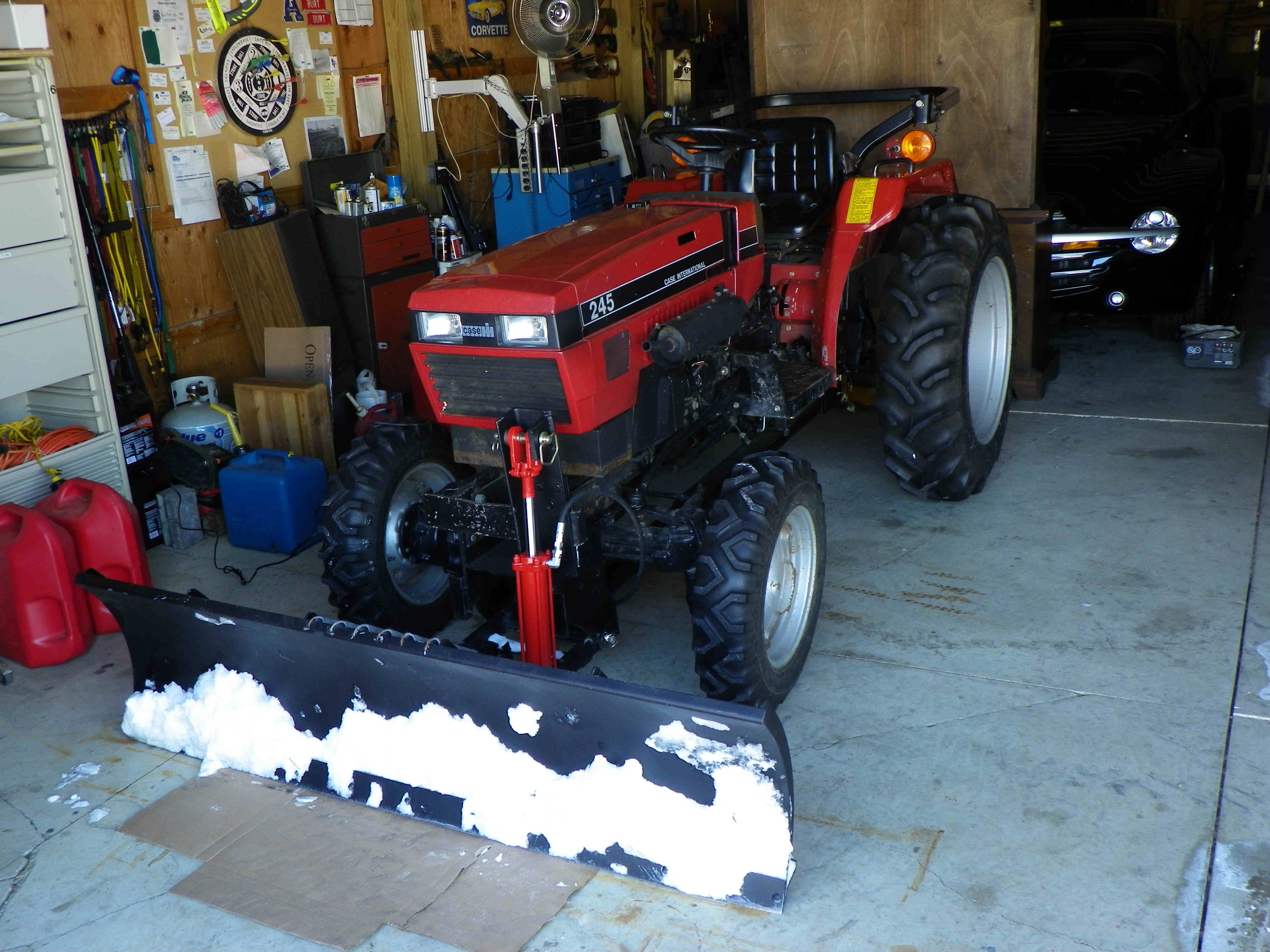

I picked up Case 245 with Ags on it last spring. I was hoping it would spin a 6 foot Landpride finish mower and it worked well for that, hard to get stuck but it will tear up some turf. It came with a 6 foot front mount plow that moved huge amounts of snow this winter and the Ags were awesome, I included a picture.
In the past I moved snow with a Cub 1872 and blower, weights and chains, the plow is so much easier to attach.
