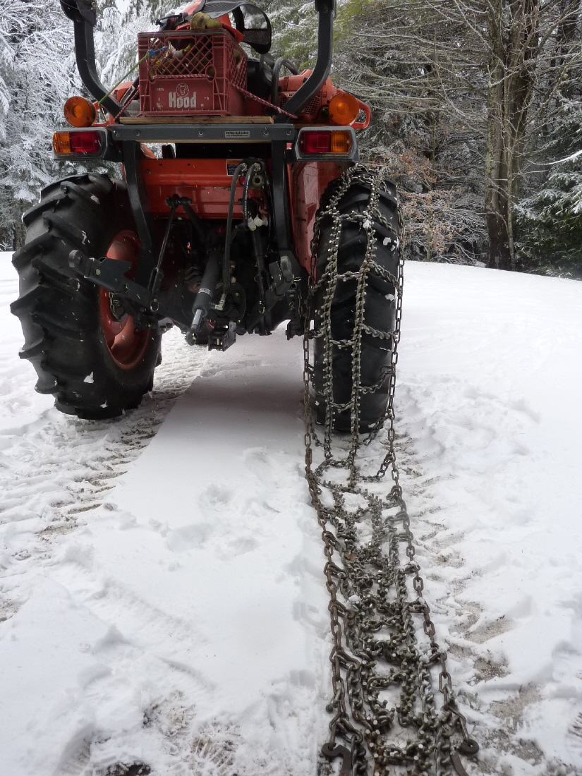

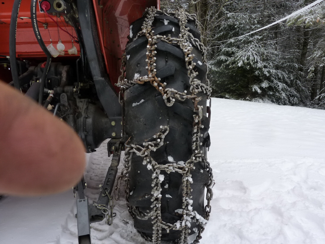

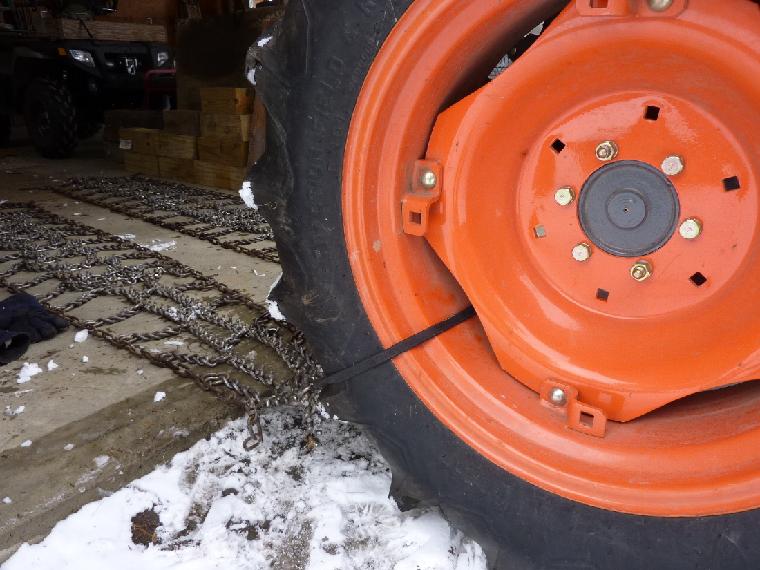

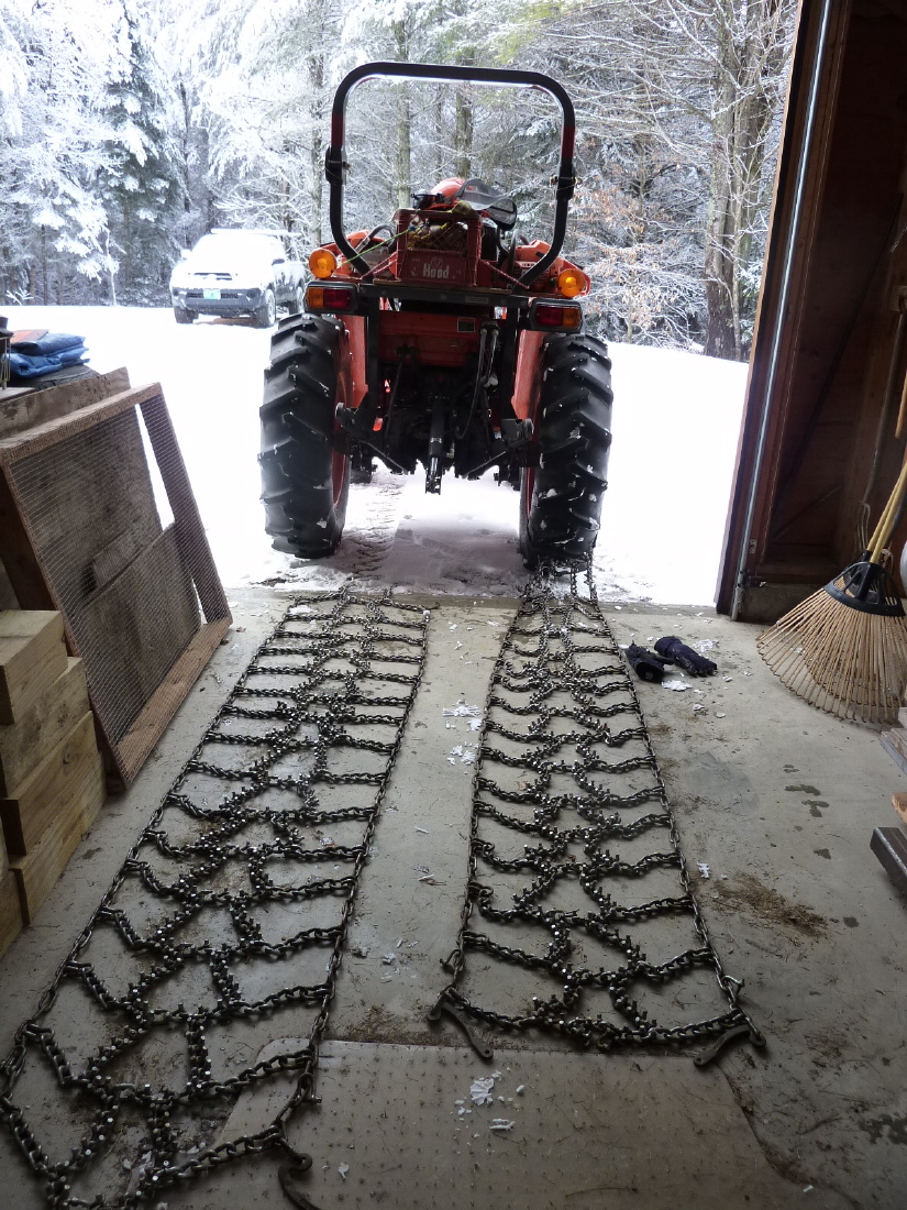

I mounted my chains today and snaped a couple pictures for the benifit of anyone who is trying to find an easier way. This is not a novel or new approach. Many already use this well know method. It is almost to easy. I learned it here on TBN several years ago. Hope this might help someone else.
Layout chains. Surface gripping side up. Run a bungy through the rim and hook each end to the chain. Drive forward pulling the chains up over the tire. Stop and arrange them once or twice. When you are all the way around and the joint is in a good location hook them together. They will be tight to the tire and easy to hook.

Excellent method with your style of rim.
Unfortunately my rims do not have those spaces to pass the bungee cord as mine are welded all around and no holes.
I do however use bungee cords but in a much more complicated way, so much so that I am tempted to weld a couple of 1/2 washers to have something to hook on.
