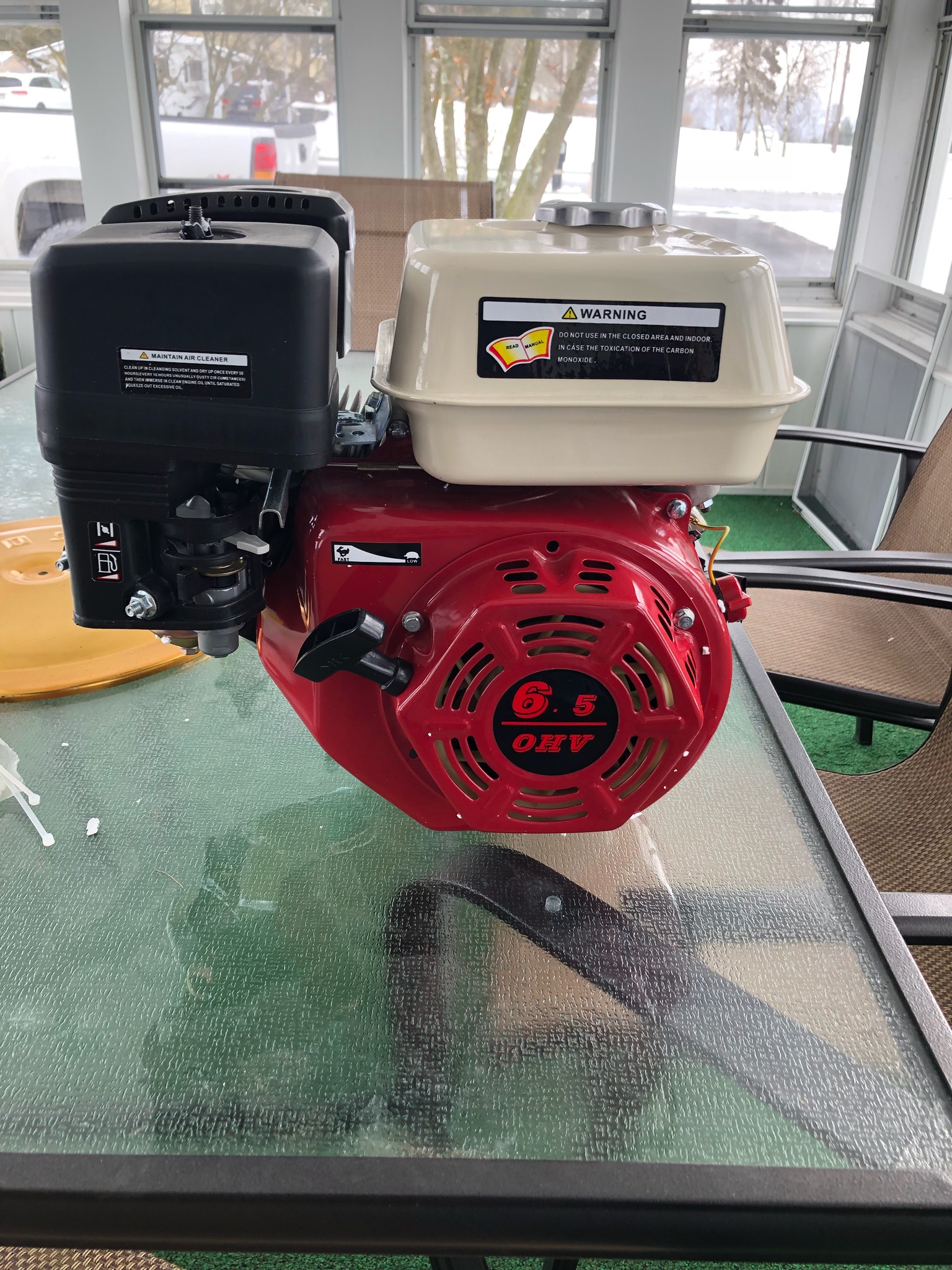

Ok so I feel like I owe you guys an update, yes I know I am 2 years later but life happened and I haven't been able to log on in the past year.
So with the motor, by the time I got done fooling around with whether or not to purchase this motor or not, it was not available by this seller or any seller for that matter. The same seller did have a larger almost 9 horse motor but that was way to large for my application. So I messaged the seller asking if they would have the smaller motor back in stock. They told me to message them back in a few weeks around December when they get back into generator season to see if they had it in stock by then. So I waited and then did message them around Christmas last year. They told me they really are not carrying that motor anymore cause they didn't sell that many but if I ordered right then and there he would special order me and have it shipped directly to me. So I did.
The motor came and was spotless, I put the generator together the following weekend,everything lined up and went together perfectly, added oil and fuel, it fired right up on the 2nd pull. Only flaw with it was it would drip a small amount of fuel out of the fuel shut off on the carb, but it didnt leak while running, or while in the off position so I am not worried about it.
So now was the anticipated wait to try it out. I got that chance with the snow/ice storm eastern PA got in the first week of March last year. The property I care take for lost power during the storm for 8 days. The house has an Older Winco 4800w Generator powered by a Propane fueled Briggs engine. After Day 3 of that running 18hrs a day I decided to give it a break during the evening hours and let my newly repowered generator stretch its legs. Everyday my generator would run from ~3:30 in the afternoon till 11pm, roughly 7.5 hours each day for 5 days, It sat and purred like a kitten, it was unbelievably quiet, fuel efficient (I was getting 4.5-5 hours on a tank of fuel) it handled load without hesitation even with the furnace running and a refrigerator kicking on, did not use a drop of oil, oil was as clean after 38 hours on it as the day I put it in.
So needless to say I feel as if I made a solid choice on repowering my backup generator. I will post in the future if any issues arise.
