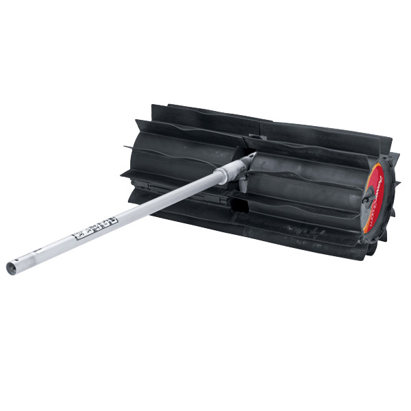

I've got an Echo 266 with the line trimmer and the paddle, works great ans as AuCivil says, you have an opportunity to run the engine more. I already had a hedge trimmer or else I woudld have bought one of those as well.
Only thing I would recommend is to get the line trimmer with the higher speed, I got one with more torque and it doesn't cut as good as my older dedicated trimmer. Saying that, it does work good with a blade so one or the other I guess....Mike

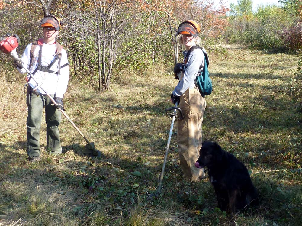

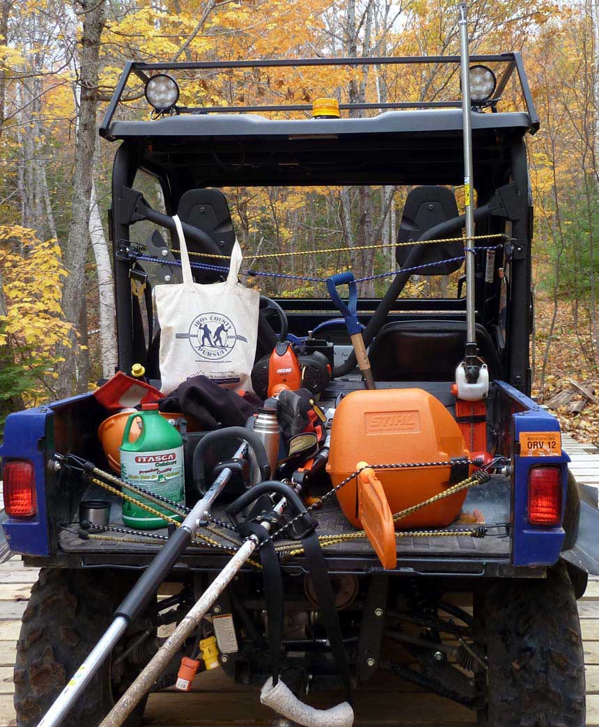

We have a couple of these units and used them lots. Plus the Echo units you can't change the head out on readily. (what are they called?) We do like them and plan to get more of these of both styles. Nonetheless, they are not perfect. For one, I don't like the button you need to pull to release the attachment. We wear gloves and its to hard to pull that little button while wearing them. I'm not sure how much we run these per fall but we certainly do run them some, might be 80 hours per unit.
We run sea foam fuel stabilizer in them all the time. Some 2 stroke oils come with stabilizer already in them.
I own the Echo straight shaft trimmer don't recall the exact model number but it is the larger one. What are you calling "the paddle"? Is it the adapter to use the three individual plastic cutting blades? I've used them and they work pretty good. I've been pretty dissapointed with the speed feed head as the line welds inside on the spool and then breaks off inside the eyelets and then have take apart and rewind the line. bjr
