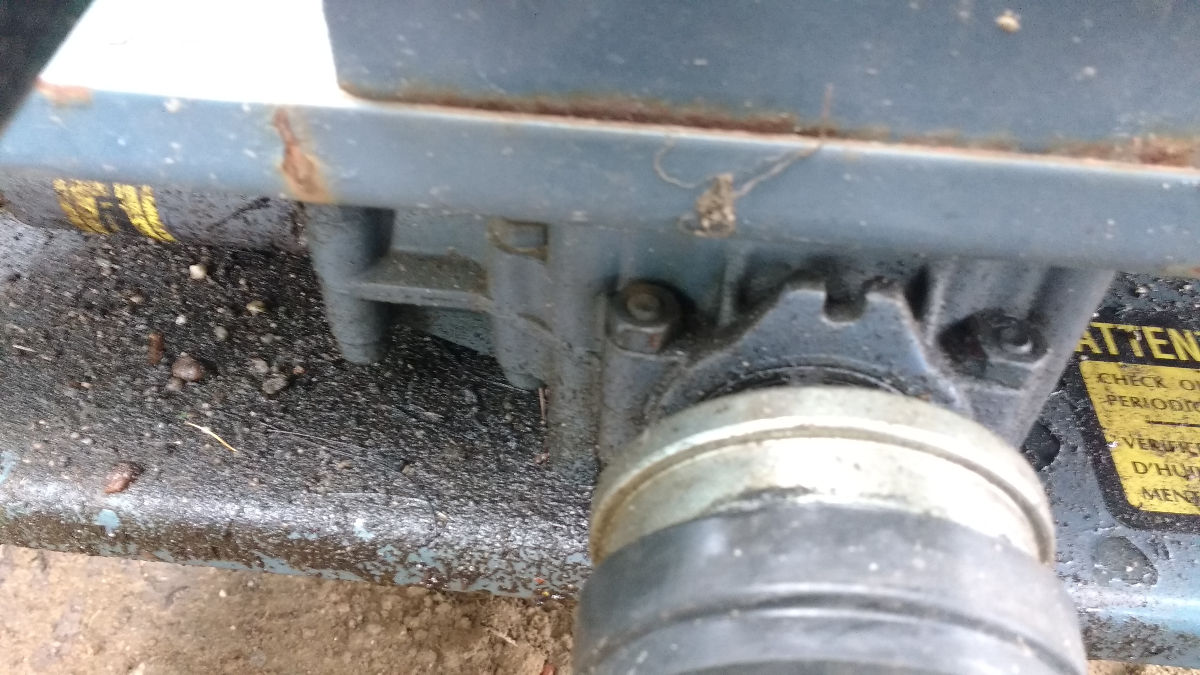

Here are the photo's if it work

Hi Dave
Guy
One photo was with your post.
I marked up your photo which is below.
The silver or gold collar should pull back (towards the tractor) and release the bearings which serve as a lock by fitting into a groove on the gear box shaft.
Likely it is the same as the end of the shaft on your tractor.
If it has not been off for a long time, the grease on the shaft may have gotten thick and sticky and spraying WD40, using a fine tube that comes with the WD40 can, between the gear box shaft and pto shaft may soften the grease and make it easier to pull off. Let the WD40 sit overnight.
The oil I see looks old. I would drain and refill the gear box with fresh oil. Clean up the old oil thoroughly and any oil you spill and then watch for a leak of fresh oil.
It may be that the previous owner was sloppy and spilled oil that was never cleaned up and there is no need to change the seal.

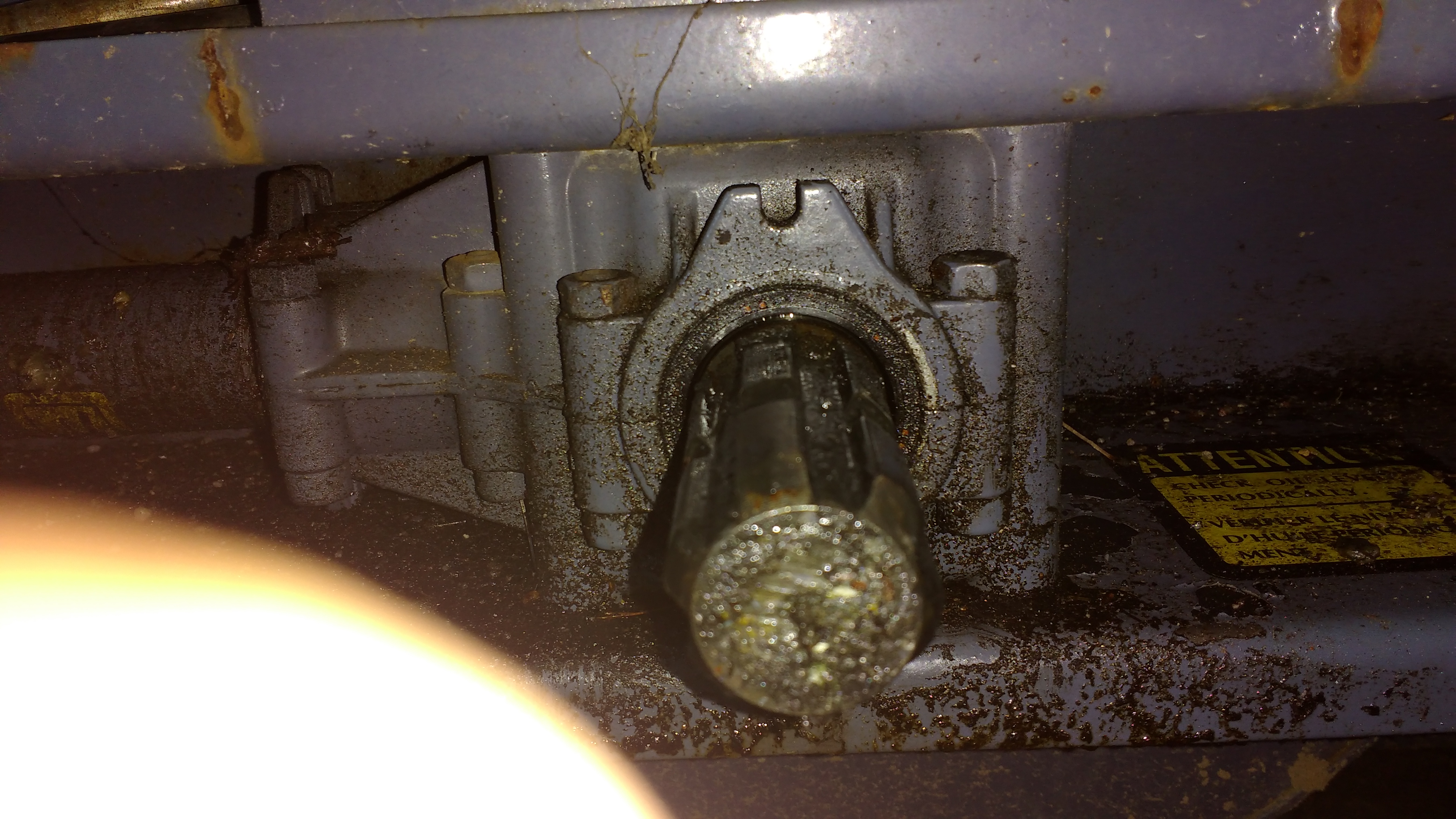

Here is the picture of the seal that I have to remove has you can see, what would be the procedure
