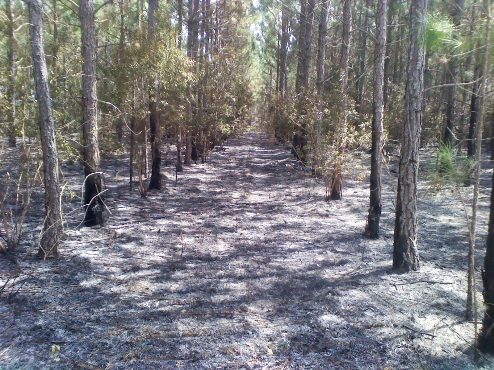

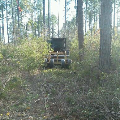

Have you considered using a drum chopper. This mashes the brush to the ground and the blades cut the lighter brush into smaller 6 inch pieces. After the brush is on the ground and given a little time to dry out then run a prescribed fire on the land. With the brush on the ground the laddering of the fire is not an issue. Your local forestry unit can assist in the burning and instalation of fire breaks for the prescribed burn. I'm not familliar with Oklahoma forestry division but the Georgia is very reasonably priced and you do not have to pay a transport or pick up fee. Also, if they assist you then a majority of the liability associated with burning is transfered over to them.
We have been running the smaller 8 foot Super C drum choppers pulled with either a dozer or a 80-100 Hp tractor. We have run mulchers and mowers on our plantations and have had the best result with the chopper and prescribed burning combo. THere is no maint that has to be done on the chopper itself other than tightening the blades every 100 acres or so and greasing the bearings on either side of the roller. Your biggest challange is going to be dealing with flat tires on the tractor your pulling it with.

031411 burn671 C.jpgIMG_20111205_155252-1.jpgHere is the end result of a pine plantation where we utalised the drum chopper/ Rx burn combo.
