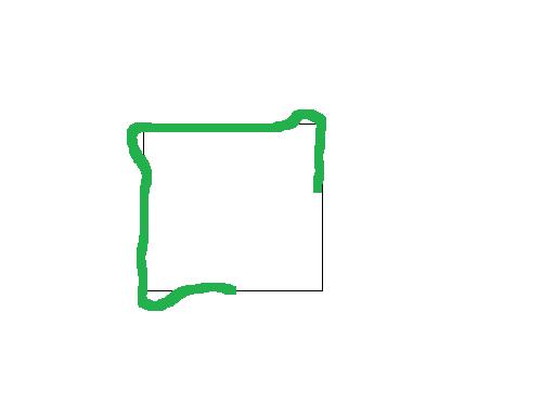

Another option for a square field is what I do. When you get to the end, instead of making the 270 degree turn, just to keep the corners square, make the 90 degree turn.Yea you will miss a little on the turn, but just turn back into whatever you mowing ASAP. The next time around will get whatever you missed. This puts the cutter back to work faster. You kinda get the idea by the pic.
