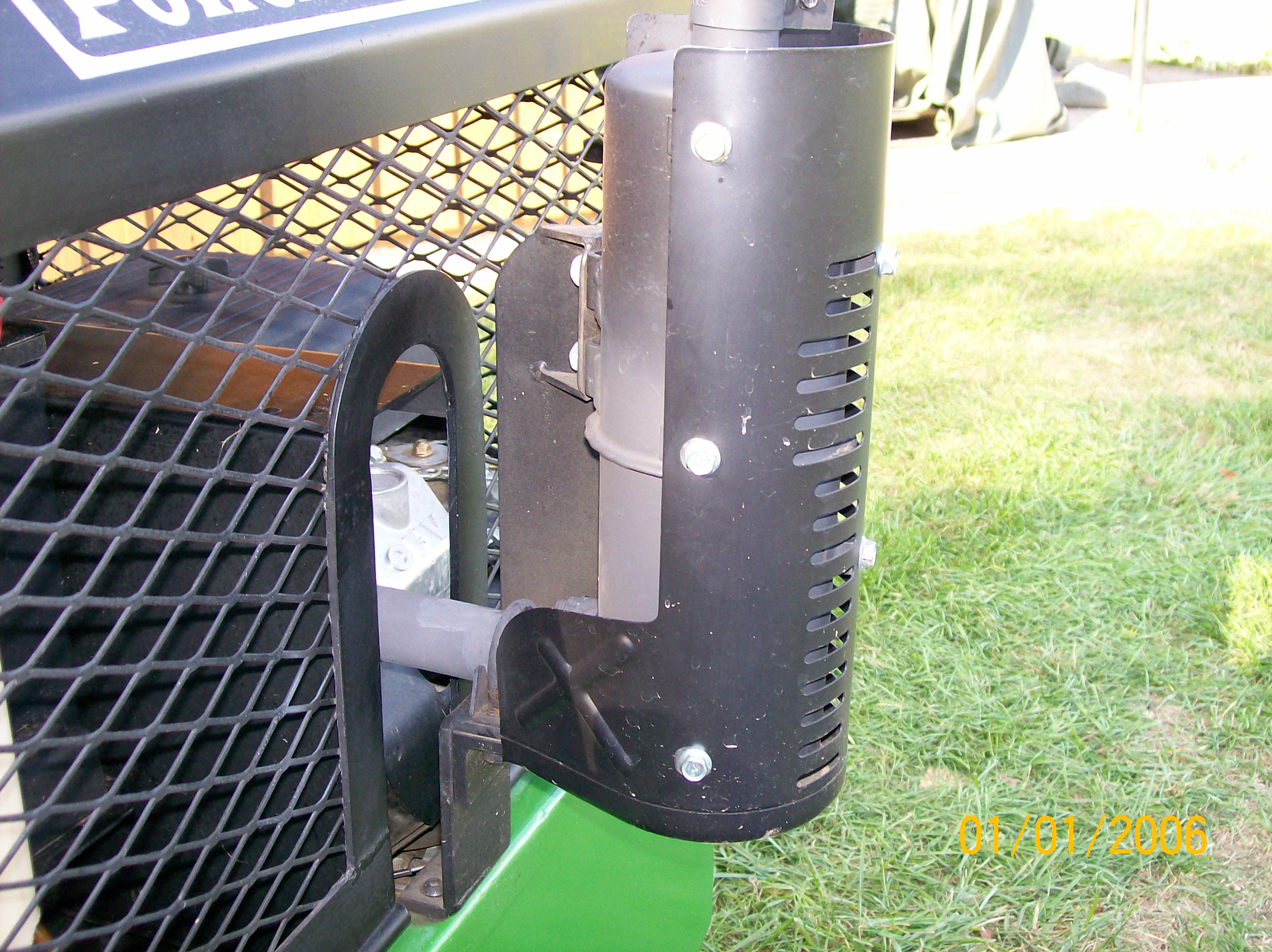

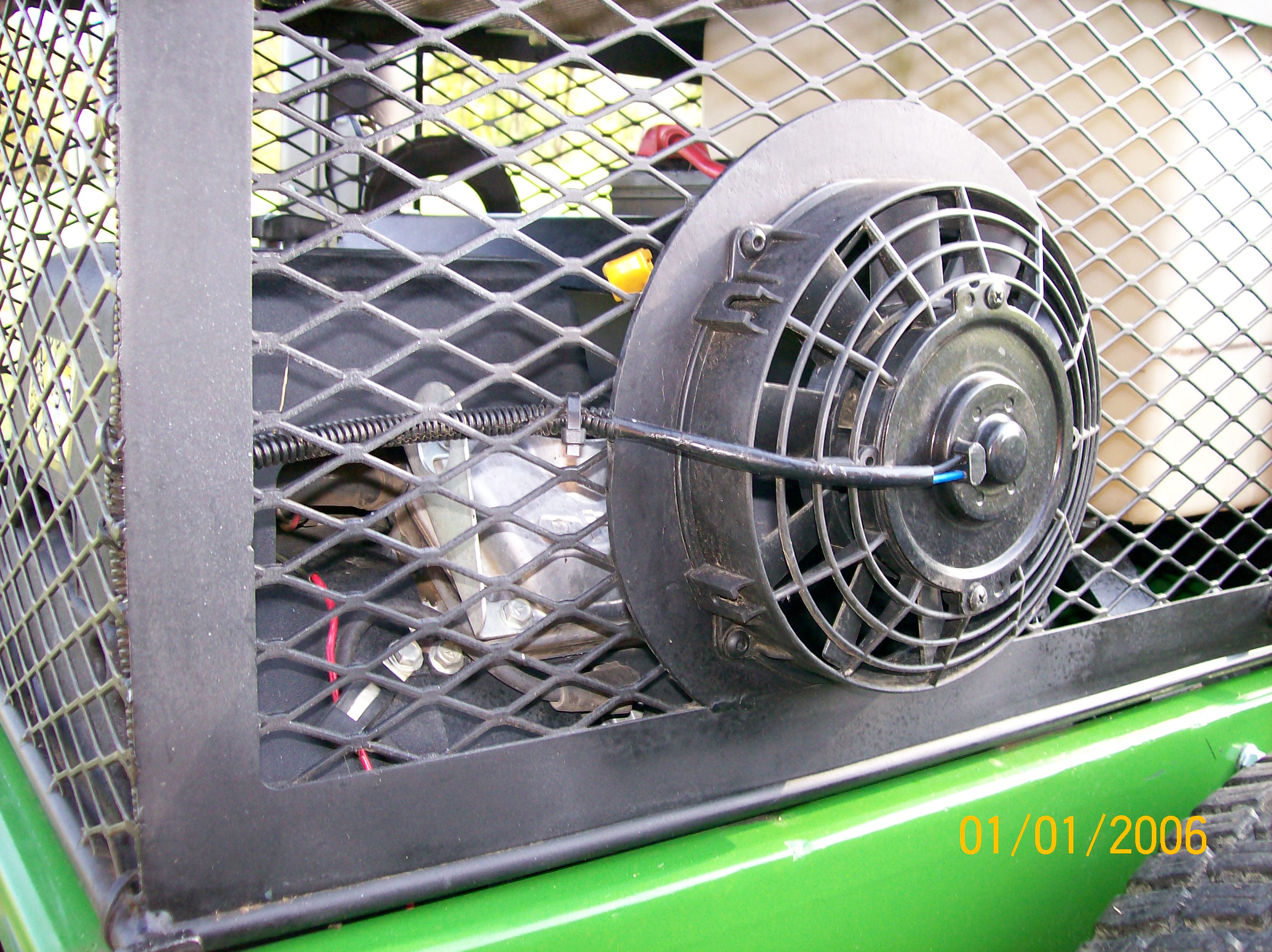

From all of the posts I read about the EH72 FI, I wouldn't get one myself. There's allot of posts on here about vapor locking with those engines. I'm not sure if anyone found the true reason why that happens with those engines? My regular 25hp Subaru never had any issues with that, or overheating, although I still put the fan and stuff on. Good luck with the new PT 425, with whatever size engine you decide to go with.
