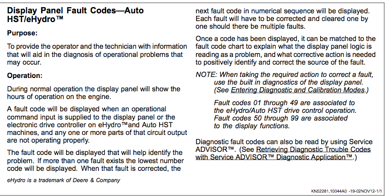

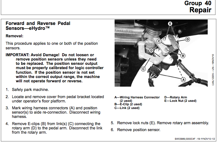

I don't understand why a fault code isn't displayed with the tractor running first of all. Screen Shot 2016-04-05 at 2.16.12 PM.pngScreen Shot 2016-04-05 at 2.22.57 PM.png
