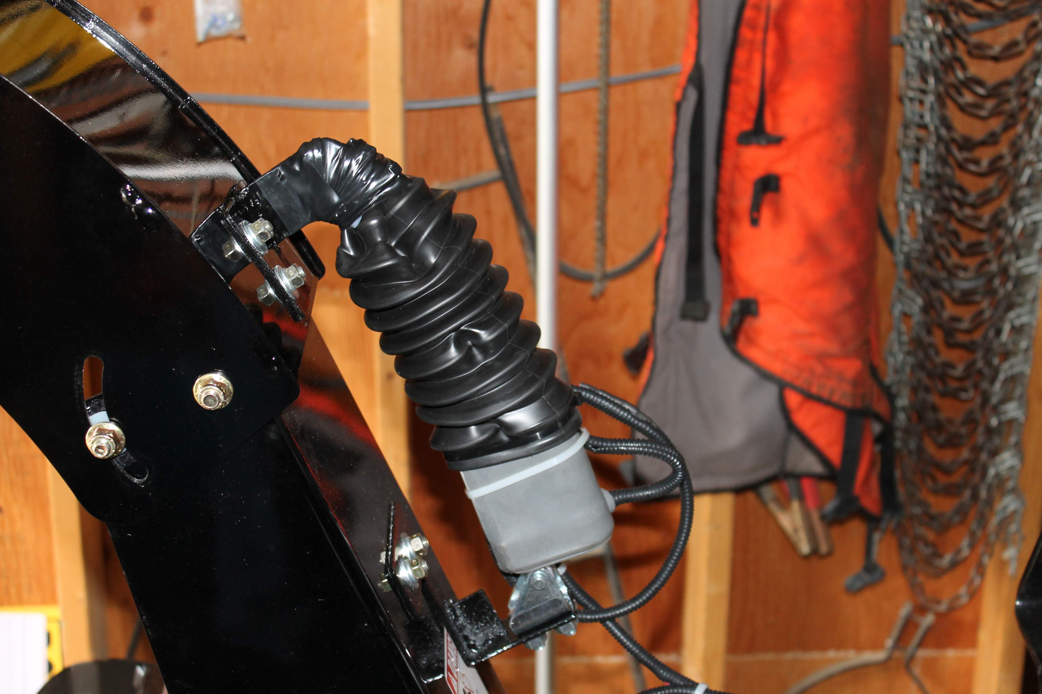

I bought a rubber cover from the place I bought my actuator from and also bought a car strut boot to cover the actuator shaft.

Smfcpacfp,
Thanks for the specifics and for sharing the details of your great job! It is greatly appreciated.
Here's a thread that discusses problems with water intrusion into the actuator.
http://www.tractorbynet.com/forums/...884-2360-electric-chute-deflector-frozen.html
There it is suggested to either rig a cover or mount the actuator upside down to prevent freezing and/or internal rusting.
Do you think your specific actuator is sufficiently weather protected to prevent this or is this a potential problem downstream?
Thanks again,
N. Fowler
The unit I bought states that it is weather proof and it certainly looks so. I was going to put some silicone sealant around the joints before I installed it but I forgot. Mounting it upside down would be easy for me and I may do that this summer. My tractor is stored inside and I did wipe it off before I was done.
