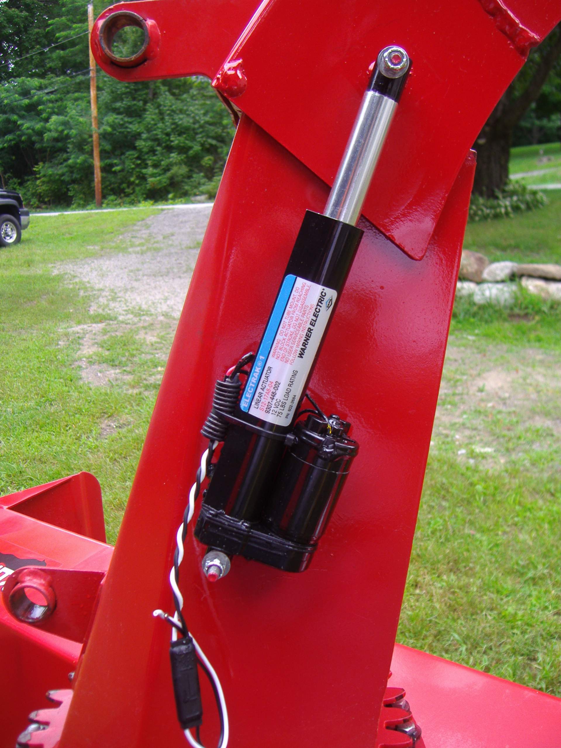

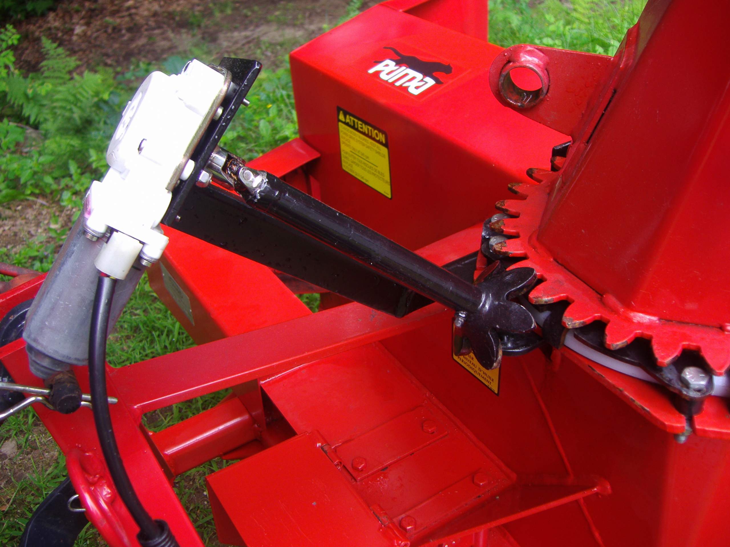

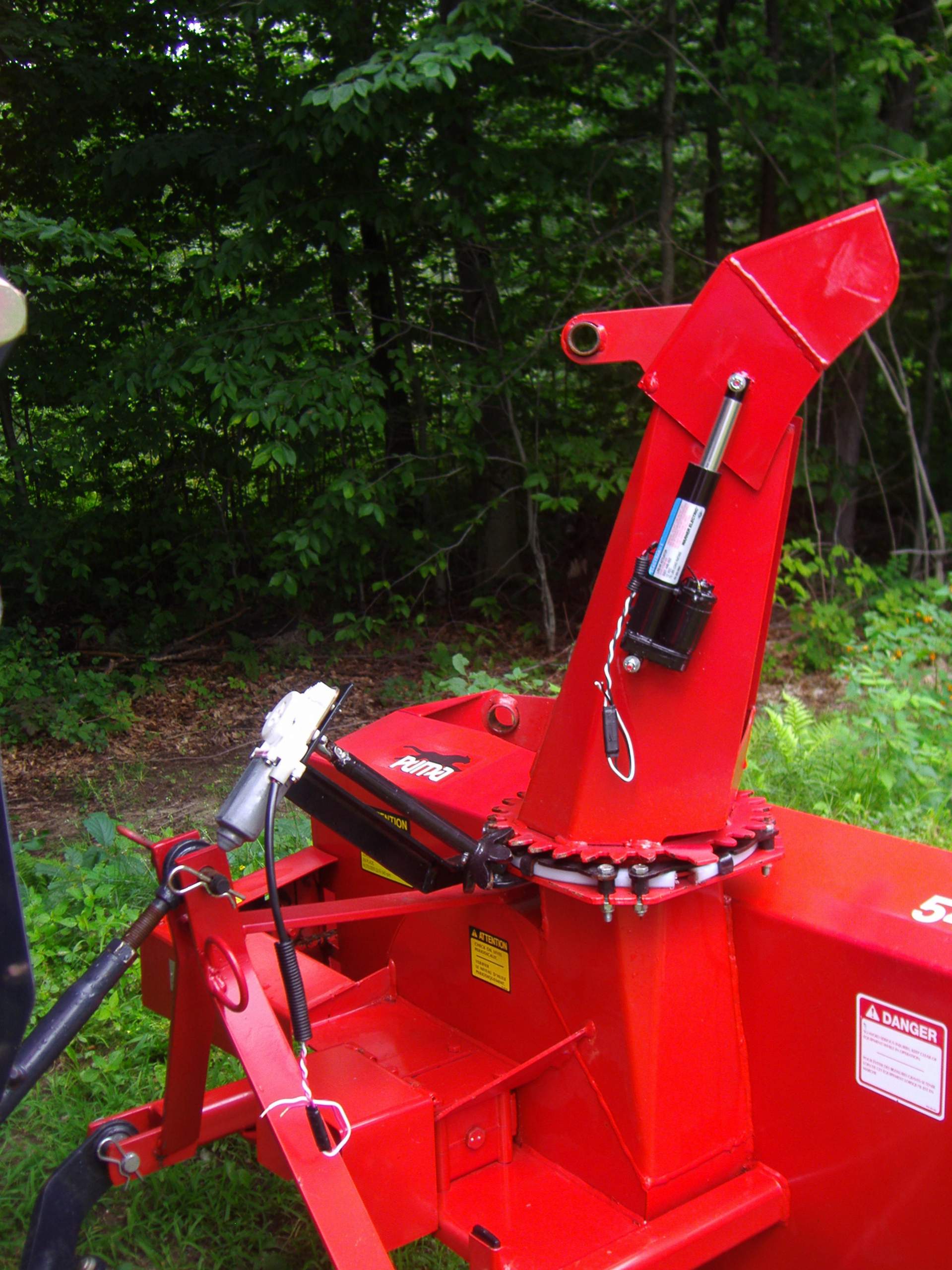

I've got mine almost done. Chute rotates, now the spout has to tilt. Pictures will follow once it's done.

I still have to do some wiring, but here are the pics:

Nice Job! That should come in real handy this winter... Now, for some action shots.:D
