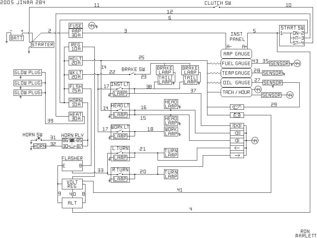

I have started to do some electric work on a Farm Pro 254, Jinma, that I bought a while back. Have completed a lot of other fixes and now to the electric. I had seen on here sometime ago a drawing of the electric circuit that I thought was good and that I could use some day. Now I can't find it. Anyone know where it is. Thanks, Pat

Here you go

Two wires coming out of a harness just above the starter, no. 32 and no. 44. What, where do they hook up too?
   / Electric Diagram #4
On mine, 32 goes to the horn from the horn relay, and 44 goes to a ground point. You can see 32 on the left schematic affordable posted above, about half way down on the left side.
   / Electric Diagram #5
On my 284, 32 is a yellow wire goes from Horn Relay through Connector and then to Horn.
44 is a ground wire.
RonJ
   / Electric Diagram
Thanks, two more wires now hooked up. Pat
