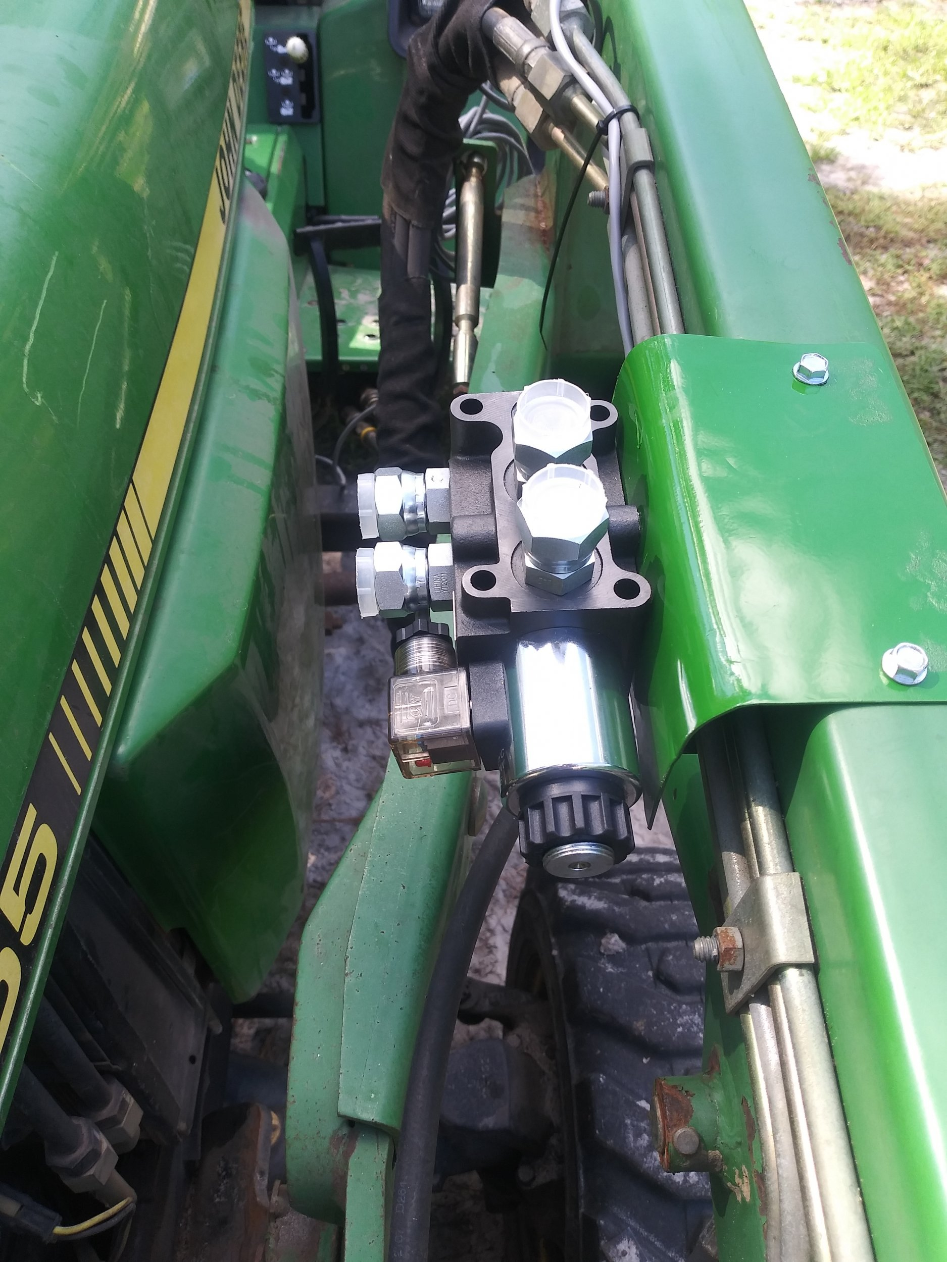

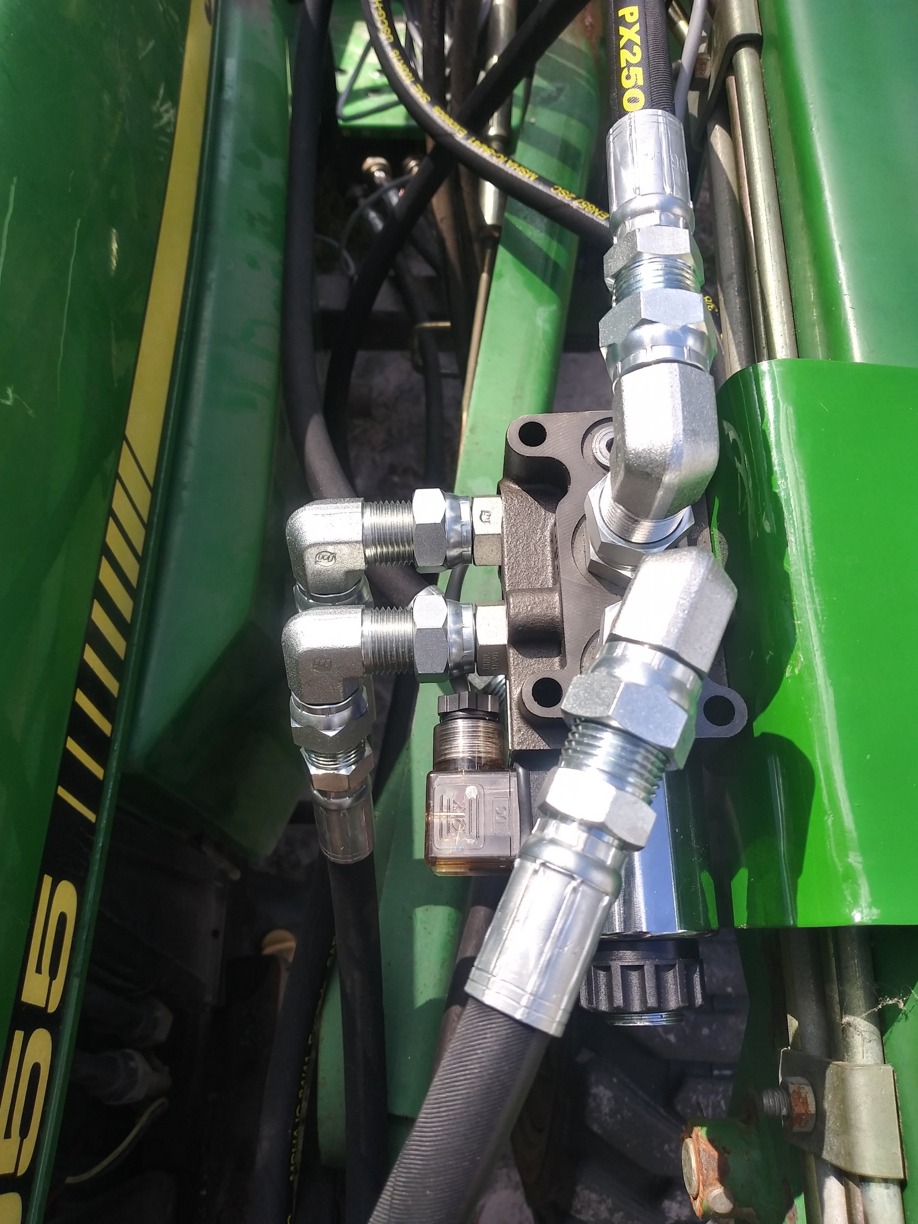

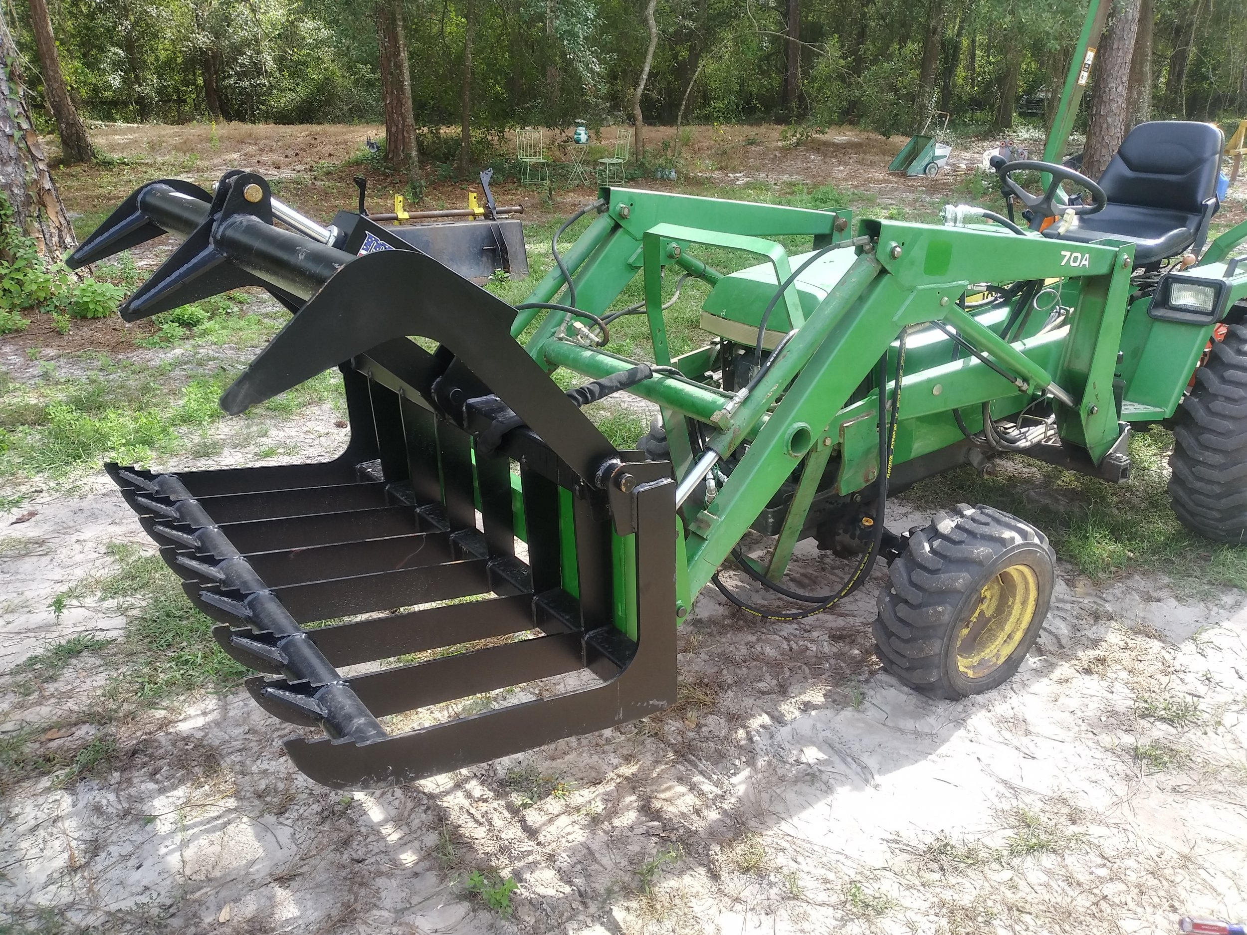

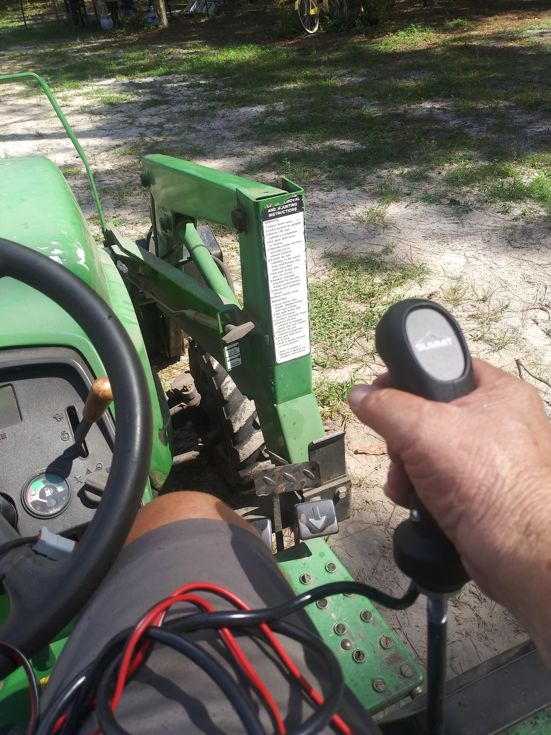

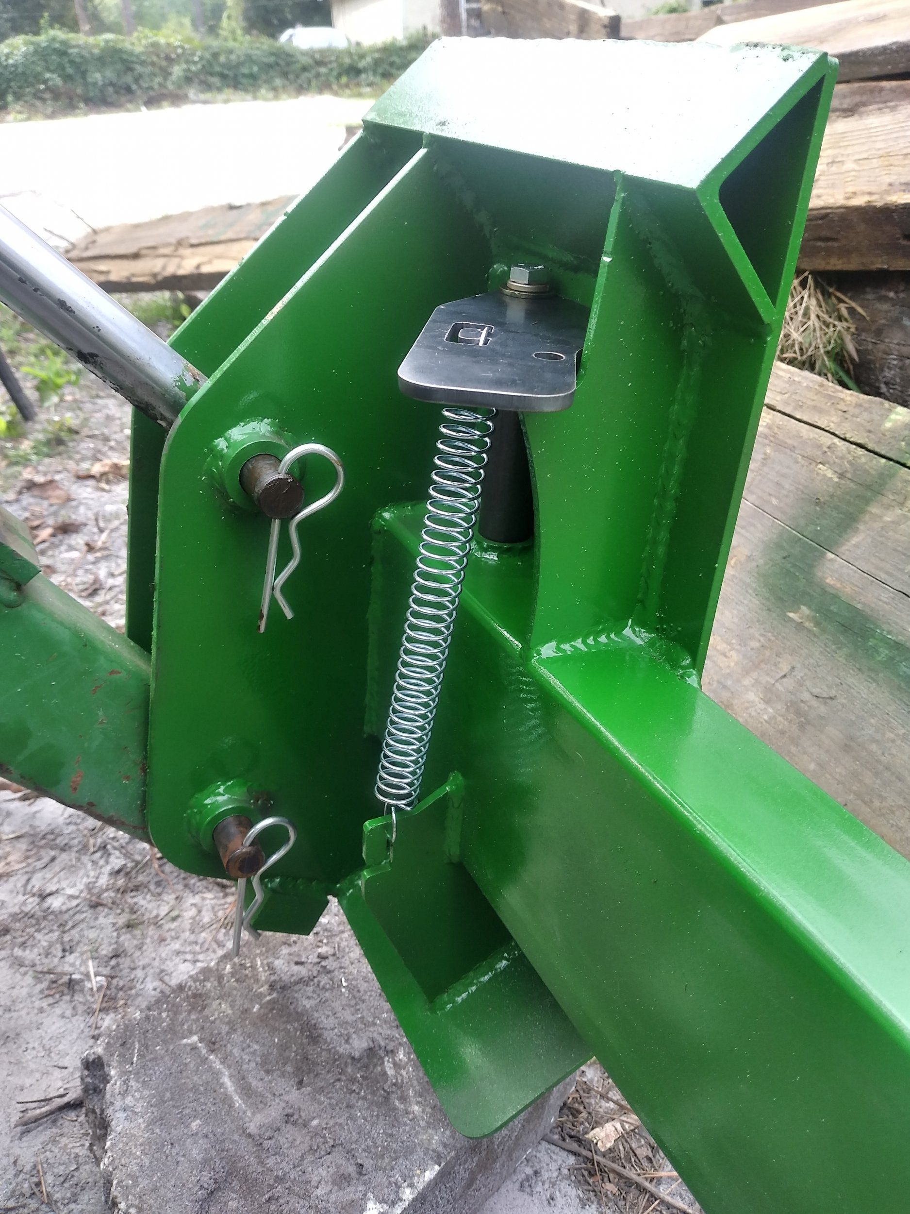

Ok all my beer money is gone. Are you guys happy now? Actually I don't drink alcohol anymore. I just ordered the Summit DV50 Kit. That is what they recommended for my 955/70A loader for right at $380. I will still need hoses, but that should not be that much, hopefully. Now the search for a hydraulic grapple. Should I change the title of my post?

I could not figure how to do that. I have finished my conversion except keepimg an eye out on the hose routing.

/ ELECTRIC GRAPPLE #34
I think you will be happy that you went hydraulic.
To start a new thread and link....just start a new thread. Then open this thread and copy the address bar at the top and paste it in the text of the new thread.
Zip ties work well for securing the hoses going to the grapple. They (the hoses) need to be long enough to allow full dump and curl....but you dont want them dragging the ground or getting snagged. Zip tie them to the loader.....but the hoses are stronger than the zipties. So if you DO snag something....you bust a few ties and not the hoses
