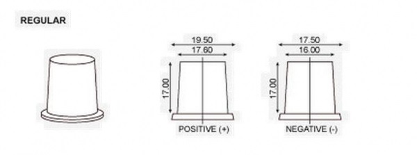

I purchase a Ford 8N some time ago. I removed the 6v battery without noticing the way the battery was hooked up. Do you hook the red cable that comes from the stater/solenoid to the positive post on the battery or hook it the neg post. I have forgotten most of what little knowledge I had about this stuff. If someone respond's to this please detail the information.

The old 6 volt 8N Fords were Positive Ground.

The n's all left the factory 6 volt, positive ground and are best left that way. Hook the red (ground) cable to the positive post of your 6 volt battery. If the tractor starts good with the factory 6 volt system, you know the engine is in pretty good shape and has good compression. 12 volt conversions were often done to help worn engines start easier and are a "red-flag" to most collectors.
THANKS IN ADVANCE.
The battery posts are different diameter, positive is slightly larger. Match the cables to the size of the posts.
