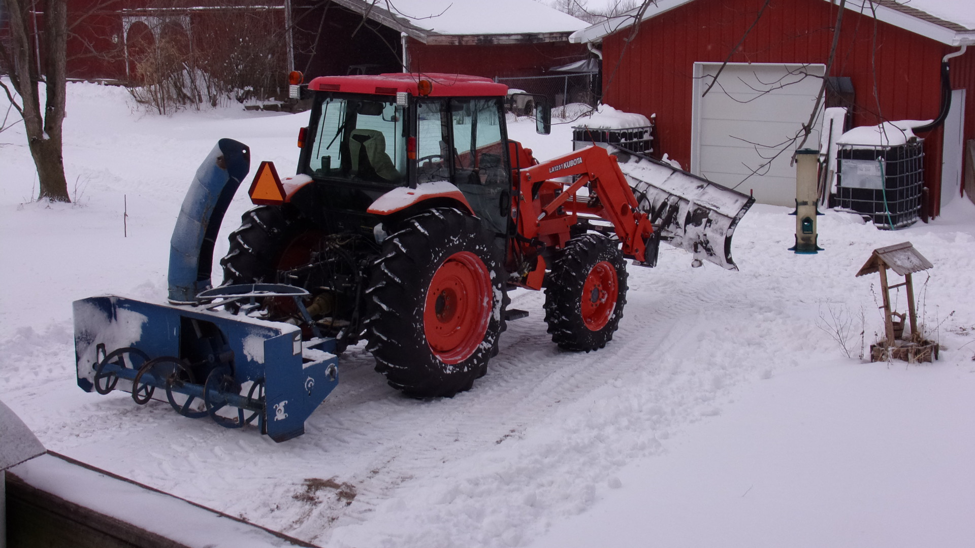

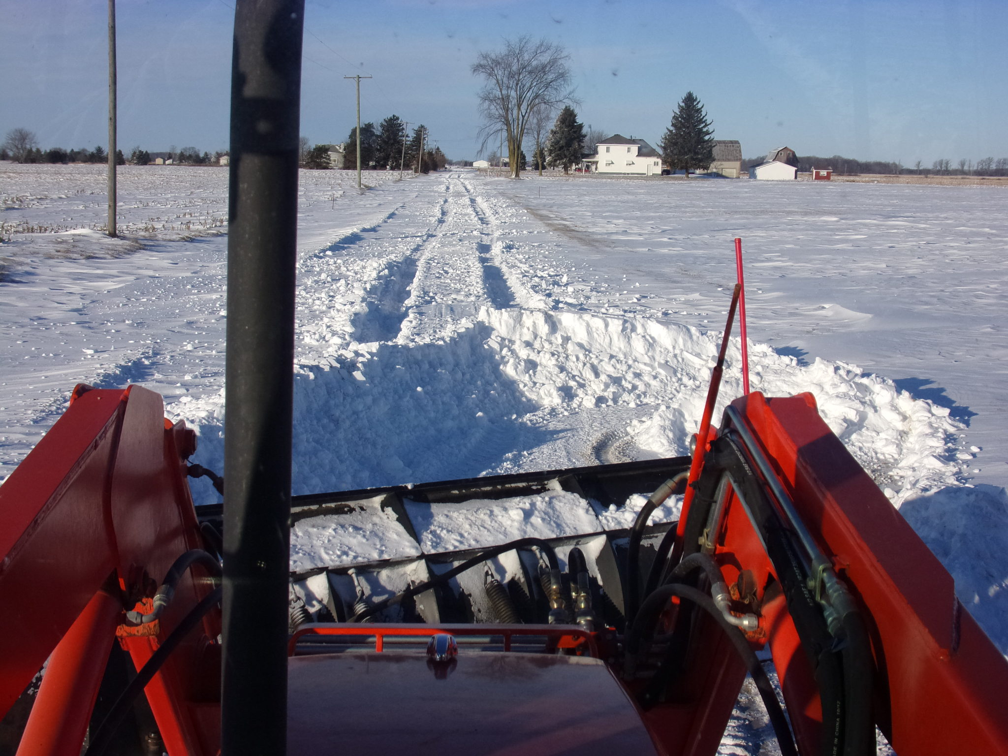

In reality however, both my Kubota M's reside in an unheated barn with no electricity and it gets pretty darn cold here in the winter so I'll go out and fire them up and go back inside and have a warm coffee while they are on fast idle and by then the fluid is warm enough to run them... Never had an issue. I plow snow with them. Have to keep the drives and road open.
