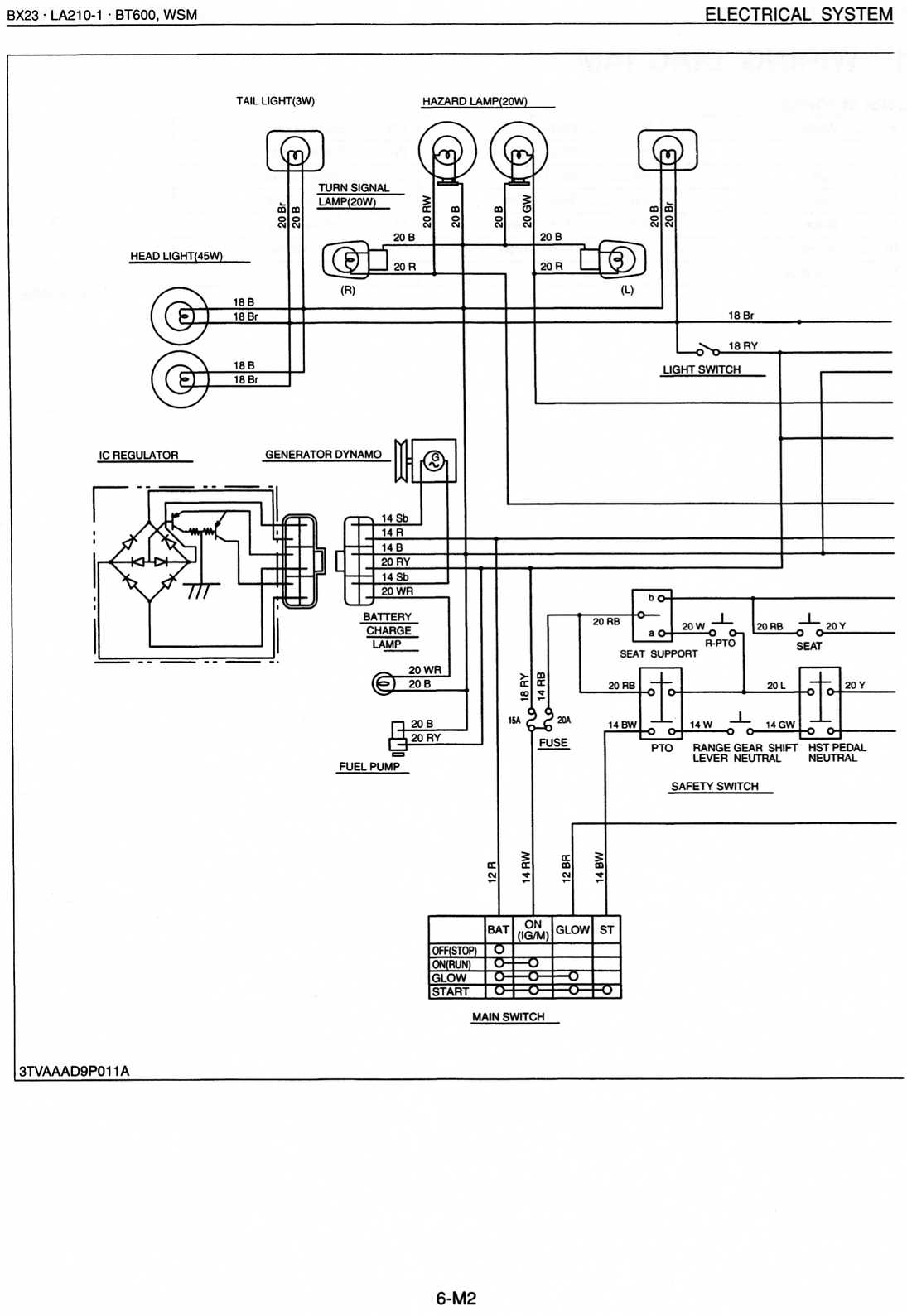

kubota bx2230
Have a 2003 BX2230 that belongs to a friend...went there last night & found the battery is fully charged, but when I turn the ignition switch on, there's nothing (fuel gauge doesn't move, no lights on instrument cluster). Checked the small group of fuses next to the batttery & they all seem fine. I don't have a wiring diagram for this thing, so I'm kinda in the dark now...anyone have a diagram they could post??

/ electrical issues...

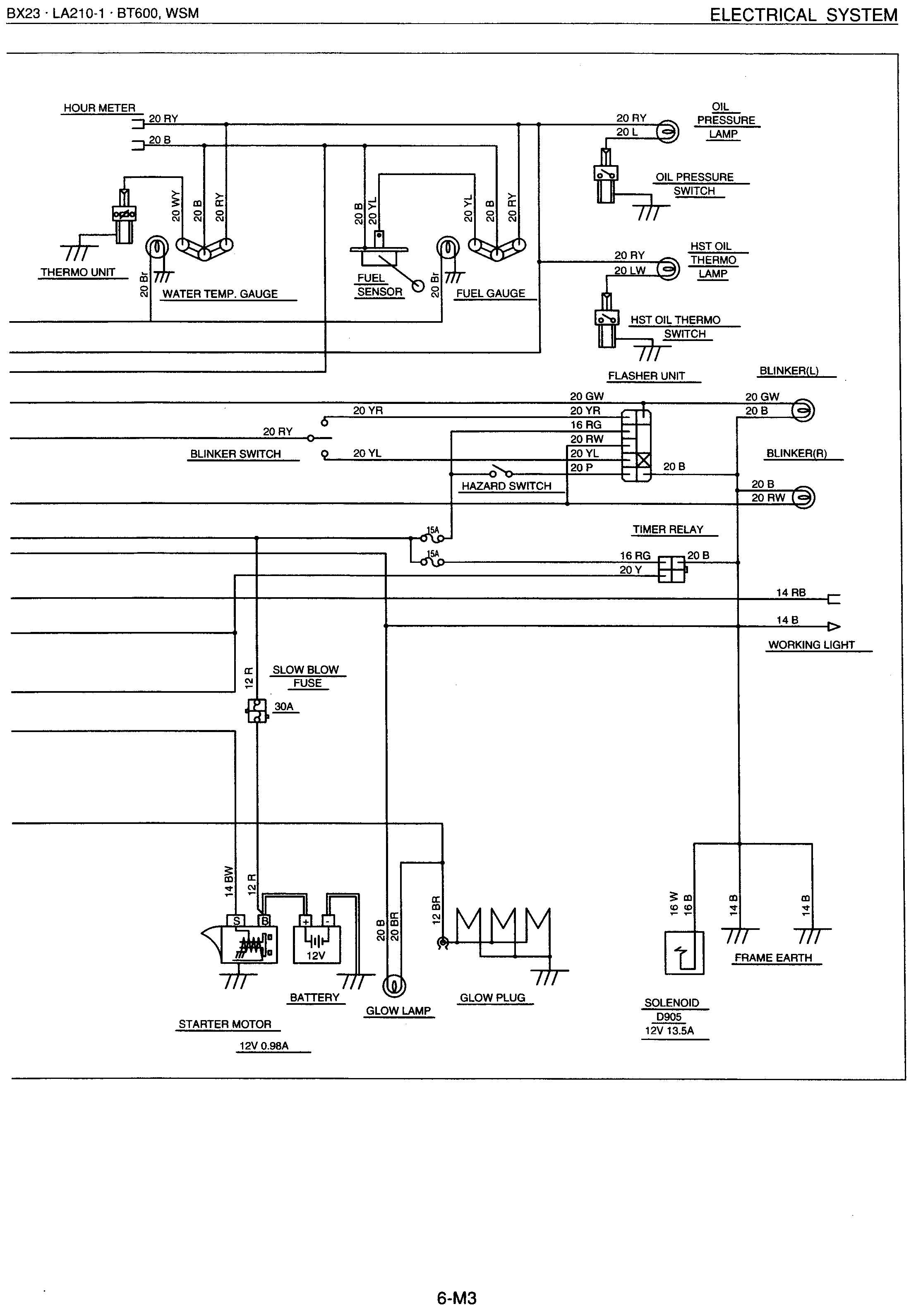

Problem is, I have NO idea what should be hot, & what isn't....I can start testing things at random, but was hoping somebody had a diagram of this model, or a similar one....

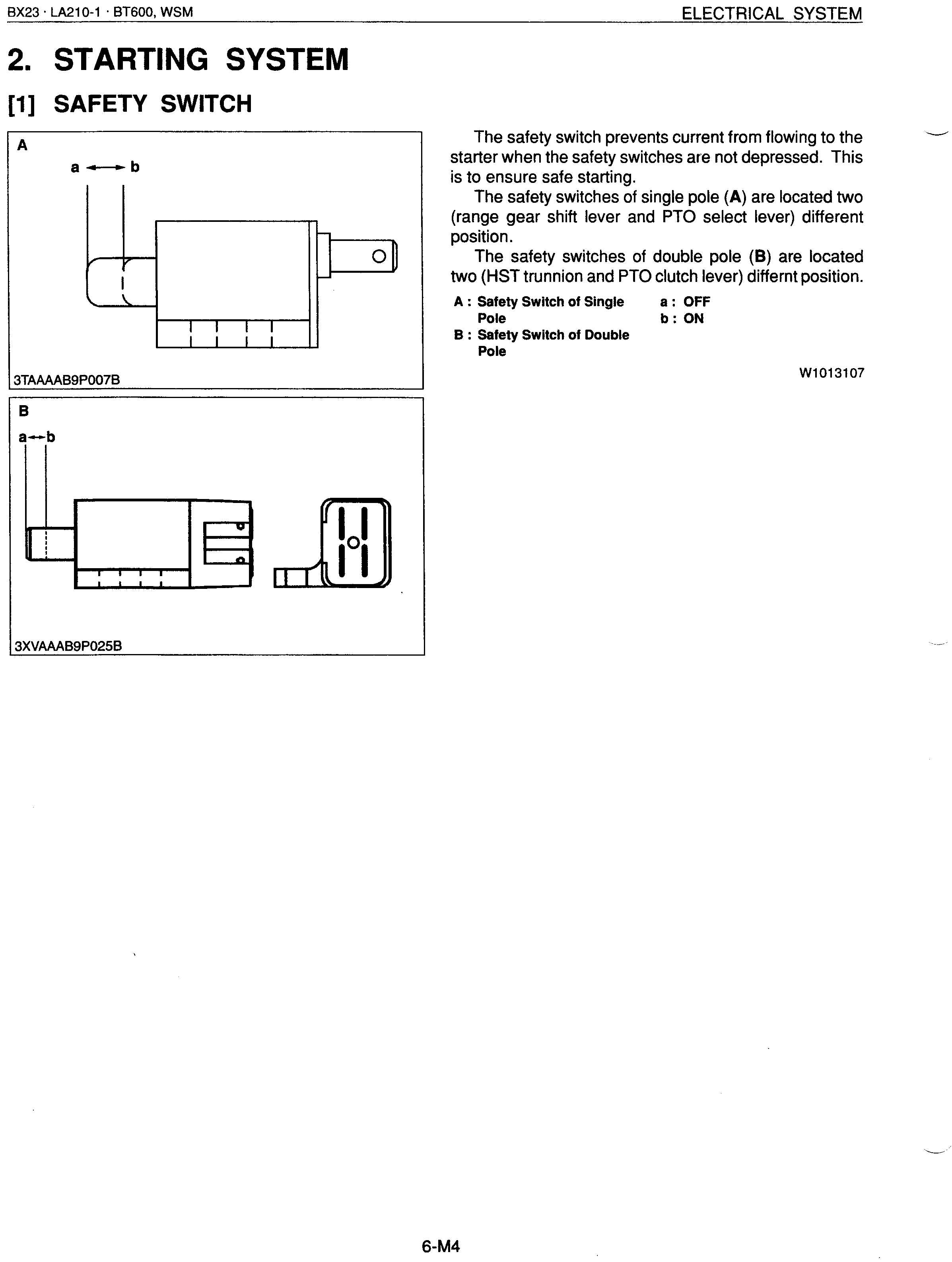

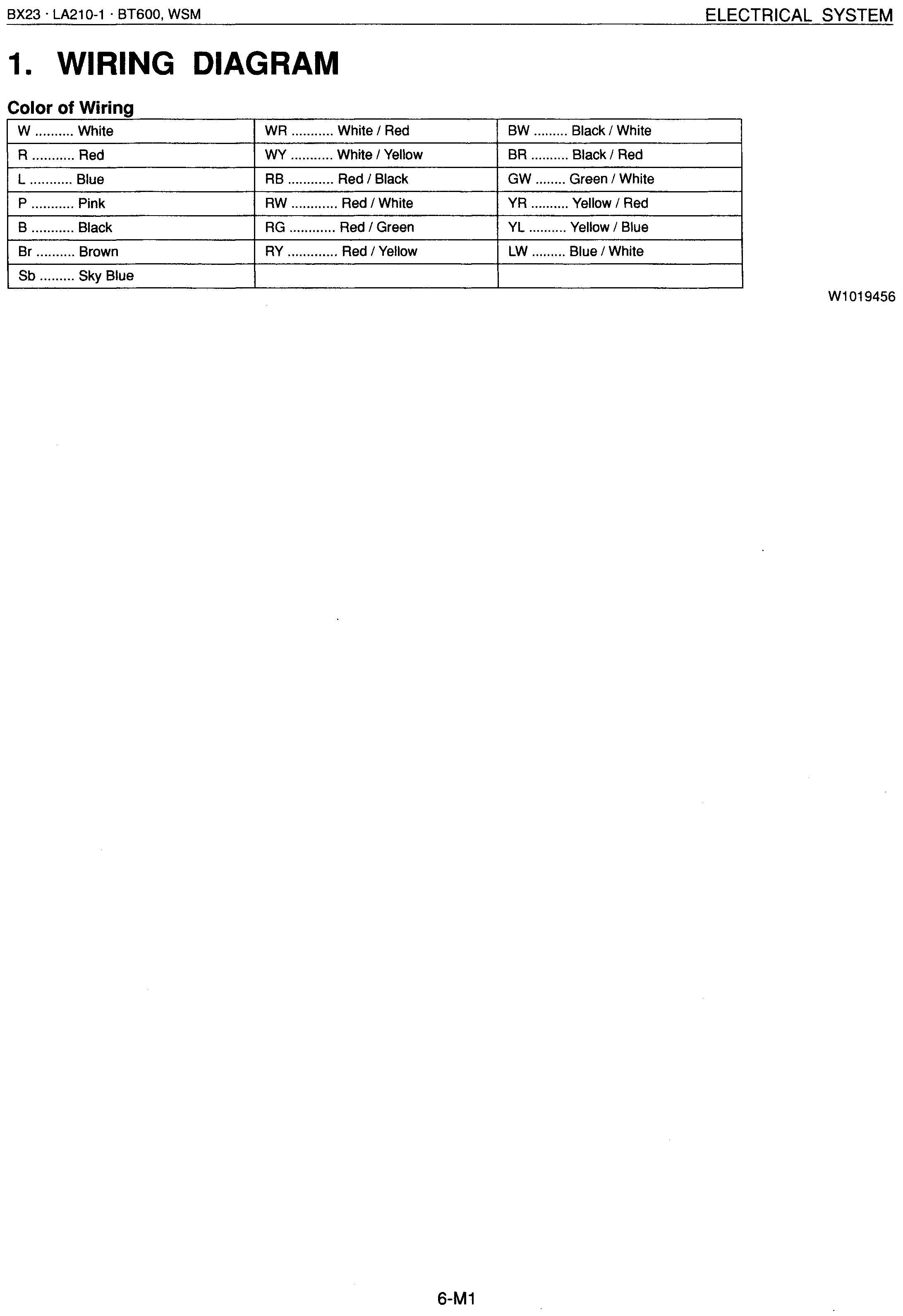

/ electrical issues... #5
BX 23 wiring diagram
thankyou thankyou thankyou!!!!!!!!:thumbsup:
It ended up being the 30A "slow blow" fuse in the engine compartment...Fortunately, Toyota uses the same fuse in their trucks & I stole one out of my friend's 92 Pickup to verify that fixed it....
