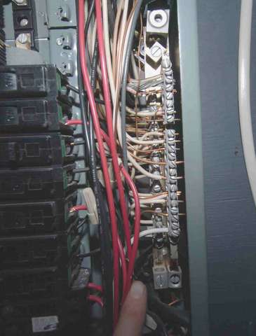

Hi guys.
Evaluating what I have in my panel in planning for few new circuits. Popped the cover of the panel and was suprised to see (what I think) is the neutrals and ground wires all connected to the same bar...at least thats the way it looks to me.
Last panel I looked at grounds were all on one side and the neutrals on a seperate bar on the other...comments?
edit: On second thought, I am wondering if I am thinking about a sub-panel where the neutral and ground are on seperate bars...and they are on the same bar in the main?

You are correct. The neutrals and grounds are connected at the main panel but they are not connected at any sub-panels.
   / Electrical panel picture - is this normal? #3
You are right on your second thought.
   / Electrical panel picture - is this normal? #4
Must be right as it passed the electrical inspection. There was an electrical permit taken wasn't there? /forums/images/graemlins/wink.gif
   / Electrical panel picture - is this normal? #5
You are correct, if this is the main panel and not a sub-feed panel, this is normal. In a sub-feed panel the neutral bar is insulated from the sheet metal of the box.

I really don't understand electricity at all. The neutral and ground are tied together at the electric pole. What difference would it make if the neutrals and grounds are separated inside the panel or not? That is unless you have a separate ground rod for the ground bar.
