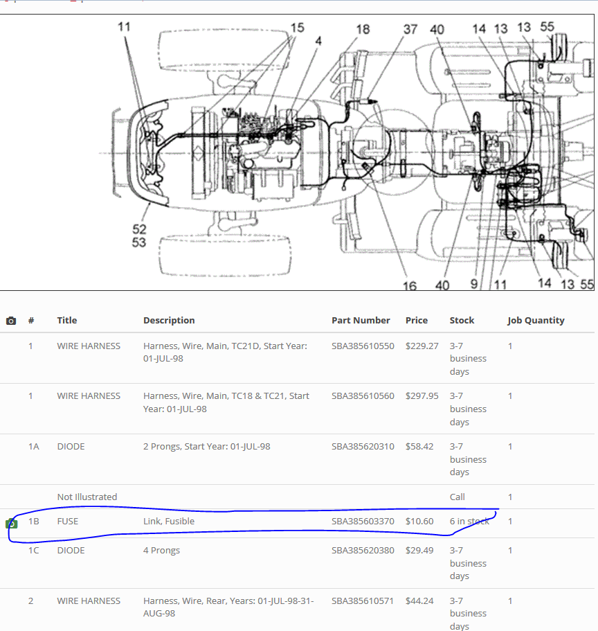

My 2000 New Holland TC21D stop running, battery is good ignition switch tested okay, when I turn the key on I get no dash board lights. I am sure it is a relay just not sure which one or how to locate it with out a schematic. Any*ideas? Thanks

Have you cleaned tightened all FOUR battery cable connections? Sometimes ground(negative) battery cables connections are overlooked only to determine they were the problem.

TxJim, thanks for your replay. I changed the negative cable and cleaned all the one you referenced. I talked to NH this morning and they said it might be a linked fuss located near the starter but I can't find the dang thing. The search goes on. Again thank you.
/ Electrical problems #4
My next guess would be the fusible link that Messicks stocks 6(six) of which indicates fusible link is a high turnover parts item.
