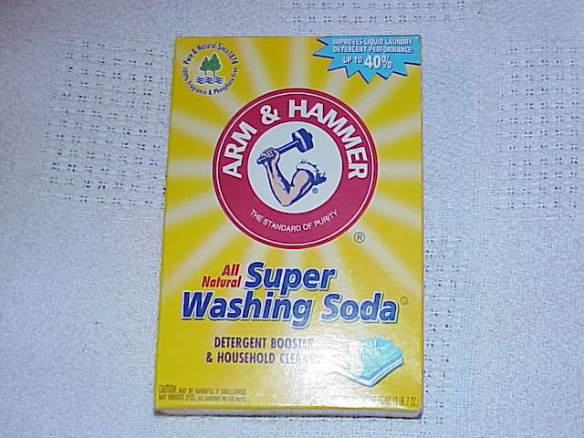

I have went to each store that I could think of and all Arm & Hammer washing soap has backing soda in it and all the other things that sell soapand guess what it will not work. In my search I looked fore Lye and came "0" I hope some one can help me with a solution I have a large projest and I did not want to sand blast PLEASE

I've been able to find washing soda in the local big grocery chains. The Arm & Hammer Washing Soda is what I use. The ingredients list should show "sodium carbonate". Baking Soda is "sodium bicarbonate"

As stated, PH+ pool chemical is sodium carbonate. Any pool store will have it.

This is what the box looks like.
