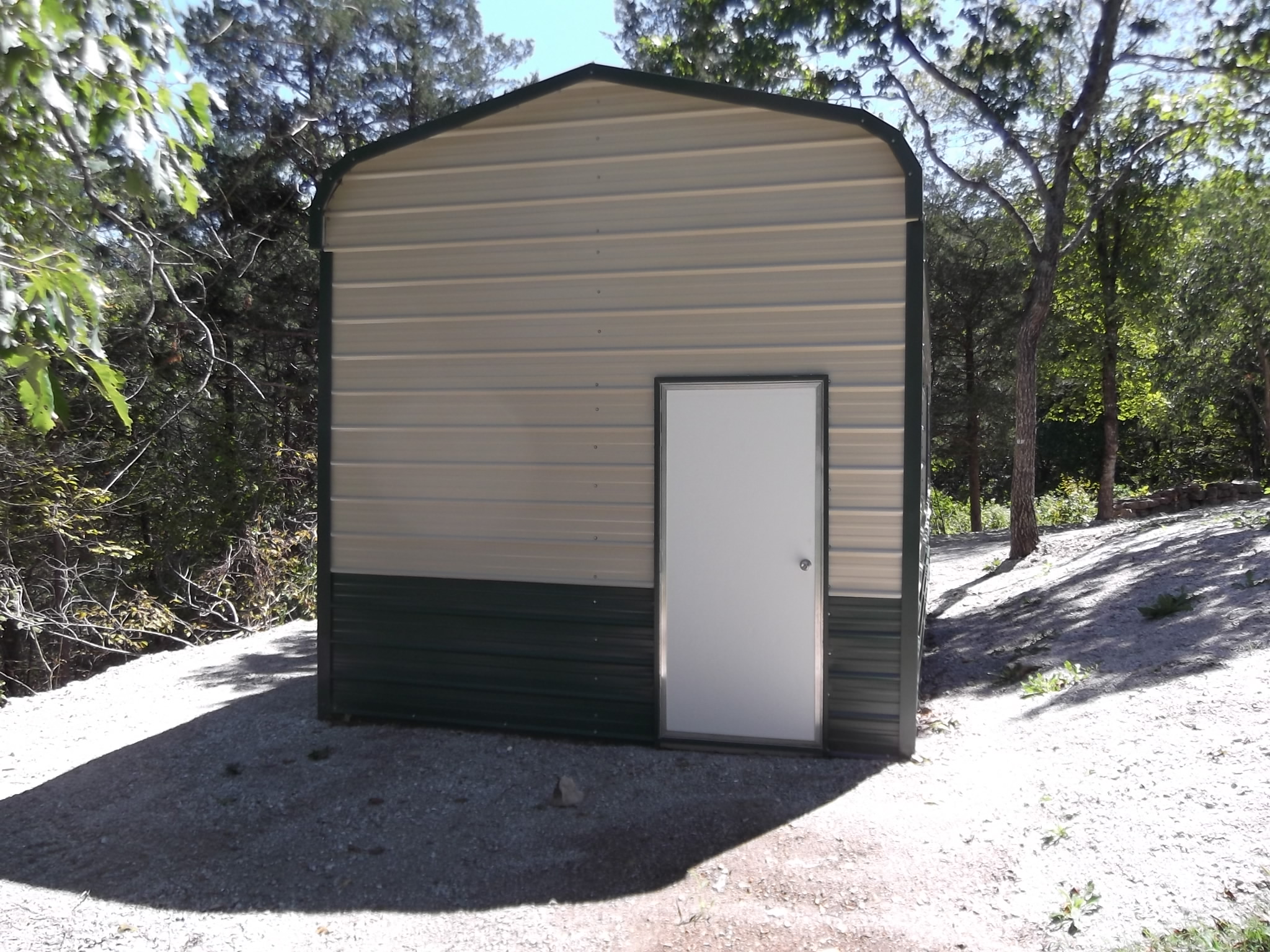

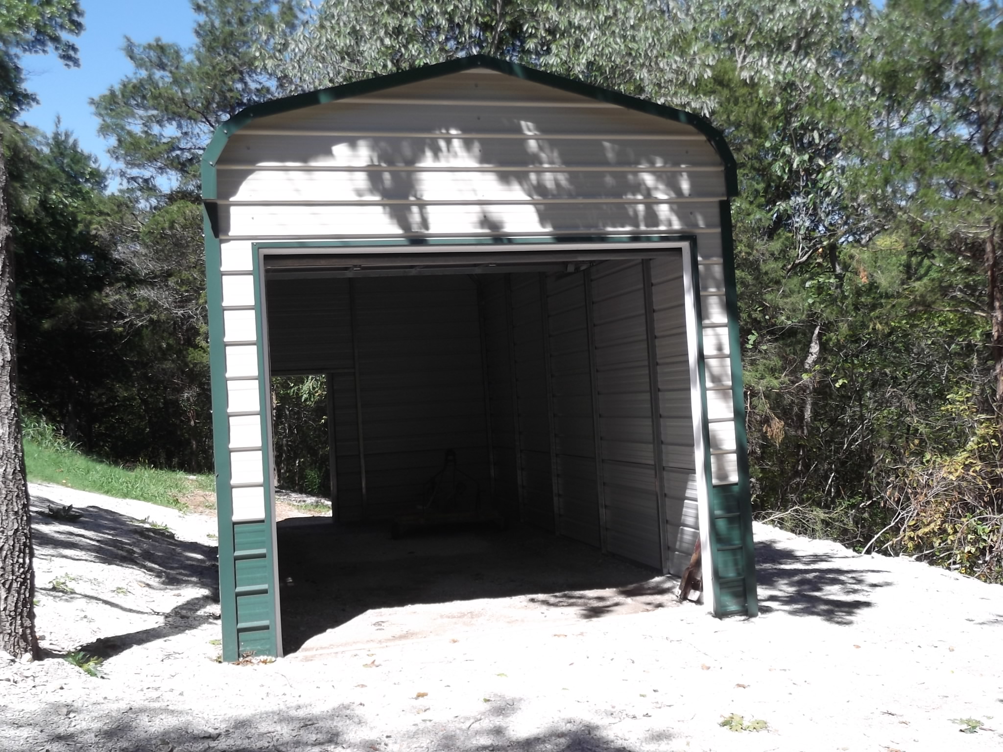

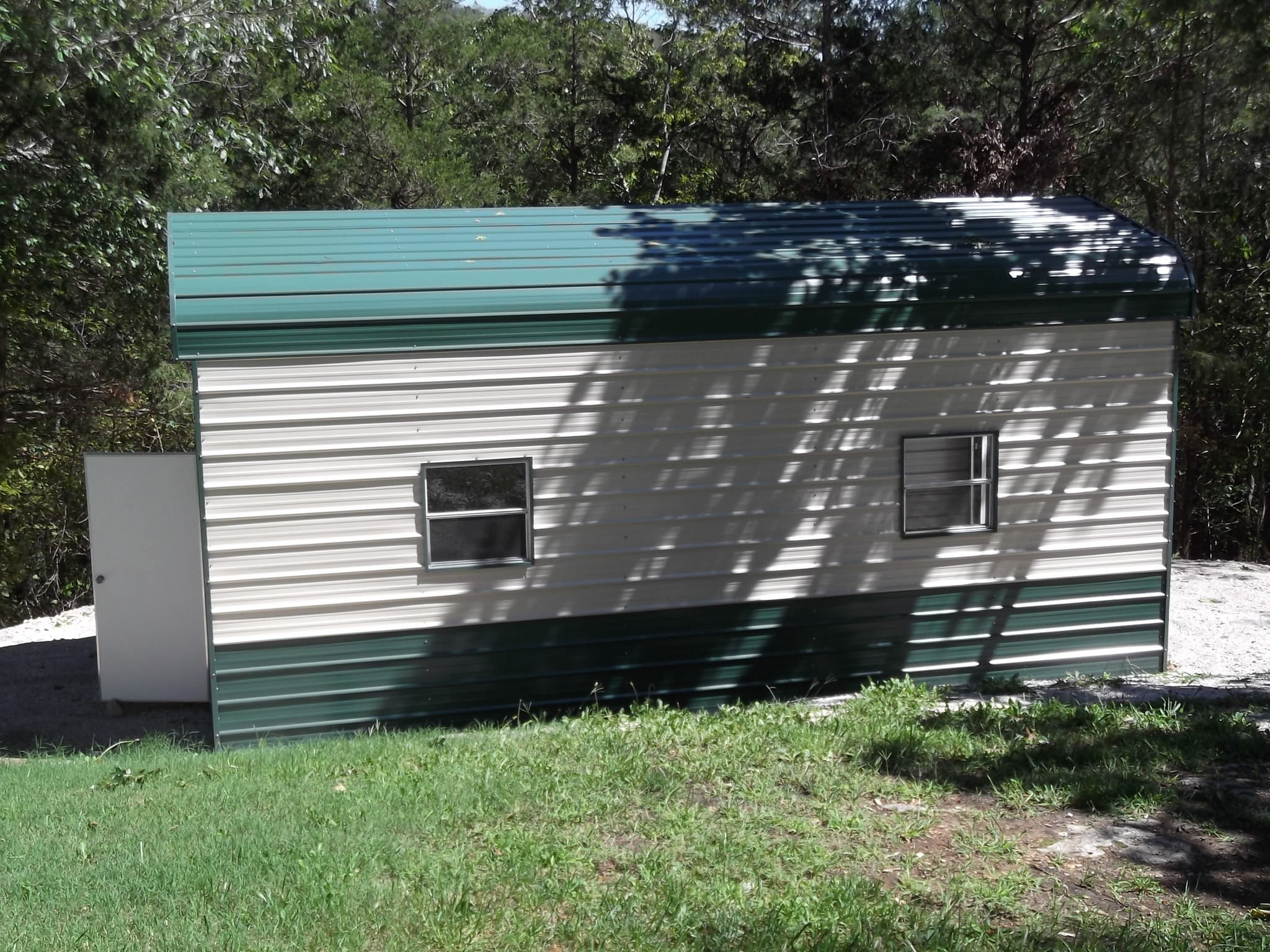

Don't try to match it, use a contrasting color that pleases the eye.
