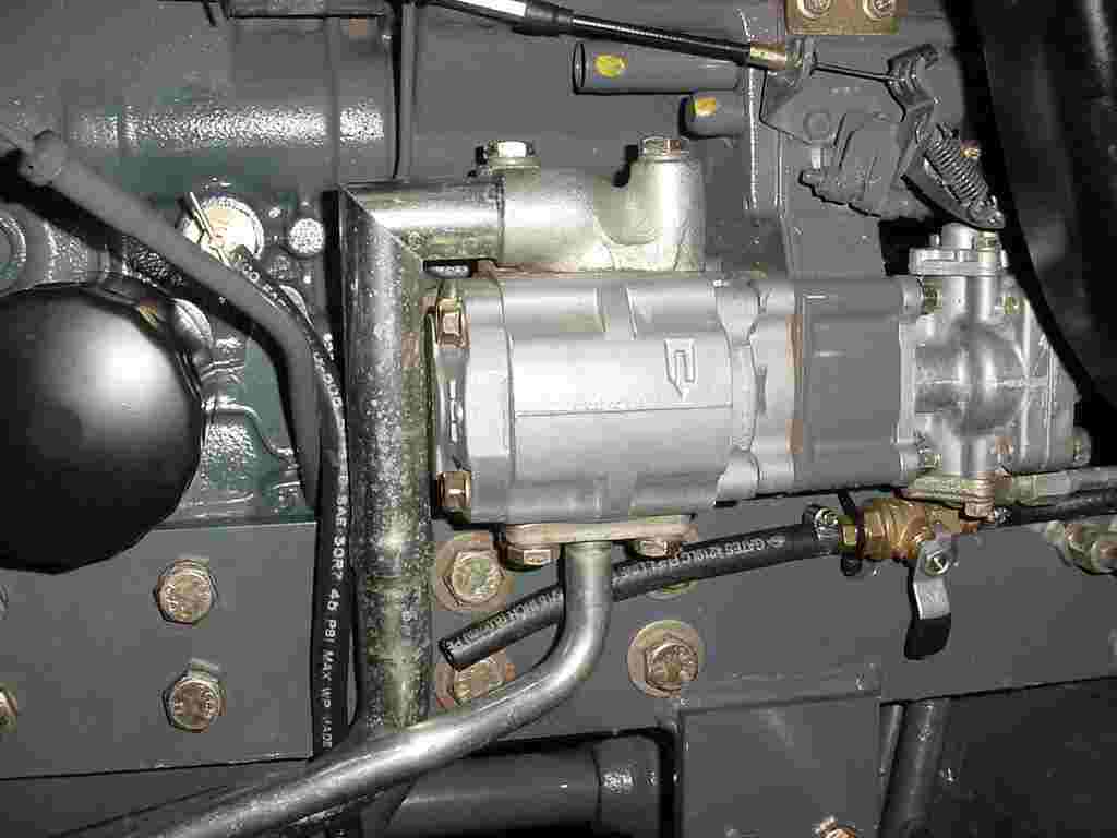

For all Ford and NH Tractor Owners with the infamous leaking block!
I put up with it for years on my Ford 1720 and for almost 4 on my TC 40D. I tried several fixes, including new plugs, teflon tape, blue silicone sealant, pipe dope, etc, all to no avail. ...But, I think I've got it by-golly. /forums/images/graemlins/cool.gif See the pics, but here is what I used, 3/4' NPT brass insert, 3/8" brass insert, and 1/4" brass valve. Could have just used the larger insert, but couldn't find a valve to fit. I imagine there's several other combinations that would work, but this is what I came up with. Key is getting a fitting into the block that fits and seals. I know some folks have said the thread might be British BPI threads, but NPT worked and sealed just fine, so I'm not sure. There defineately was no binding or gauling going in. I used a double wrap of teflon tape on each fitting. The problem with NH's fittings are that you have to have the right-angle drain line connection point facing down, for the drain to work very well. In the case of my old 1720 and in an even worse case with my 40D, the plug would get almost impossible to turn, just at the point where the drain line connection was facing almost straight up. So, you had to turn it in a little less, and then it leaked. I even ground a slot in a socket, 15/16" or 24 mm, or something like that, specifically so it would fit the odd fitting. I'm not sure that even if I were to have gotten it turned all the way around, it would have sealed long term as NH has had so much problem with these. Anyway, some additional pics also follow.

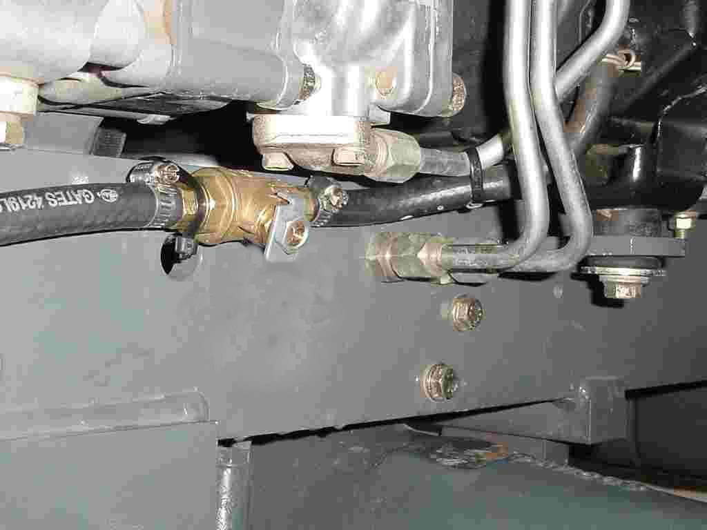

Some more pics. This one is of the other portion of this "drain system" NH came up with. I didn't like the valve at the radiator end, so I came up with this instead.

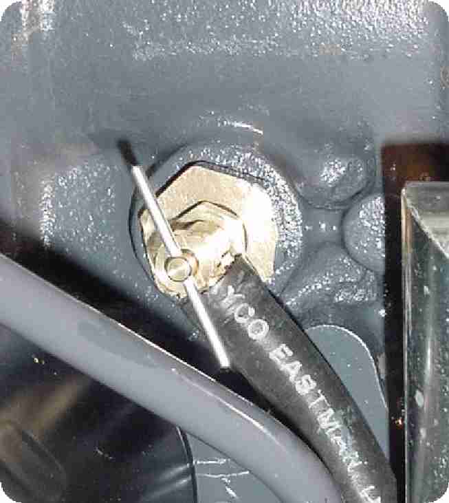

Here's my new "drain-system".

Nice work!
Any concerns that some brush might turn the valve to the "drain" position? In your 2nd picture where the hose connects to the radiator.. this is where some brush had pulled the hose off for me.. I replaced that "wire" clamp. Pull on it and see if it comes off easy.. not good.
Wow.. your tractor is so clean!

... so clean." Ah, just a false impression. I spewed quite a bit of fluid when I removed the old fittings and so hosed-off that side of the tractor to get rid of the residue and also clean up around the fitting in the block for painting. I've messed with this so many times, I'd scraped the paint off the block, frame and dipstick and some spots were beginning to rust. You're seeing fresh paint around the plug, although when I tried to reduce the size of these .jpg photos, the colors and resolution of the pictures seemed to affect the clarity, so it might not be so obvious.
I'm not overly concerned about opening the valve with a snag because it's pretty well protected up in close to the engine. Also, I positioned the valve so it would take a branch/brush pulling the valve forward to open it, which I'm not inclined to go. Also, I shortened the stock handle on the valve so it's just long enough to still turn fairly easily. Most of my brush clearing work is done with my hog and I back the rear of the tractor into things.

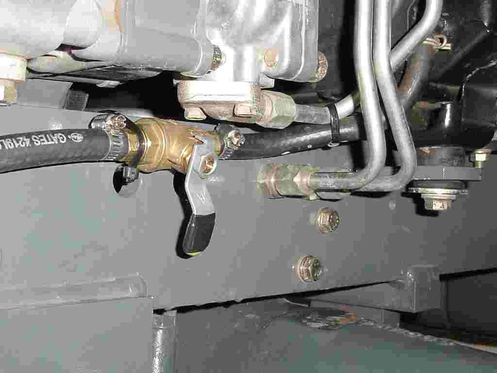

djradz your modification is an excellent idea for solving an old problem. The only thing that I might recommend differently is to simply modify the valve handle like my picture then use a crescent wrench for easy access. That way you would never have to be concerned about anything accidentally catching your original handle.

I like it. Great idea! Now there's nothing to catch on.
