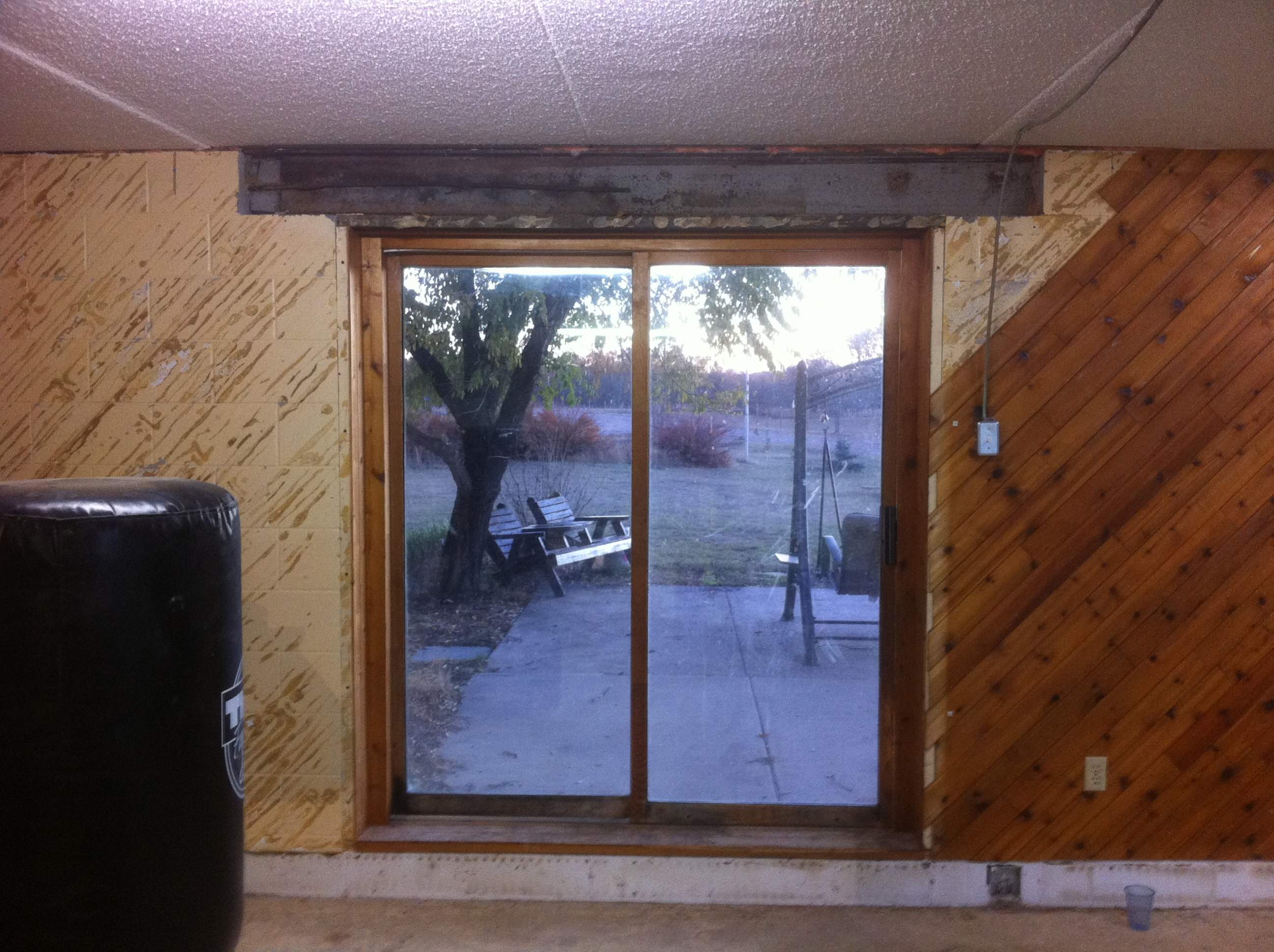

Hi there everyone,
I have a small tractor ( Massey Ferguson 2400 ) and a couple of atv's that I'll need to do service work on during the long Canadian winter. On my property, I have a 35' x 90' cindercrete/concrete structure that use to be the old residence that I am converting into a workshop/gym/man cave. This structure is an earth shelter about 8' high inside with a concrete slab roof. I am having a 6x7 overhead garage door installed so I can drive the tractor and atv's into it ( and maybe the motorbike so it stays warm and cozy ).
Since I don't feel like dying from carbon monoxide poising, I was wondering what options are out there for venting the exhaust from running engines to the outside? This is only for occasional use ( maybe during warmup while its -40 outside ) or the times when I need to run the engines during servicing.
Thanks for any input you can offer!

6x7 door is as big as I can go without making some structural changes. I'm taking out an existing sliding door to replace with the garage door. I measured my tractor and with the backhoe outriggers, I'm around the 5' width. I will need to take down the ROPS when the tractor is inside the building.
I really like the idea of the flex hose and inline blower. I'm going to look into that some more.

Hi there everyone, I have a 35' x 90' cindercrete/concrete structure that use to be the old residence that I am converting into a workshop/gym/man cave. This structure is an earth shelter about 8' high inside with a concrete slab roof.
Wow! From the photo that looks way to nice to be used for a garage. We had an earth shelter house in Florida and liked it better than any other we've had. It was so quiet and the temperature remained so constant it almost never required heat in winter and we never worried about storms. We really miss that house but $$ talk and we had another house there anyway.
