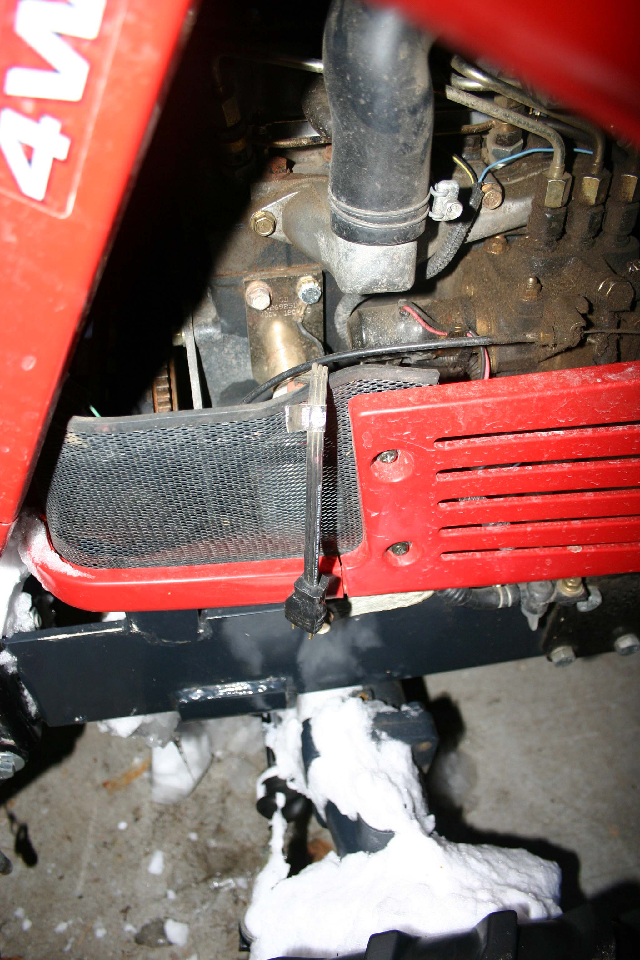

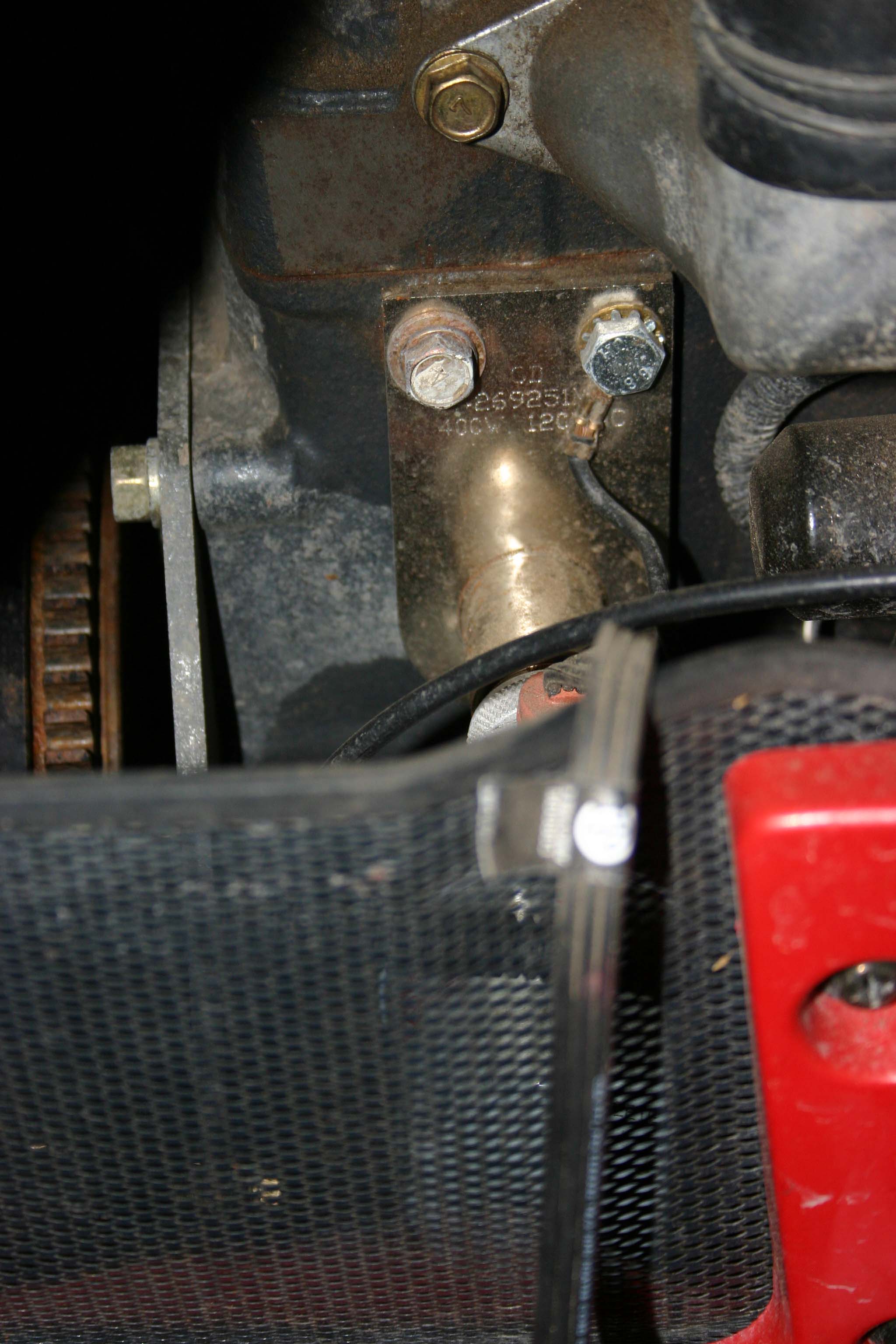

I'm not sure if the photos will attach, but this is how the Massey (AGCO / Iseki) part is mounted. It goes right above the oil filter. Works wonders here in northern Minnesota.

Hey Buckwheat; I really appreciate the post with photos, now I can get a better idea of the mounting & understanding of the higher cost for the unit. Do you leave the unit plugged in all the time during cold weather or do you plug it in a few hours before use.
