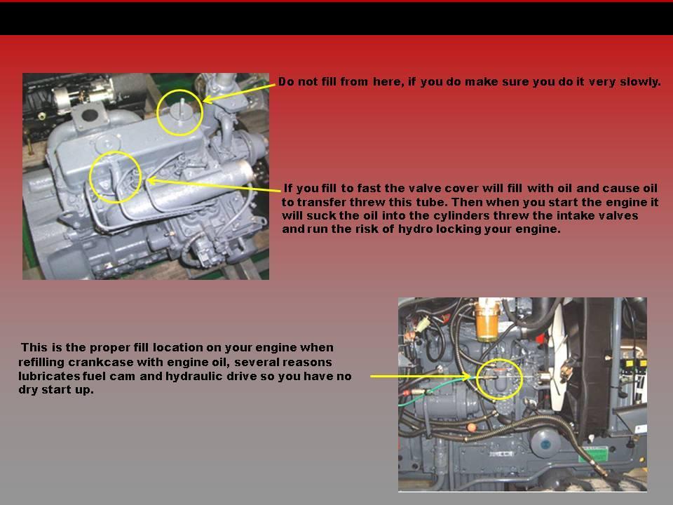

I searched but couldn't find -- I thought I remember someone warning when adding engine oil to add it to the engine in a particular place that is NOT the valve cover as it can cause some kind of damage? I haven't looked at engine or manual (maybe there isn't even a valve cover opening) -- is there a filler tube? I just thought I remember a horror story about adding oil through the valve cover or somewhere at the top of the engine and it wrecking something due to oil being up in the head or something. Any truth to this? (yeah I'm overly cautious ... it pays to be paranoid sometimes!)

Do not add the engine oil to the valve cover fill location, it will not drain to the oil pan fast enough and can cause engine damage. See attached picture
As for the oil from Tractor Supply as long as it is a Universial tractor hydrulic oil that is suitable for hydraulics and brakes you should be fine, is it a 303 oil or UTF? Oil Fill CK.JPG
As for the oil from Tractor Supply as long as it is a Universial tractor hydrulic oil that is suitable for hydraulics and brakes you should be fine, is it a 303 oil or UTF?View attachment 356273
The newer CK20s don't have a side fill. They only have a valve cover fill location.

Roger on the valve cover fill
   / Engine oil add location CK-20H, Tractor supply HST oil #7
I filled mine through the top in the rocker/valve cover. No other place to do it at, unless I suck it in through the drain hole, and don't see that happening.
   / Engine oil add location CK-20H, Tractor supply HST oil #8
Why would an engine mfg put a oil fill cap on the valve cover (normal place to fill on all car engines) if it would damage the engine. Who pours in a gallon of oil so fast that it cant drain into the sump? Anyway, it looks like Kioti corrected the problem and eliminated the side fill which is backward from what I would have done. I would have taken out the valve cover fill hole and left the side hole where it would go directly into the crankcase. This would have facilitated more accurate gauging of oil level when filling rather that waiting for oil to drain down, although I wouldn't see this as a problem unless the oil was very cold and thick, like below 0F or something.
