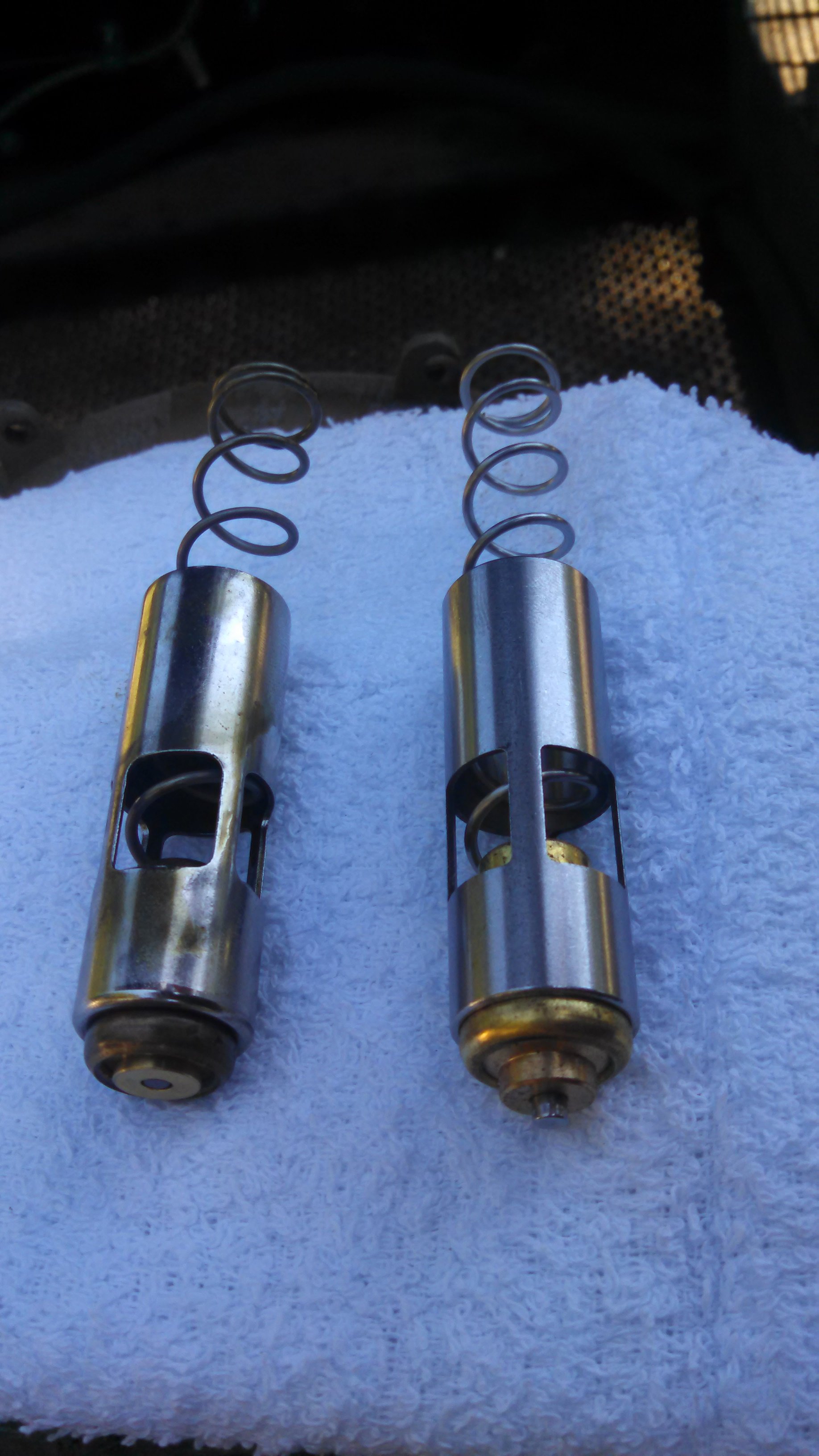

So bringing this back up with what I believe is my solutions, and some warnings to all.
I bought the replacement thermostat as recommended. As a note, the plug for the thermostat is a size 12mm hex and do not torque beyond 50lbs. When I removed it, the outside had a film on it. Not oily but more sludgy, like the inside of an oil filter. I sprayed it down to clean it and as you will notice, there is quite a difference
On my new one, the little button was out, and it is clear the secondary cap was stuck in a bit. So I cleaned it all up and reinstalled. But I had not addressed the oil cooler. So I took it off as well. I grabbed my can of parts cleaner, flipped the cooler upside down and filled it up and let is sit for 20 minutes. Gave it a vigorous shake and poured it out. Definitly dark oil but no chunks. I then grabbed some simple green, poured it in and let i sit. dumped it and then flushed with water.
I then blew out and hosed the fins as I would if attached to the tractor.
That is when I realized my issue. Looking in between the fins, there was dirt. Now I look with a mirror and paper but you really can't see how obstructed the fins are unti you get your face right into it. But I had a certain amount of blockage. Out came the pressure washer and it took a number of passes to where I felt I had a good clean fin system.
Bolted it all back together and took the tractor down the hill for some serious road grading. Temp stayed way down. While i won't know until I mow, it looks like problem is fixed.
The big note I wanted to give in all of this was that the fins have looked clean to me for a while, but it wasn't until the cooler was in my hands that I really saw how congested they are even after normal air blowing.

Not sure why the picture did not come up.... Old on the left, new on the right
