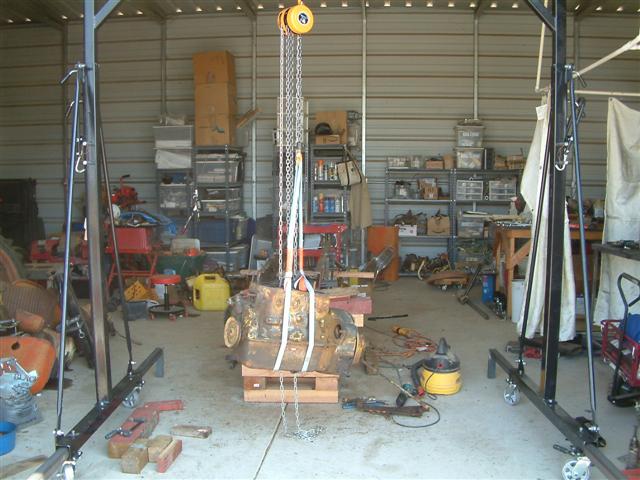

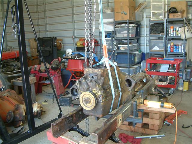

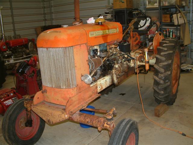

I like to handle engines with a bridge-type gantry crane (mine is a $500 from Harbor Freight--1 ton capacity). Here's it in use when I disassembled by 1951 Minneapolis Moline BF tractor for a complete restoration.
Good luck.
