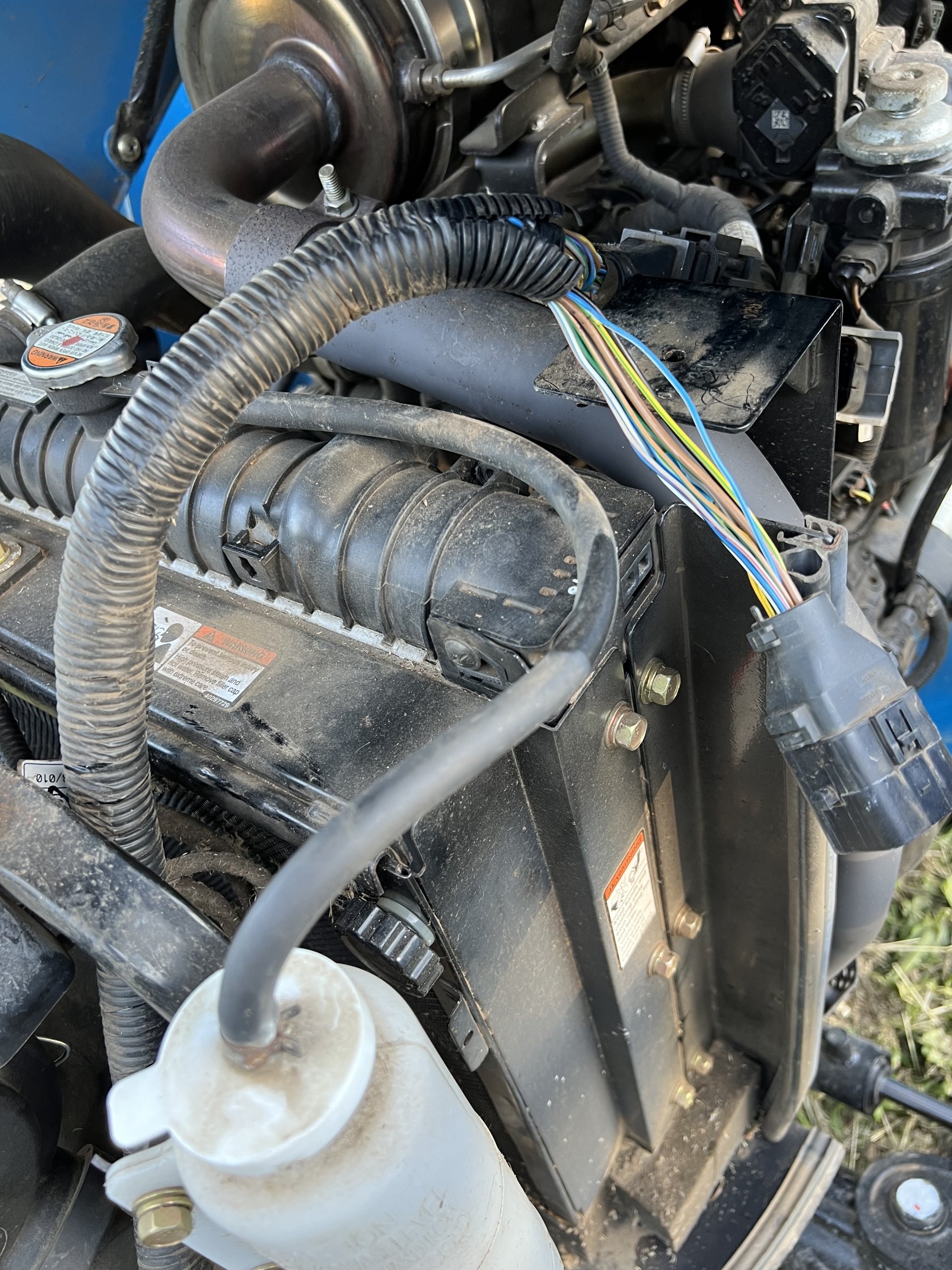

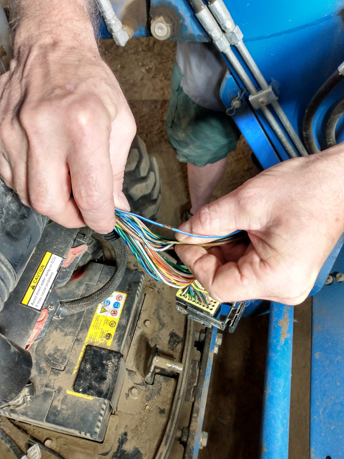

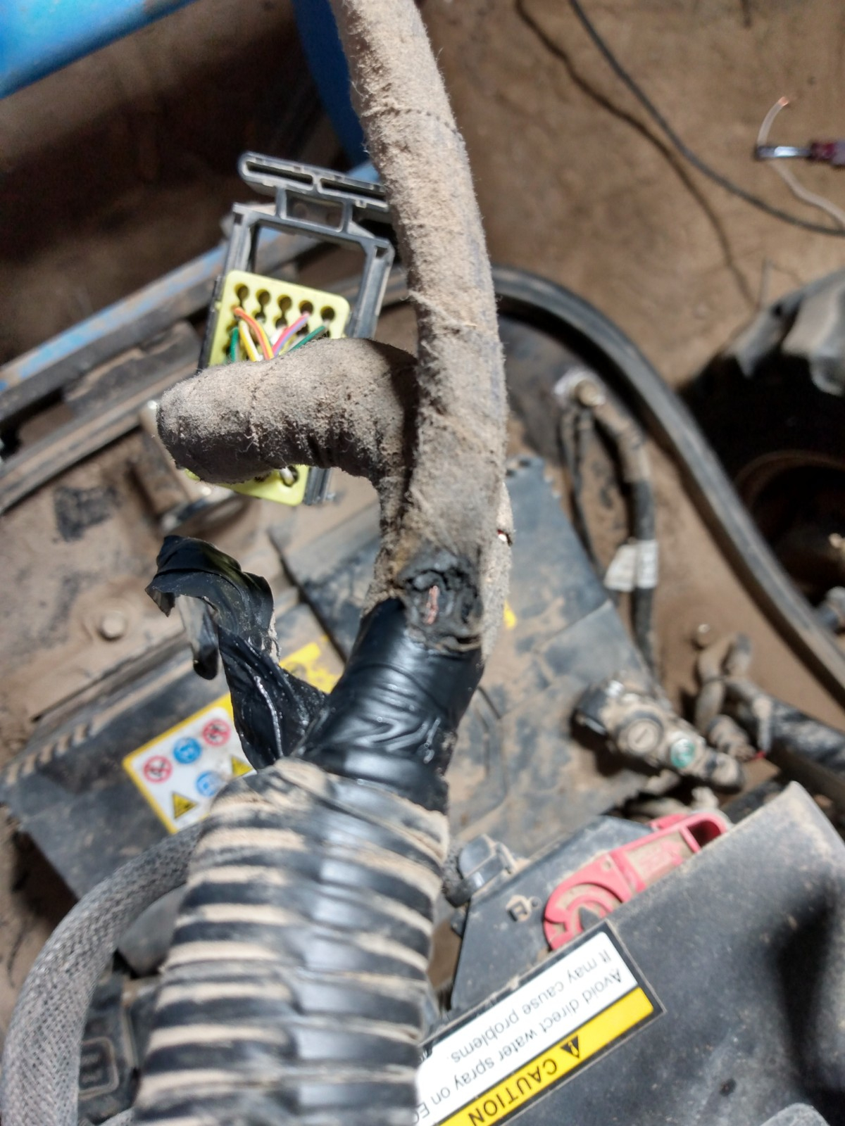

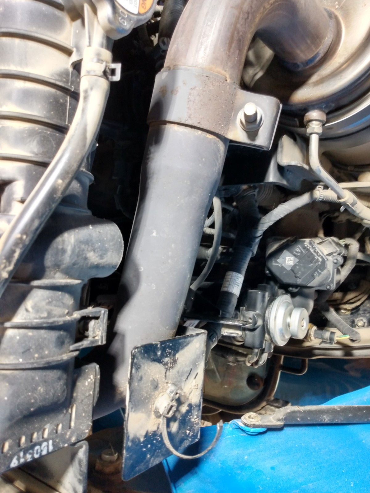

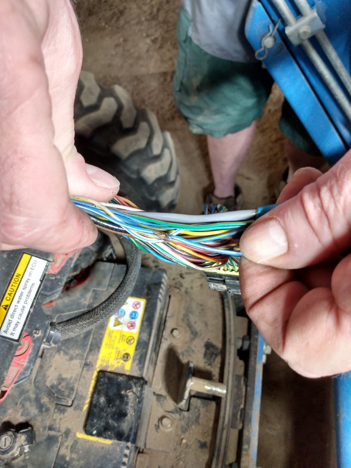

MAF sensor was OK. I finally got hold of a service manual. I see now why dealers don't want you to have them. It makes the tractor too easy to diagnose.
Traced the power wire from the MAF sensor back to the ECU, then back towards the fuse box under dash. There is a plate attached to the exhaust, that the wires are attached to. The problem is the plate has an edge and the wires are routed over the edge (poor design). So, of course, the wires rub on the edge while the tractor moves. Took 6 years, but the wires finally rubbed bare and caused the short. You can see it in the first pic (which is turned sideways).

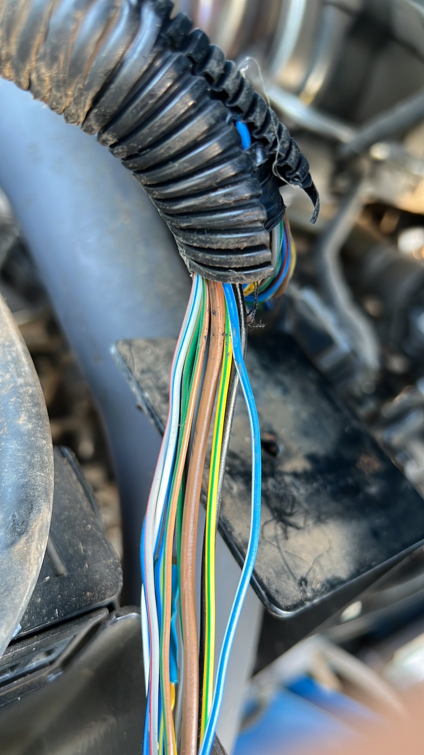

Thank you so much. I had this exact problem and you saved me so much time and money. I've attached photos that show the same issue. The blue wire is frayed by the smallest amount so you'll have to zoom in. 10 Amp fuse blown as well.
I spent 1200 dollars on fuel rail, sensors, MAF sensor, other sensors and still nothing. Finally found a fuse blown that I replace early on and then found this after googling sensor fuse blowing! Same wires grounded out. Works perfect after fixing!
